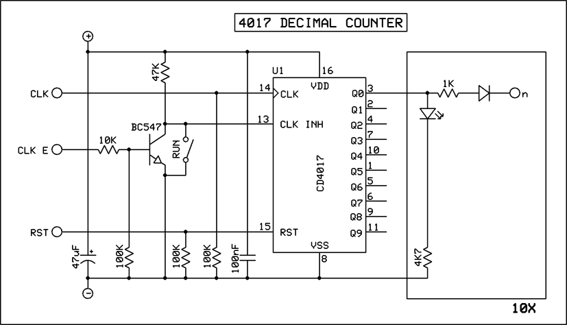

next:
4017 DECIMAL COUNTER
Don't think I need to mention anything about this one, except for using the CLK INH pin to hold/run the counter,
either with a switch or remotely.
 Filesize:  18.57 KB
 Viewed:  1231 Time(s)
 Filesize:  48.05 KB
 Viewed:  1101 Time(s)

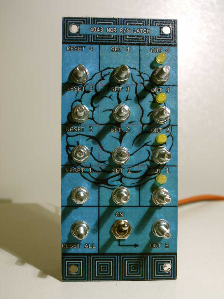

PostPosted: Sat Dec 08, 2012 6:39 pm    Post subject: PHOBoS' Modular Lunetta`
Subject description: [4043 NOR R/S LATCH] Module
and the last of the 3:
4043 NOR R/S LATCH
It's Alive!, ALIVE!
well ok it's not really alive (yet) but it can remember some bits now. I also added an extra input for a total memory
wipe, and a switch so it can sleep sleeping but still remember the bits when it wakes up.
 Filesize:  26.03 KB
 Viewed:  1165 Time(s)
 Filesize:  63.23 KB
 Viewed:  1046 Time(s)

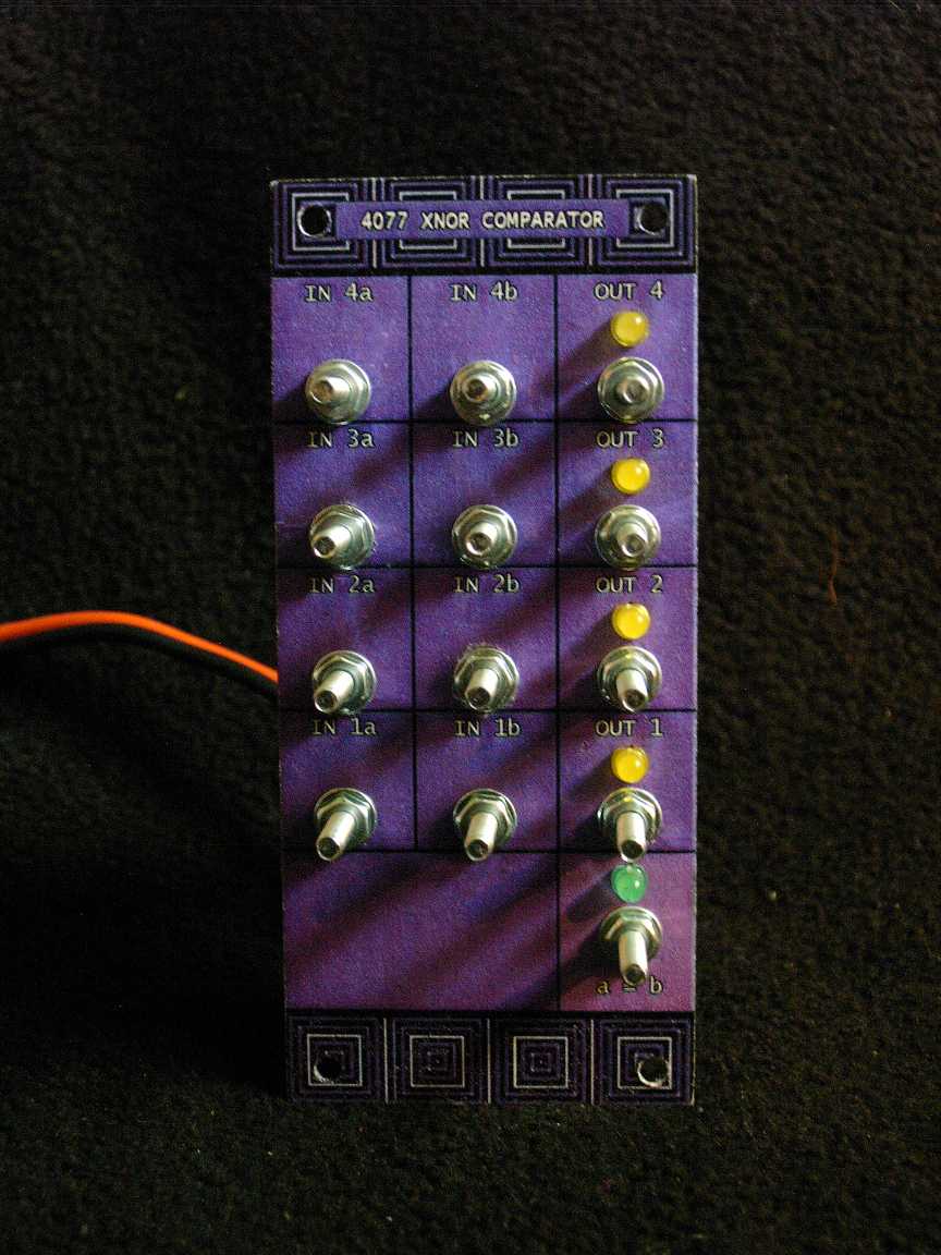

PostPosted: Sat May 03, 2014 4:39 am    Post subject: Reply with quote  Mark this post and the followings unread
...I would add some XOR's to that..... I went for a CD4029 instead
if you use a XNOR (4077) instead of the XOR(4077) and 4 diodes in wired-AND style you could probably us it as a logic comparator to generate a preset pulse. So you have 2 4bit inputs that define start & end value of the counter, right ? if this works, let us know. Smile
I use 4516 instead of 4029, because it has an extra reset pin.
have a nice solder weekend, u~
Posts: 5673
Audio files: 706
PostPosted: Sat May 03, 2014 5:50 am    Post subject: Reply with quote  Mark this post and the followings unread
scratch Shocked
yep I think that works. If you make two of those comparator circuits (I like them already) connected to a flipflop controlling the up/down pin you
should be able to make it bounce between 2 set points. I'll do some tests.
Wasn't familiar with that one, but just looked it up and it's actually a nicer version of the 4029. I don't really care for the DEC/BIN option and would
rather have a reset pin instead which is exactly what the 4516 has. Thanks for mentioning it Very Happy

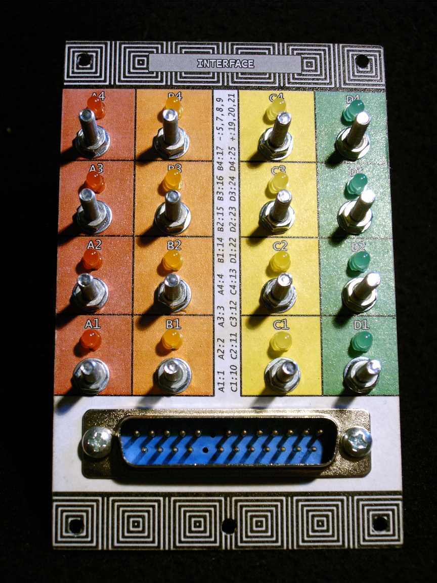

PostPosted: Wed May 07, 2014 5:21 am    Post subject: modular lunetta interface module
Subject description: 16 in/outs
I made an interface module. I was originally thinking of adding 8 inputs with pulldow resistors and 8 outputs with LED's. But I might want to use it for
midicontrol to it in which case it would be nice to have 16 outputs. So I added pulldown resistors and a LEDs to every connection. As LED drivers I used
the ULN2804, which is a bit overkill but has a very practical pinlayout and 8 buffers so I only needed 2 chips.
The interface connector is a 25p sub-D connector with 2 pins removed so I can also plug in a 9p connector (8 in/out & -). The 25p connector has 3 pins
connected to + and 4 to -. One thing I'll probably make for it is a box with 16 1/4" connectors, 8 inputs with comparators and 8 buffered outputs.
edit: just found out that the extra mounting hole I added at the bottom doesn't line up with any of the holes in the mounting strip doh.
I could 'fix' it by hacking a piece of the strip and using 2 seperate nuts instead but I'll have to unscrew all the modules and remove the side from
the case to do that. And I first have to locate those nuts (if I have any left). It seems to be strong enough with out it so I could glue in a fake
screw instead (don't tell anybody).
Modular Lunetta Interface module
 Filesize:  115.82 KB
 Viewed:  607 Time(s)
 Filesize:  127.33 KB
 Viewed:  643 Time(s)
 Filesize:  141.93 KB
 Viewed:  617 Time(s)

Phobos, can you explan why you using the Diodes at the outputs of the shiftregisters and the counters. I use the diodes only at the input of the r2r ladders. I have some (odler) modules (like drumish sounds) that dont work with just a Voltage in, they need a change from low to high. Is this a pulldown resistor issue? (i dont have my hands a long time on this circuits..... i just patch them....)
Posts: 5673
Audio files: 706
PostPosted: Wed May 07, 2014 11:22 am    Post subject: Reply with quote  Mark this post and the followings unread
I use the diodes on outputs so I can connect multiple signals to one input (it'll form an OR gate), so far I haven't really made a lot of use of that though.
And it can actually be a bit annoying sometimes when trying to connect it to something else, because you have to add a pulldown resistor. But the
interface module can take care of that. Cool

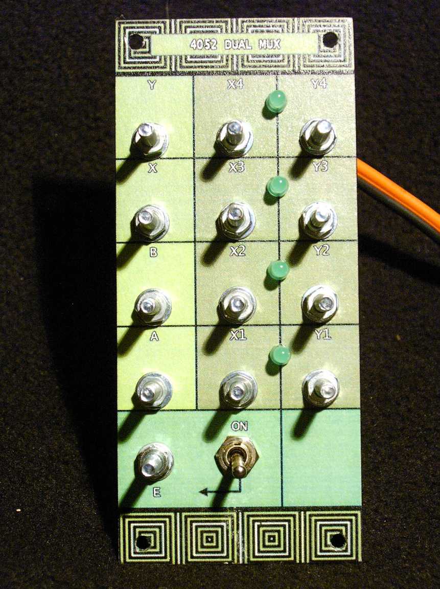

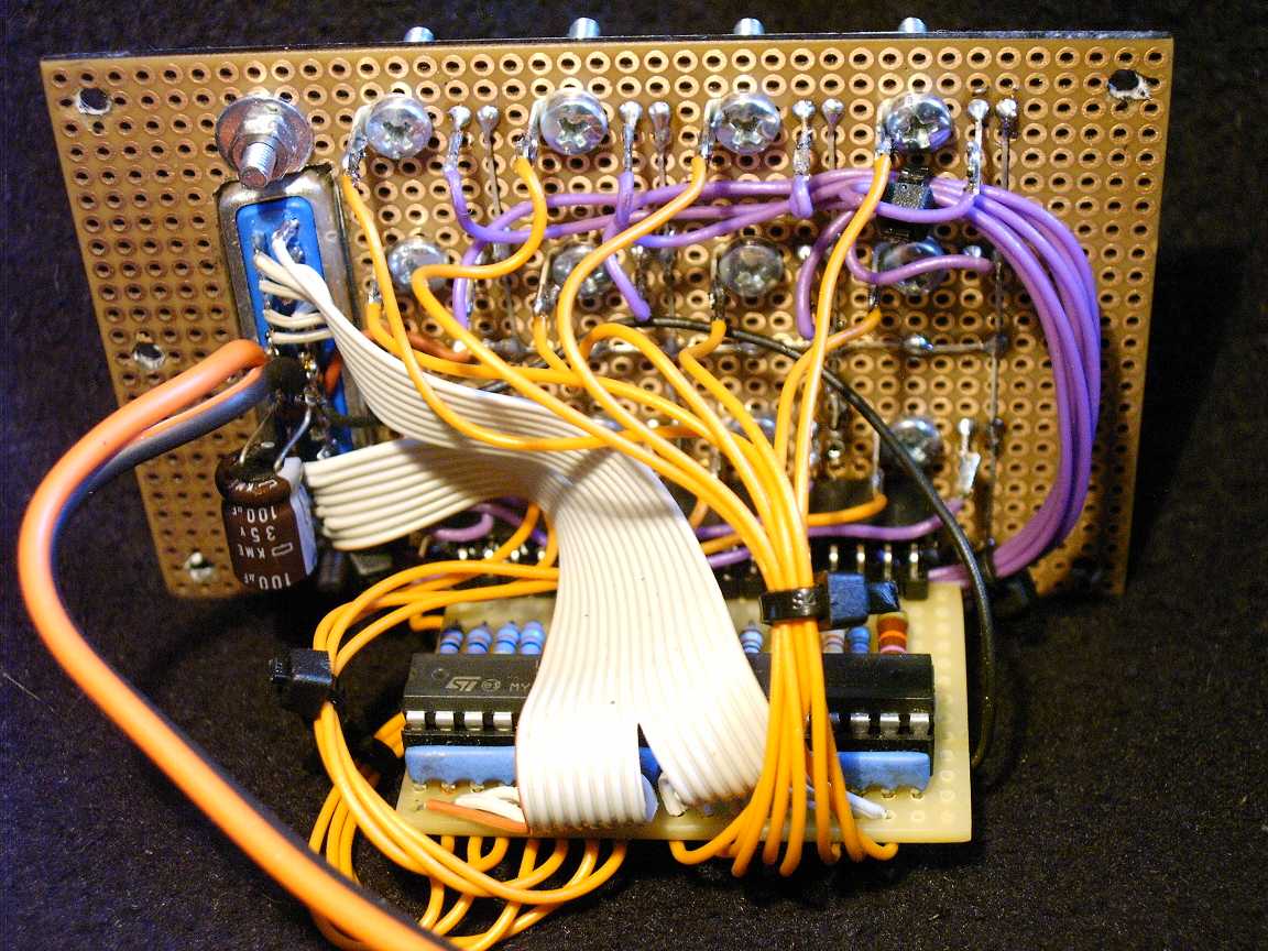

PostPosted: Sat May 10, 2014 4:38 pm    Post subject: Modular lunetta dual mux module
Subject description: CD4052
And another one finished, a 4052 dual mux. I added another mux that is just used as a bin2dec decoder to control the LED's. Since this is the same for
both halves (X,Y) I only used 4 LED's and mounted them between the X,Y in/outs.
Modular Lunetta 4052 Dual Mux module
 Filesize:  120.35 KB
 Viewed:  670 Time(s)
 Filesize:  130.58 KB
 Viewed:  637 Time(s)

PostPosted: Mon Jun 23, 2014 4:14 am    Post subject: modular lunetta XNOR Comparator module
Subject description: 4 bit
I have room for 3 more modules, 2 regular sized and 1 larger one the same size as the interface. I want to use the large one for a mixer so that
leaves me with 2 modules left. Some extra inverters are useful and some XOR gates aswell and if you make one input of an XOR high it functions
just like an inverter. But because I have diodes on all the outputs I can't use pullup resistors (the input would never go low). I could use a
patchcable though to make one input high if I want to use an XOR as an inverter.
But instead I choose to use XNOR gates, these work as an inverter when one input is low instead of high. And can be used like an XOR be it that
the output is inverted (I can invert it with a second XNOR gate to get a regular XOR). I also added diodes and a pullup resistor, buffered by a
transistor, as suggested by elektrouwe so the module also functions as a 4 bit digital comparator. Very Happy
Modular Lunetta - 4077 XNOR Comparator module
 Filesize:  95.38 KB
 Viewed:  637 Time(s)
 Filesize:  114.47 KB
 Viewed:  605 Time(s)
