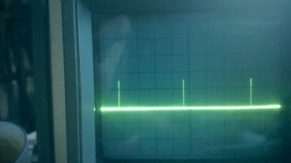

Hi I am still confused , surely it should be sequencing automatically. The scope images support this, U3b is outputting a signal confirming that the clock is working. I don't get why the signal is weaker at the cathode of D18.
I had the clock rate set at 9 when I took the above scope images.

| How are you measuring? A meter will not see the very short pulse. Look at it in the scope and find the peak. |
Cato
Joined: May 29, 2014 Posts: 44 Location: uk
Posted: Mon Jun 23, 2014 11:05 pm Post subject:
Using scope the gate Q11 is showing short strong pulse, D18 cathode is showing same pulse but weaker or not as bright.
The source of Q11 shows the same waveform as U3 pin 1. D18 anode shows the same pulse as U3 pin7. The clock in of U1, pin 14, shows no pulse or voltage. |

Starting to sound to me like the problem is around U3b. You will need to use a scope - the pulse output from pin 7 - going from -12 to +12V is too short to show up on a meter. You don't necessarily need 12V to clock the 4017, but they do need a decent voltage relative to the power supply, so if or some reason you were only getting say less than 4V out of U3b, it wouldn't trigger.
Your earlier scope shots suggest there is a pulse coming out of U3b, but without knowing the scale it's difficult to say more. IF the images of scope shots of U3b and D18 cathode are to the same scale, then it looks as if you might only be getting 1v or so, which after the diode drop won't be nearly enough to trigger the 4017. It will though be enough to pull the gate of Q11 up, allowing the clock oscillator to work, which is what you report.
I'd suggest checking component values around U3b, and scope shots of the voltages on pins 5, 6 and 7.

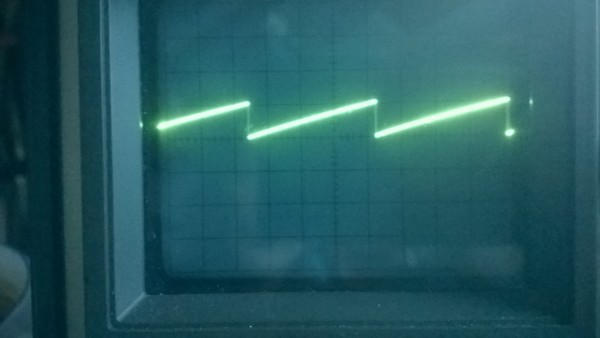

I have some scope images, still new to using the scope!
I have set the horizontal to centre line by using scopes ground setting then I switched to scopes DC setting. The volts/Div was set at 0.5. The probe was set at 1x10. My bench power supply is set at 12v drawing 0.004 amps when I press start on sequencer, the clock rate was set to 10. I then took the images.

The probe will have a 1x or a 10x setting. I'm not sure which you used, but I'm guessing 10x? 1x10 doesn't really clarify that
If you're using 10x then your volts/div are multiplied by 10, so .5V x 10 = 5V, and those spikes coming out of U3B are strange in that they don't appear to be going -12V to +12V per Ray's description, more like -5 to 2.5. It's also strange that the integrator is only going 0 to +5V.
if I didn't know any better I'd say this looks like you are using a 5V supply not a 12V supply. Are you sure you have 12V / -12V at the power pins of U3? |

Scope is 10x setting.
Measured, using scope, pin 4 0f U3 showing -5.5v and pin 8 +6.5v.
However using meter I got -12v on pin 4 and +12v on pin 8.
Used meter to check output of bench supply and confirmed +/-12v.
used meter on power supply inputs on pcb and confirmed same result.
Used meter on all power pins for all ic's again got correct readings for all.
Using scope for the above I get -5.5v/+6.5v readings??? I was expecting the same results as the meter.

Sounds to me like there is some problem with the scope set up.
Unfortunately I'm far from an expert there, so I have no good advice. |
Cato
Posted: Sun Jun 29, 2014 11:25 am Post subject:
| Just checked scope manual I had the volt/div fine tune red, inner dial, set wrong, so it is now all the way clockwise. Now getting correct scope readings, so readings in previous scope image set should be doubled. I am going to recheck all of them. |
