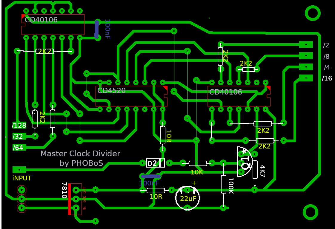

..guess i should tie unused inputs from the second CD40106 to ground ? i made some PCB layout for it yesterday then i thought what to do with half 40106
Posts: 5673
Audio files: 706
PostPosted: Sun May 05, 2019 3:30 am    Post subject: Reply with quote  Mark this post and the followings unread
Yes you are correct, although it doesn't necessarily have to be GND.
You could also use V+ or any digital output signal. Sometimes that can be easier to route when designing a PCB.
vladosh
Joined: Aug 02, 2010
Posts: 659
Location: macedonia
Audio files: 46
PostPosted: Sun May 05, 2019 3:35 am    Post subject: Reply with quote  Mark this post and the followings unread
i guess it would been easier with +V ,i drew it to run on 10V ,added a regulator on the input ,and 2K2 resistors at the outputs ,the manual reset button can be very useful with big divides but like this it's just 8 banana jacks so it fits well in 4U ,if you want i can remove the PCB layout

Posts: 5673
Audio files: 706
PostPosted: Wed May 08, 2019 2:36 pm    Post subject: Reply with quote  Mark this post and the followings unread
The power routing is a bit weird but it will probably work fine.
PostPosted: Wed May 08, 2019 9:18 pm    Post subject: Reply with quote  Mark this post and the followings unread
Possibly a silly question, but what is the 7810 voltage regulator doing?
vladosh
Posts: 659
Location: macedonia
Audio files: 46
PostPosted: Wed May 08, 2019 11:39 pm    Post subject: Reply with quote  Mark this post and the followings unread
i guess it can do without ,PHOBoS said the output depends on the positive supply so i wanted to make the gates around 10V
