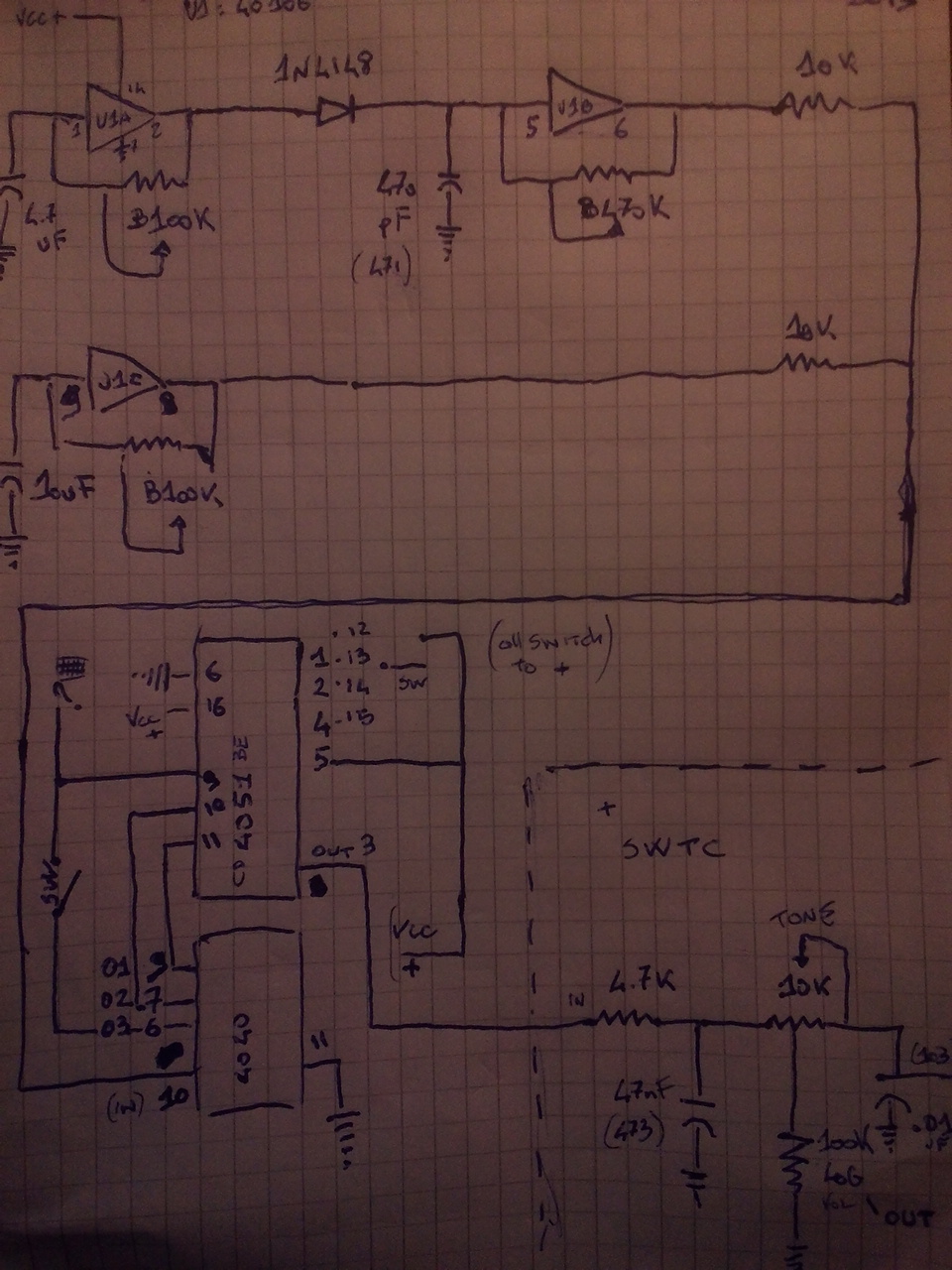

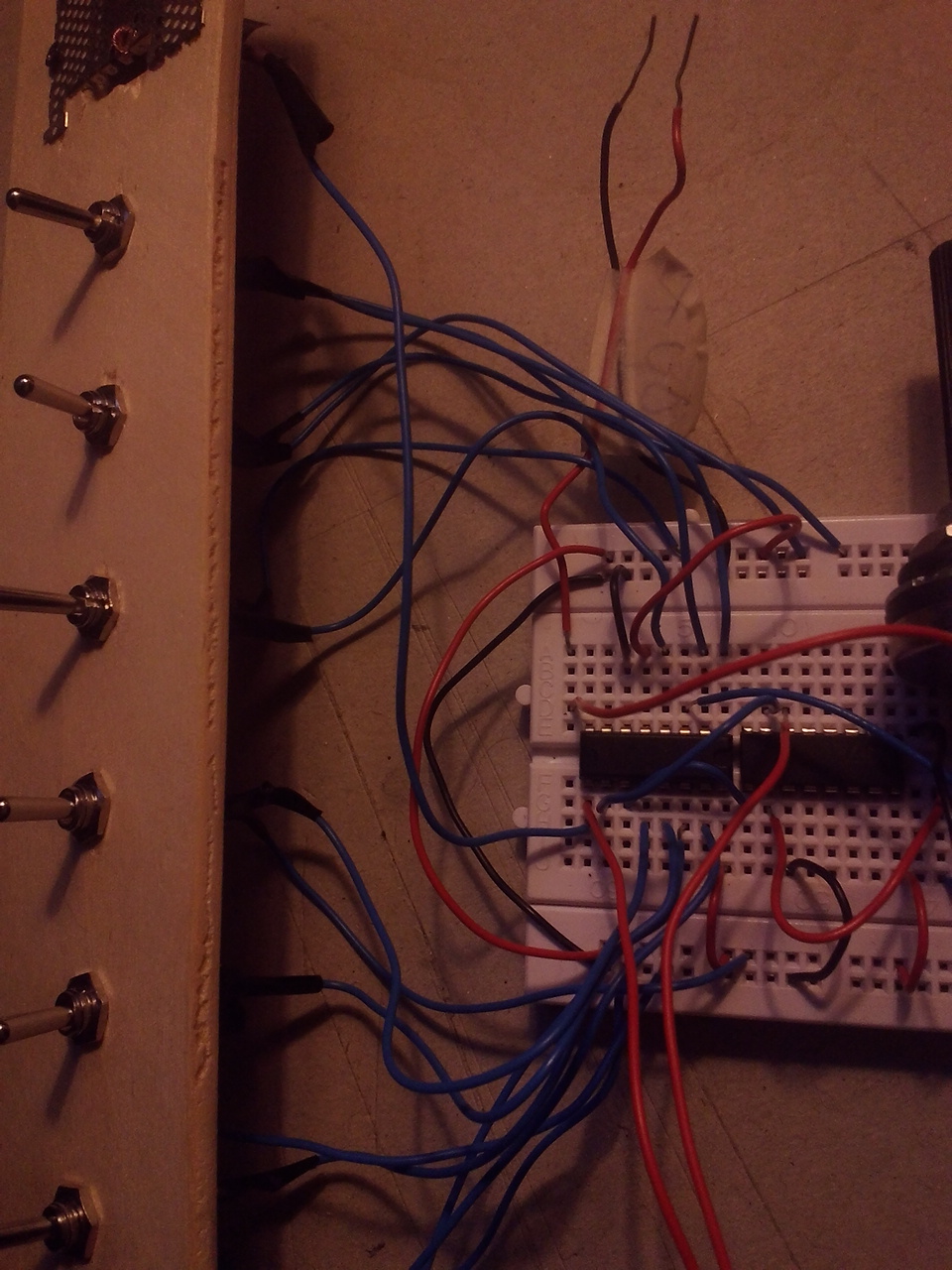

hallo all!
i start working on a modified version of the heterodyne peyote space explorer changing cap values, trying to work on low freq osc for playing with rythm patterns and i came across a new interesting noise rythm maker thing..(newbie luck)
the mod from original circuit is to use 3 x 40106 osc (1 dual osc with diode + 1 osc) mix output with resistor, send into a 4040 and 4051 (from beavis heterodyne peyote space explorer) and then a stupidly wonderful tone control for a simple passive lowpass filter for output.the switches on 4051 create different rythm patterns...
so the interesting thing is to have a switch on one connection between 4040 q3 and 4051 address pin C and to have this with the switch off connected to nothing or to a metal plate (?)
sorry if this is messy but i really dont' understand what is getting this noisy effect so i ask for some explanation (could be a short in the switch or on ic pin ?) and i want to share if someone find this of some interest. now i have everything on breadboard so some mod is still possible...
now power is with a 9v battery i want to ask if is ok to add a dc adapter power supply to play with different volt (changing freq (bpm) of osc) i want to use the metal plate like a touch control for changing the noisy sound..
(just to be sure that if there is some short is ok to play with touch and external power supply Rolling Eyes )
any suggestion is much appreciated.
thanks!
i attach a messy schematic, breadboard photo with switch detail and a short audio- (first with switch for address pin c off and then on)

Posting an enhanced image to give us a chance to comment on your circuit.
a floating (unconnected) pin of a CMOS chip is very sensitive and it can pick up any electromagnetic noise.
In this case when you're touching the plate you're modulating it with a 50Hz/60Hz since wave.
It's the same effect as when you would touch the end of an audiocable that's plugged into an amplifier.
it should be perfectly safe if you use a wallwart supply allthough a battery would be just a tad safer.
The only way it could go wrong is if the supply fails in such away that the primary and secondary windings
of the transformer get shorted without tripping a circuit breaker or the hole thing going up in smoke.
there is something else you have to be more careful with when using any touch connection though which is
connecting it to a computer (say you want to record the output). PC's usually have a mains filter which has
capacitors connected to the earth which is also connected to every GND connection. The problem with this is
that if it's not connected to a socket which has an earth connection every ground connection will be at half the
mains voltage. It should be low current though and not very dangerous but it can give you quite a tingle
and I wouldn't start licking it Wink although it's more lickely that you'll just destroy the chip than that anything
bad will happen. I'm not sure about laptops but judging by the grounding problems they can cause it might be similar.
and btw welcome party!

bipomuz wrote:
...4051...)
..pin 6 to GND is fine, but pin 7 & 8 also !
Posts: 5907
PostPosted: Sun Mar 29, 2015 11:37 am    Post subject: Re: peyote drum explorer
Subject description: 40106 - 4040 - 4051
elektrouwe wrote:
bipomuz wrote:
...4051...)
good catch, I only skimmed the schematic and I usually ignore power connections since they're not always drawn.

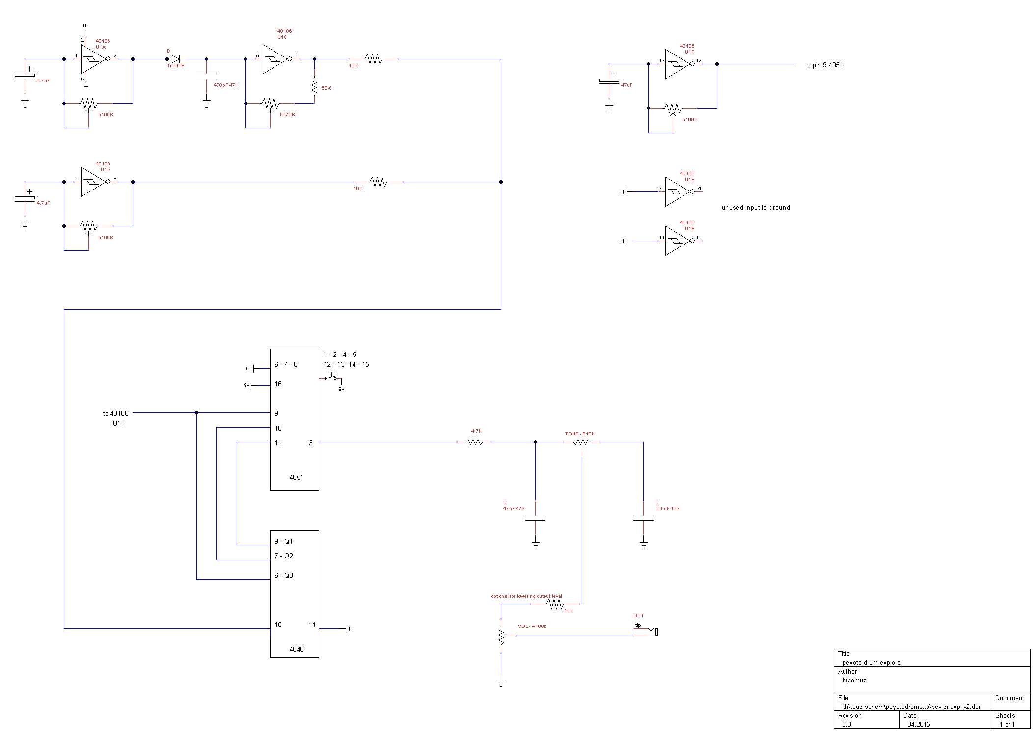

bipomuz
Joined: Mar 25, 2015
Posts: 4
Location: italy
PostPosted: Sun Mar 29, 2015 1:34 pm    Post subject: Re: peyote drum explorer
ok thank you all, i think i'll stay on the safer side, so i remove the floating connection to the plate (no touch control !) and i was wondering..a 50.60hz hum modulating it.. Idea i'm tryng to add a 40106 osc with bigger cap and connect the output to 4051.9 pin C and see what it sounds like..
when i find something that work for me i can post an updated and more readable schematic.
ground on 4051 added Wink
i'm connecting the box to a mixer for external efx and to record on laptop ( no touch control all is ok, right?) and i don't undestand what you mean if i connect this thing to something that has main power i need a output transformer..
i'm a new to a lot of things and i'm having fun building noisy boxes but i have a lot to learn about electricity Shocked

PEYOTE RITMO
