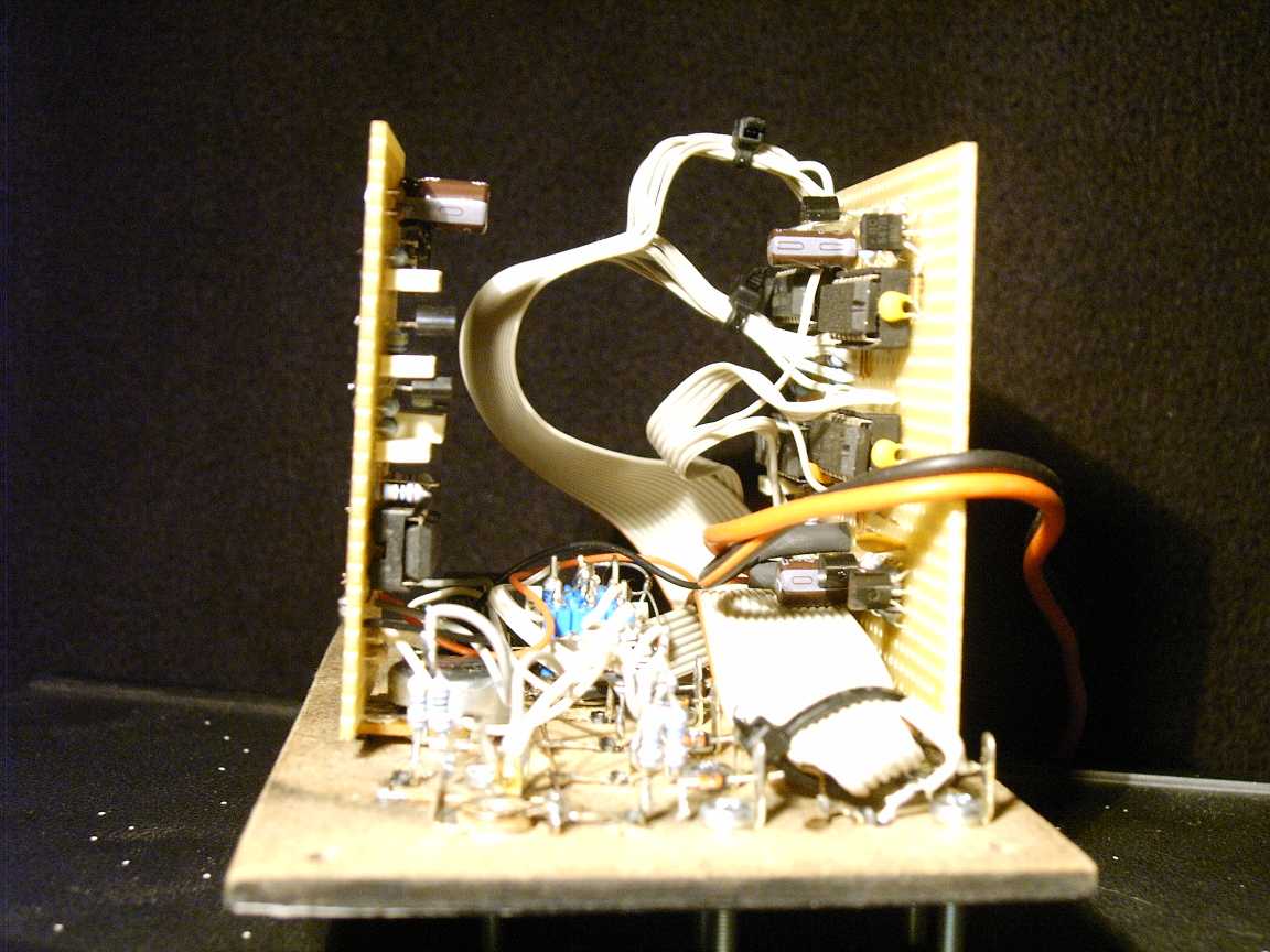

PostPosted: Thu Apr 23, 2015 1:39 pm    Post subject: Reply with quote  Mark this post and the followings unread
Finished this one Cool
(only needed the knobs and a 1/8" socket)

Posts: 5935
PostPosted: Sun May 10, 2015 7:48 am    Post subject: Reply with quote  Mark this post and the followings unread
thanks Very Happy
cbfishes wrote:
This looks awesome! I don't think I understand the ADC/8bit part, but I think I mostly get the noise creation and random clock. That's cool!
Any audio? Would love to hear what this sounds like
The ADC converts the noise generator (which is just a random voltage) into 8 bits. 0V results in 00000000,
5V in 11111111 (actually it's inverted) and of course you get every binary value in between. Because the
voltage is random the bits are random too. I could also connect an external voltage to it instead of the noise generator.
It's not a Flash ADC so it doesn't happen instantly but all the bits change when the CLK goes high,
so I can change the speeds of when the bits change. So it's like a S&H except that the output isn't
a voltage but an 8 bit binary value.
It doesn't really produce any audio, well I could turn the speed up which would result in 8 bits of digital noise.
But it's just a way to create 8 random bits which can be used to control something else.
