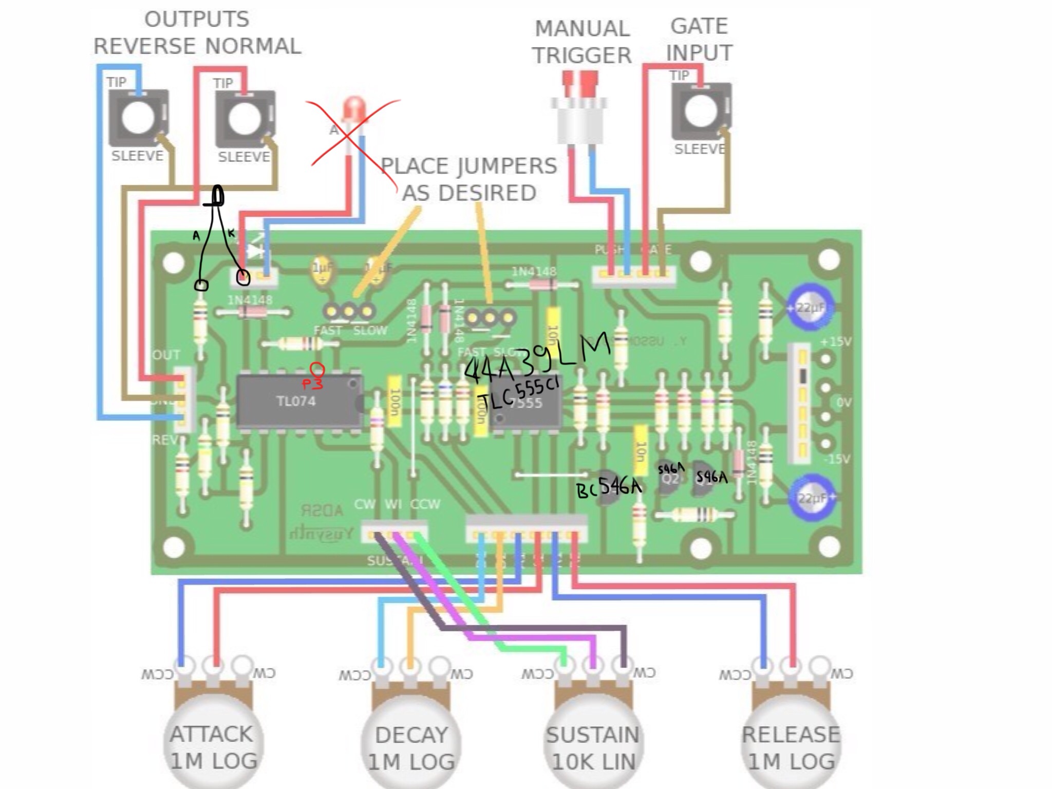

Ok. I bilt one adsr v2 with slow jumpers.
And bc546a instead of 547
But here is a strange thing:
Output works with background "non excluded audio signal" duno howto describe it precise. So there is a silence only before first trigger, after next trigger (no matter is it trigger input or switch) there is a background sound.
Thing is adsr works as it should work, if i connect output directly to tl074 pin3, then is silence between "actions" .
Can it be cos i use 546a? Or something wrong with 555?
Also led diode, dont work in expected place, diode works when i put it in different place, as it shown in drawing.
So somehow my adsr works great,also no problem with invert output at all, but i would like to complete project as it should be. When output goes from right place and led is connected to right place.
Any ideas?

If I remember correctly, the direction of the LED and D5 are reversed in the schematic and diagram. Try switching them around (LED cathode to pin 7, anode to pin 6, D5 anode to pin 7, cathode to pin 6).

wolaaaaa!!
Thank you very much!
Now my ADSR2 works as expected!!
