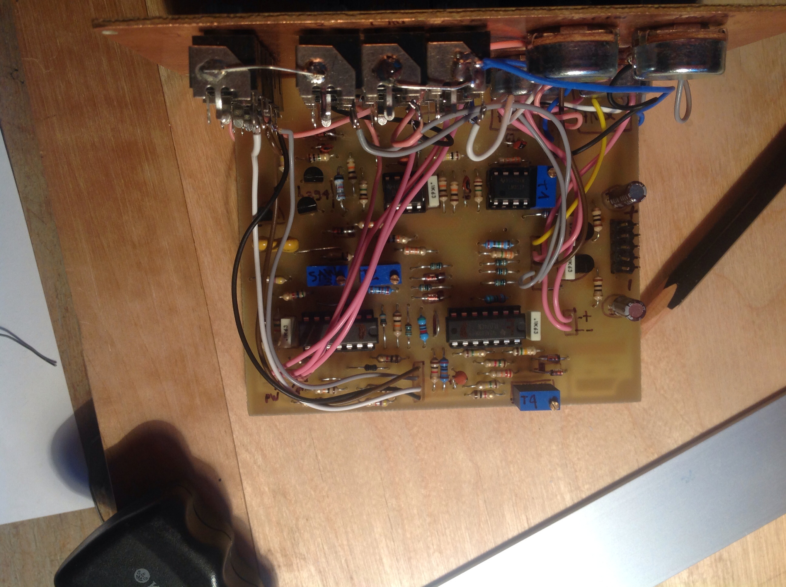

Post hi-res pics of both sides of your board. Sometimes people can spot mistakes. Most likely culprits are bad solder joints, shorts, open traces or misplaced components.
The part you're touching in your video is very sensitive, I don't think you can read anything into that.
The problem with leaving out some components is that some of the "unneeded" opamps share an IC with needed opamps. Leaving the inputs of those unused opamps unconnected can cause problems with the opamps that are in use. If you were redoing the circuit you could leave parts out but I wouldn't just leave parts off of this board without modifying it.
Have you gone through the calibration procedure? Do you have a scope? Normal debugging procedure after checking the obvious is to go step by step through the circuit measuring each point to narrow down the trouble spot. _________________ My synth build blog: http://gndsynth.blogspot.com/ |

Hallo. Help wanted.
Can someone explain from my measurements where should i need search mistake?
1.
Thing is module seams like zombie, so looks like dead but when i push finger to transistor bc547 area, there is noize .
In normal circumstances there is no voltage oscilation on output pins.
Video:
https://m.youtube.com/watch?v=Tmg6zQqkibg
2.
Voltage goes to every IC and OP as should, i wrote down measurements.
Build is based on 12v like here in forum someone explained witch parts should be changed.
3.
Also my question, do vco should work on 12v not as precise 1v/oct or it will be silent on 12v?

gdavis
Joined: Feb 27, 2013 Posts: 359 Location: San Diego
Posted: Thu Sep 03, 2015 2:58 pm Post subject:
| Karlisss wrote: | Hallo. Help wanted.
2.
Build is based on 12v like here in forum someone explained witch parts should be changed. |
Who's? There's more than one, are you referring to my post? Give a link.
| Karlisss wrote: |
3.
Also my question, do vco should work on 12v not as precise 1v/oct or it will be silent on 12v? |
Without any changes, I think you would get something, but the frequency and amplitude will be way off.
You said your build is based off of 12V, does that mean that all the +/-15V points you circled are measuring +/-12V?
I do see a some issues right off in the core.
The main problem is the +9.9V on U3b pin 7. This needs to be a small negative value. This indicates a potential problem around the expo converter - BC547's, R11, R12, R13, R15, R53 and D2 - causing U3b to be pinned to the positive rail. You may have a bad connection in there somewhere after all.
Check your transistor connections. Is that track from the transistor base to ground and R12 covered with solder actually making a reliable connection? I'm guessing that was to bridge a gap in the trace. I usually just add wire instead of trying to bridge it with solder alone as the solder often doesn't want to fill the gap and is brittle causing it to break easily resulting intermittent connection.
Check that the voltage at the point between R11 and R12 and the base of the transistor connected to that point is close to 0V.
Check that the emitters of both transistors are slightly negative.
Check the voltage on either side of R15.
Also make sure the input side of R16 is 0V.
Something is also wrong with pin 3 of U7a which should be close to 5V. If you're using a 12V supply instead of 15, the value of R49 and/or R50 need to be adjusted to give closer to 5V. Based on the 10V reading you indicated on the +Vcc for U3a, it sounds like you're still using 50k and 100k which is not correct for a 12V supply. And what is the "37.3k?" note? Are you trying to measure the value of the resistor in circuit? This won't work, you must remove at least one end of the resistor to measure it's value.
