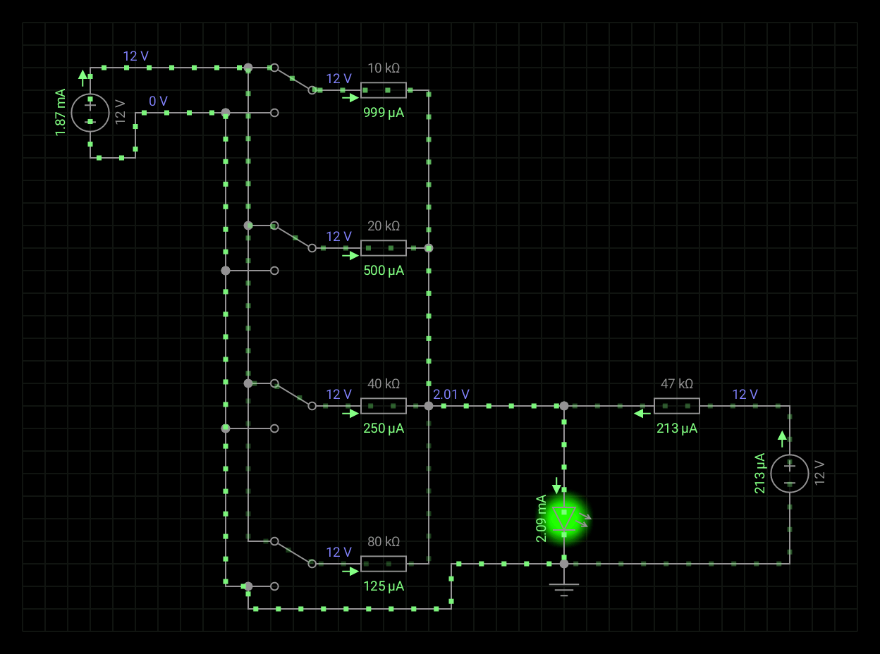

Another possibility is using a weighted resistor network. The idea is the most significant bit goes through the lowest value resistor, which we shall call R, then the next less significant bit goes to a resistor of 2R, then 4R, 8R, etc and theses are summed together usually at a virtual earth point of an opamp based inverting amplifier.
I tried this passive version on my Everycircuit simulator app & it appeared to work quite well, the switches represent the logic inputs ( I made them 0 & 12 Volts as that's what I usually use with CMOS circuits ) the 12 volt source and 47K resistor on the right provide a bias to overcome the forward voltage of the LED.
You would probably need to experiment with the values of the resistors to suite your specific vactrol as there is quite a large difference between different parts, same goes if you brew your own.
40K can be made with an 18K & a 22K in series, 80K can be made from 33K & 47K in series.
Here it is:

PostPosted: Tue Apr 18, 2017 7:59 am    Post subject: Reply with quote  Mark this post and the followings unread
Funnily enough I'd seen about those only a couple of days ago but couldn't remember the technical name.
I use a 9v clip or 5v from the Arduino.
