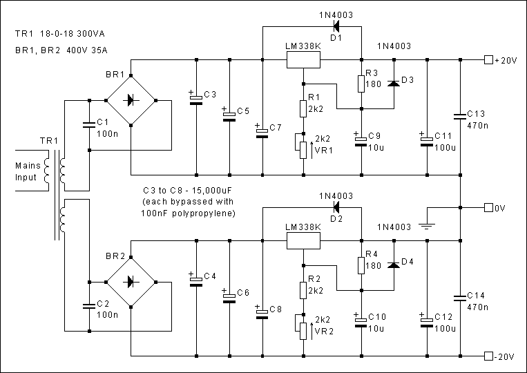

i was thinking of refreshing my substation power supply for the blue modular sometime and i was browsing some circuits to use with my 225VA dual secondary toroidal transformer one that caught my eye was this one using the oval shaped 5A LM338 regs , i have 2 supplies needed +/- 12V and +/- 15V , the biggest load , on my current supply just now is on the 12V side , drawing 2A on + / 1.6A on - .

Well, I guess I shouldn't have any concerns than Smile
I always like the look and feel of the TO-3 package, it's a bit more work to mount on a heatsink though.
btw. 3x 15000uF per rail is quite a lot, might cost you some fuses when turning it on and the light will
dim of course (in the whole neighbourhood). Do you have that knife switch installed yet ?
Since you already have a transformer I assume it is 2x18V which is good for the 15V output but a bit high for the 12V output.
So that's going to dissipate a lot in heat (as you already know). Useful to make a hotplate for a nice cup of tea but such a
waste of available transformer power and performance of regulators also goes down with heat. You should have more than
enough with 225VA though Shocked

I remember a discussion on SDIY about this. In the end, it works well enough for most applications (if not all). The discussion seemed to concentrate on the fact that when you use a negative regulator for the negative voltage, the regulator's ground connection is connected to the circuit's ground (and same with the positive regulator). When a positive regulator is used to make a negative voltage, it's output pin is connected to circuit ground and the ground pin connects to the negative voltage. It works because all the regulator cares about is the voltage at the output pin with respect to the chip's ground pin.
I've done this a couple of times with good results. I do prefer to use a negative regulator for negative supply, but that's more just because it "feels" better than anything empirical.

Thanks scott, good to have some more confirmation and yeah I just doesn't feel totally right eventhough it should work fine.

Yes i agree about the drop from 19V to 12V produces sausage sizzling heat with 1 set of regs ,been there Smile ,singe , tho my existing system like your existing system has the supply from the bridges go to several sets of regs doing their own bus bars, this also stopped the weird vco tune movement i had ages ago and stopped when the 6 vcos got their own regulators & busbar Smile .
Yes thats a lot of big caps in the circuit , this circuit could well have come from hiFi amp design area , not sure , for my set up 10000uF would suffice Smile
