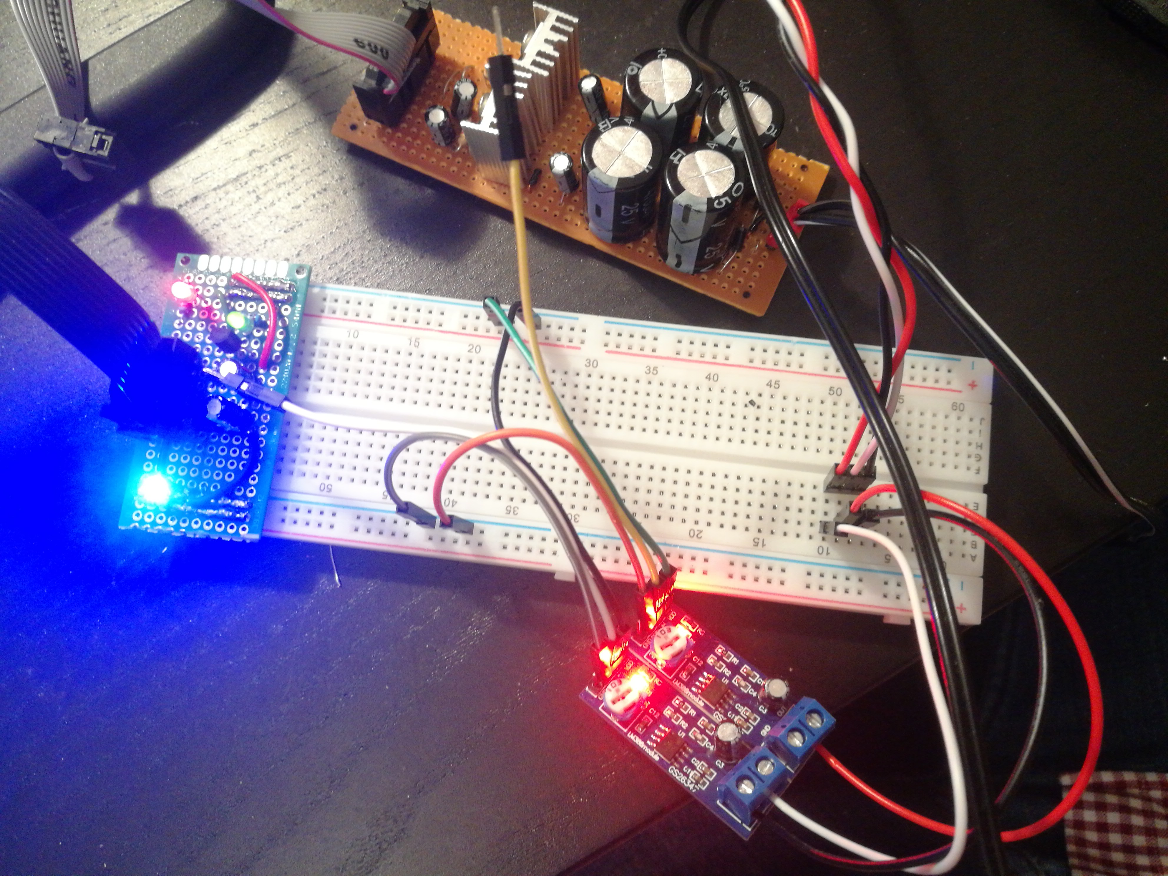

Second module I'm building is a simplified version of Ray Wilson's panning mixer. I've just taken two channels and stripped the entire FX bus. That leaves me with just 4 TL07 opamps and two 386n-4's so I figured I would just use a TL074CN as opposed to using 4 TL071's as schematic says. So first question, is this a bad idea in any way? Leakage?
Second question, is there something that I'm missing in believing I could just strip it to use only the circled parts here in the schematic:
After breadboarding it half decently I built it on a breadboard-like proto board and I'm currently debugging it. Seems like first stage buffers are fine but something weird happens with the signal at the pan stage (pans seems to not work correctly)
I've checked everything I can think of offline with a digital meter and I'm currently debugging with a cheap scope hooked up, but I'm really out of ideas what to check for.
Any pointers are highly appreciated, like a standard checklist to go through or anything…
…while writing this, I was gonna do list of my observations and doing that I found that there's most likely just something wrong with the pan pots and I had turned the panel wiring for the main phones level the wrong way.
Ok, having fixed the phones level I now just have to fix the pan's. I guess I have a little bit of distortion due to that, signal's being too strong since the grounding via pan wiper is gone, but my biggest concern is a white noise bright hizzing I have in the phones that is entirely unrelated to the turn of any pots, both input gain and also master headphone level.
I would think that this is coming from the LM386's and since the main volume pot is actually only doing something with the input signal to these power amplifiers this is probably something I'll have to live with? If I want true quietness on volume 0, then I'd have to have the pot attenuate after the last power amp too, right?

I've googled a bit and tried adding a 10k resistor and a cap in series over output pin 5 and gain pin 8 or 1. Like here https://dmohankumar.wordpress.com/2015/03/15/reducing-hiss-in-lm-386-amplifier-design-note-12/#more-10895
This removes the hizz but replaces it with an even more pronounced humming. I think this method probably isn't applicable unless the gain pins are used, but the MFOS one leave them floating to use the internal 20 gain factor I think. I'll revisit the data sheet
Posts: 5673
Audio files: 706
PostPosted: Fri Sep 29, 2017 7:54 am    Post subject: Reply with quote  Mark this post and the followings unread
Adding components between pin 1 & 8 increases the gain so yeah you're better of to leave them floating. You can indeed use it
for filtering and I don't think you would need to use the gain pins for it, but I'd have to check the internal structure of the chip.
What might help with the hum is adding a large capacitor (100uf or something like that) directly over the power pins, I am actually
a bit surprised it only uses 0.1uF in the schematic. Of course a regulated powersupply is also very important. I've had circuits that
work fine with a simple unregulated wallwart but others produce a lot of hum without any regulation. Personally I am not a big fan
of the LM386 especially not when used for an headphone amp. They are ok for adding a small speaker to a circuit or if you need to
boost a signal for processing that isn't audible.

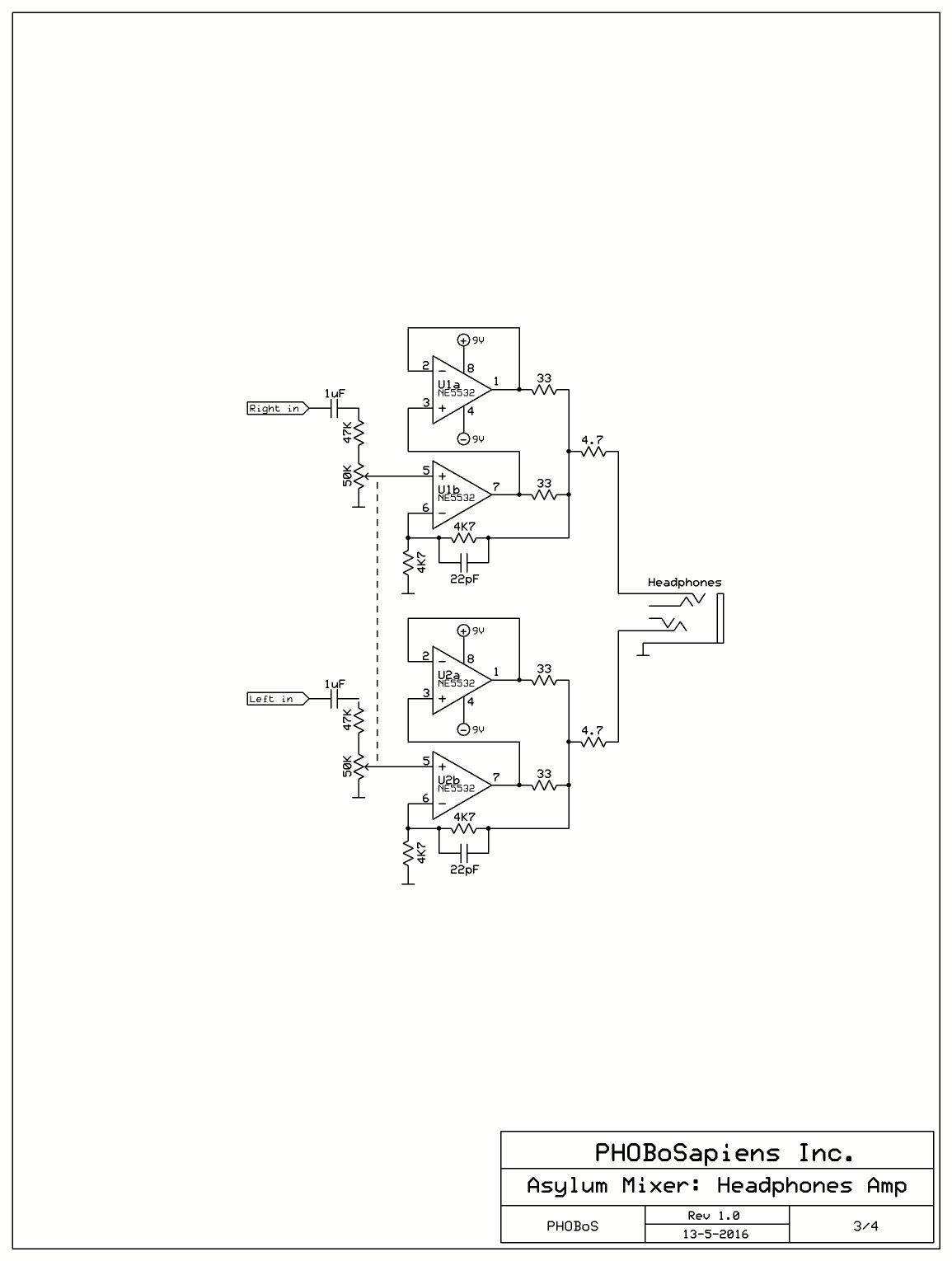

Although it is not a poweramp, the NE5532 works really well.
PostPosted: Fri Sep 29, 2017 1:40 pm    Post subject: Reply with quote  Mark this post and the followings unread
Another option is the headphone driver in the Yusynth Output Module -- works very well. Mind the 1/2W resistors, though, where indicated.

PostPosted: Mon Oct 02, 2017 3:36 am    Post subject: Reply with quote  Mark this post and the followings unread
Thanks for all the tips!
I think for this module, I'm stuck with my choice and have tried all "band aid" things I've found:
1) Doing the feedback from output to gain:
1.1) If no connection between 1 and 8 and connecting the feedback cap+resistor to pin 8 I get a maxed out beep, maybe 5000Hz that almost killed my ears a few times.
1.2) Connecting to pin 1 I instead get a hum that is more pronounced than the original hizz.
2) No decoupling caps seem to make any difference at all for this hiss - it doesn't seem to be related to power flucts.
3) Modding my circuit to actually use something like a 1k + 10mF series between pin 1 and 8 I CAN connect the feedback from output to pin 8 as suggested in places like here https://dmohankumar.wordpress.com/2015/03/15/reducing-hiss-in-lm-386-amplifier-design-note-12/#more-10895
Again though, that gives me a humming that is simply worse than original hizz.
I think I'm out of options. I have only one batch of lm386-n4's that I bought from aliexpress and I'm thinking maybe they're a bit defective or something. I have tried a few. I have a few standar lm386 (lower voltage ones) on the way and I'll try those to compare but for now I'll have to live with the hizz.

PostPosted: Mon Oct 30, 2017 12:50 am    Post subject: Reply with quote  Mark this post and the followings unread
Just an update. I got a a couple of breakoutboards with LM386's in the mail the other day so wanted to compare the noise levels. I got the same noise from just powering up and connecting my earphones. Tried different PSU's too. So I've reached the conclusion (that you guys already told me Smile ) that LM386 simply isn't a good fit for an earphone amp (at least not at these supply voltages).
In loving memory, I trusted you Ray! Smile
Seems to me that one really would need to attenuate the output of these amps too if one is to use them like this. The hiss isn't related to the input levels, but a constant even if input is grounded.

PostPosted: Wed Nov 01, 2017 6:47 am    Post subject: Reply with quote  Mark this post and the followings unread
@PHOBoS,
I've breadboarded up your NE5532 schematic and it's dead quiet with grounded input! Yey! A different league than the LM386 one.
However, it dists pretty shortly if I turn up the inputs. I'm not sure about the levels it expects and what to look for here.
So Here come some noob questions:
My intention is to actually replace the headphone amp of the MFOS mixer I already built. It has a line output part which is then also fed into the headphone circuit.
Currently I'm just breadboarding and use a signal straight from an 12V oscillator and attenuate it down on the breadboard.
So it seems to start disting when input on pin5 exceeds 1.5V PP. It's still not very loud in the headphones though…? Cheap in-ear plugs. Is this to be expected?
I was wondering about the values near the output, 22 and 4.7 ohms seems very little?

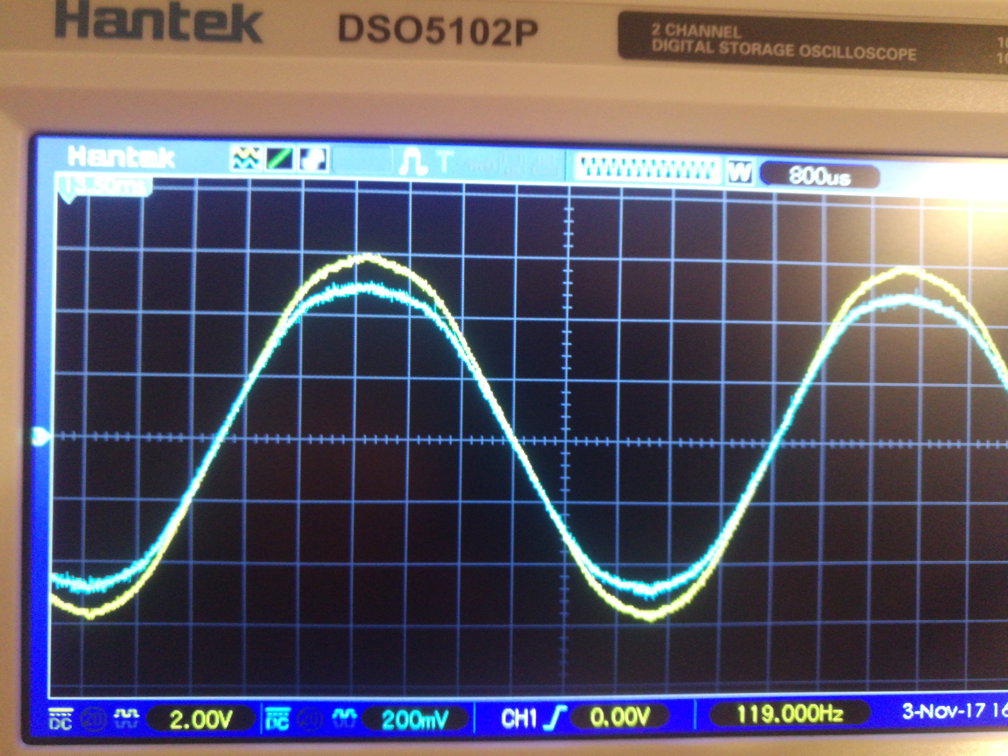

PostPosted: Fri Nov 03, 2017 1:02 am    Post subject: Reply with quote  Mark this post and the followings unread
One more update:
Got the scope running and it's not actually clipping it's just very noisy. Yellow is input and blue output.
It's also a bit offset towards positive rail

PostPosted: Fri Nov 03, 2017 2:15 am    Post subject: Reply with quote  Mark this post and the followings unread
Hm, I isolated one channel now and wiggled stuff around or something and now the scope shows a pretty clean sinus curve here, but it still sounds very bad in the earphones. Don't understand…
The blue is the output straight to the earphones, it looks good even with the earphones connected but it sounds really bad.

PostPosted: Tue Mar 20, 2018 5:23 am    Post subject: Reply with quote  Mark this post and the followings unread
Just an update:
Tried this earphone output with my old Beyer Dynamic DT-100 which is at 400 ohm. Sounds waaay better and the noise is hardly audible. I would just want to state the to some probably obvious. The LM358 is waaay to noisy for low impedance earphones, but on this one it seems like a perfect match. I have tried to use these earphones in more traditional equipment before and they sound really bad there. I guess they need a lot of power and therefore also cover up a lot of weak noise.
