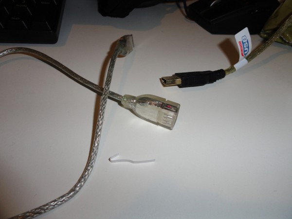

Of course, here I go.
I've uploaded some pictures with descriptions. I've also attached an audio file with the recording of my G2 using the regular cable, and then the extension with the paper. I suppose most people don't notice the noise but keep in mind that I use headphones almost always and that way is very noticeable. Moreover, once you record the audio into a DAW and start compressing the buzziness gets really loud.
The record is just the G2 straight into my Fireface 800, without any other synth turned on.
Please keep in mind that I really don't know why it works. I thought it could work and tried disabling pins until it worked. Wink
You need the cable from the G2 to the PC, an USB extension cable, and a tiny bit of paper (probably thin plastic would be better).

You have to put the paper exactly as it is shown in the picture.

Now I know why it works. I'm disabling the +5 current pin, which is the one that carries the ground loop noise and it's not needed since the G2 has its own power source. I'm planning to disable every +5 USB pin not needed in my cables (ie. other synthesizers or devices that have their own power source).
Moreover, and I think this is very important: I know that the G2 does not need the +5v USB input pin (it's only used to provide power to some USB devices like mouses, keyboards, controllers, etc), but someway the pin IS connected to the synth board because the effects on the audio signal are very noticeable.
This leads me to think it shouldn't be that way. It may well cause the USB port to break if connected and disconnected very often, or if the computer sends a unusual voltage spike trough the +5v pin. You know there are many posts about broken USB ports in the forum.
What do you think about this?

Thanks for great post with all those pictures. Looks like a pretty easy trick to pull off.
Yes I think you're right. If the 5V is not needed in the synthesizer, then it should not be connected to any circuit.
The audio file shows a significant improvement.

First, thanks a lot for this topic.
I have similar problems and tried the "paper in the USB connector" approach.
For some reason, removing the connection to the +5V connector would not produce any result.
However, removing the Ground connection stops the noise. Hurray ? Is it safe ?

I wouldn't recommend doing that now. There is a much better and safe alternative, and that is using an USB Isolator. I have had one for years now and my G2 has worked beautifully since then, without any noise in my audio chain.
It was expensive when I bought mine (more than 60€ if I recall correctly) but nowadays they are much cheaper. It worths every cent and I feel more safe now.
This is the one I have:
https://www.olimex.com/Products/USB-Modules/USB-ISO/
Hope it helps!

I agree with Albert, but at the same time removing the ground is probably safe.
I'm not sure how household power is in Europe, but in the USA it can be the source of ground loop nightmares. I learned this from a wise old sound tech many years ago when setting up a huge live preformance system called the Electric Symphony Orchestra. We set up about 40 individual instrument amplifiers on the stage and when we turned it on there was horrible hum.
This old-timer looked at what was set up and said something like, "What idiots, you connect all the grounds together? What do people think these days?" Then he took about 1/2 hour going around with a wire cutter and removed the grounding pin on every single piece of equipment on the stage. When the prower was turned back on there was no hum.
In my studio nothing is grounded and I've never had any hum except for inheritly noisy synths like my 48 year old Moog Modular.
Still, I have never convinced anyone else to even consider massive ground removal. So, use a USB isolator, which removes the ground and power connections anyhow.
