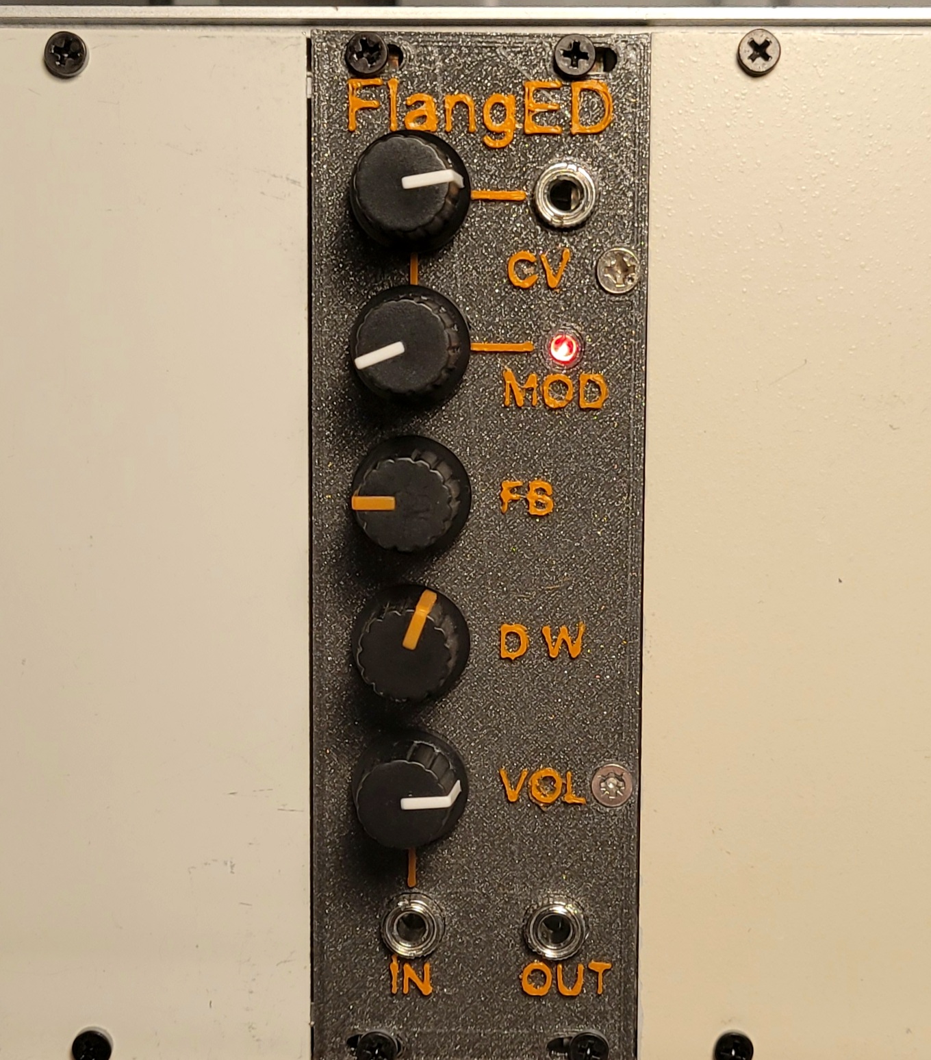

A Flanger with a twist: FlangED

Ah the new thread is up - happy new thread Exclamation
It'd flange with the proper modulation .. but .. what is the twist?
With the slow changes used in the demo it's like Karplus Strong Cool

The twist is that I use an attenuverter to control the feedback.

Is that a 3d printed panel? How well does that work?

Yes, it’s 3D printed and it is working really well,
First I start printing the panel and as soon as the printer starts to print the characters which are about 1.5 mm high, I pause the printer, change the filament to another color and resume printing. So you need to keep an eye on the printing progress.
I learned that 3mm thick panels is a good thickness but also that it needs more than one attachment screw for top and bottom fixture because else it would bend too much when plugs are pulled from the panel.

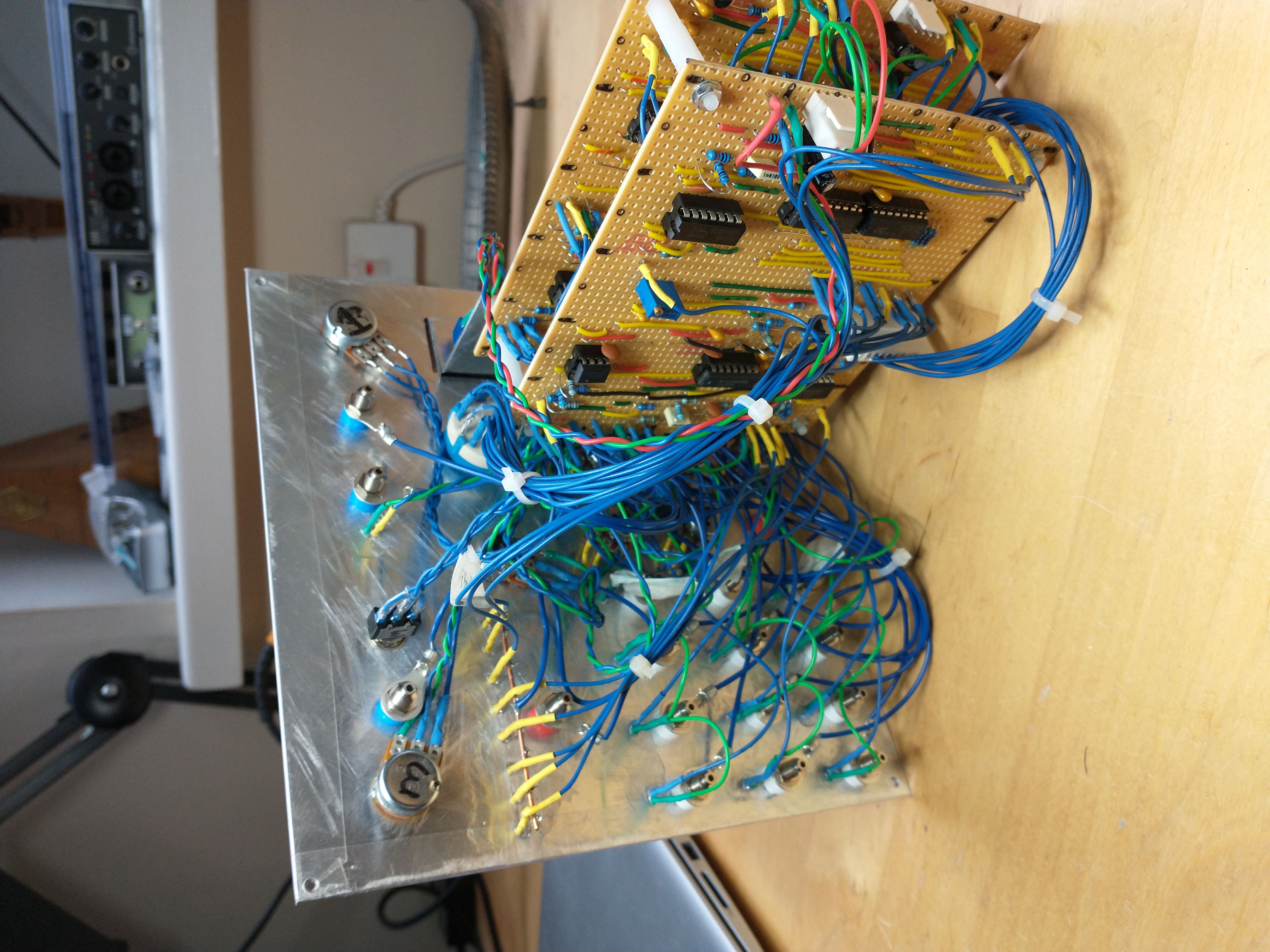

Turing Machine (MKII) with integrated Volts and Pulses expanders and a few mods.
Be interesting to compare this with the CGS Infinite Melody and the Klee.
(For some reason, the images have been rotated in posting...)
And the rat's nest

Nice Flanger and Lfo Grumble Smile
Handy new diy box Alan Smile
that looks great Pho Smile
Nice panel & turing machine Psynth Smile
is that a rivet pattern on the panel art, looks great

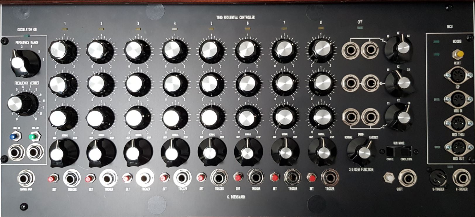

PostPosted: Wed May 05, 2021 10:07 am    Post subject: T960
Subject description: T960 clone of the Moog sequencer
T960 - Clone of the Moog 960 sequencer plus additional features like 16, 24 steps, ratcheting, MIDI:
https://www.youtube.com/watch?v=_7ABXwhIx7k

Very nice. Your 55 clone is epic!
