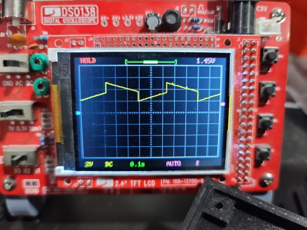

PostPosted: Mon Aug 12, 2024 9:00 pm    Post subject: Reply with quote  Mark this post and the followings unread
I'm attempting the super simple triangle LFO with all the given values by Tjookum, but I'm not getting a nice triangle at all. Attached is the waveform.
Just to get the obvious questions out of the way:
1) there are no points for intersections in the drawing, but all intersecting lines are actual connections, yes?
2) the unused inputs (pins 9, 11, 13) should be directly connected to ground, yes?
Thanks in advance!
 Filesize:  4.19 MB
 Viewed:  36 Time(s)
Sven
Joined: Mar 10, 2017
Posts: 51
Location: Norway
PostPosted: Thu Aug 29, 2024 8:38 am    Post subject: Reply with quote  Mark this post and the followings unread
Hello,
the schematic by tjookum is not the same as the one from Scott Gravenhorst which can be found here http://scott.joviansynth.com/electronics/4069_lfo.gif
You will find that the 100k resistor is misplaced. You should also tie the unused outputs to ground.

PostPosted: Thu Aug 29, 2024 9:01 am    Post subject: Reply with quote  Mark this post and the followings unread
Make that inputs ...
Sven
Posts: 51
Location: Norway
PostPosted: Thu Aug 29, 2024 12:19 pm    Post subject: Reply with quote  Mark this post and the followings unread
blue hell wrote:
Yes you are absulutely correct! thumright
