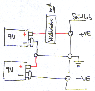

Hello, I completed my Sound Lab a few months ago and it has worked great up until recently, when I transferred it into a new case. This entailed a new panel as well. After I removed it from my old case I had it sitting around for a few days while I prepared my new case. Once the panel was ready I mounted everything and tested it...everything was fine at this point. Right before I was ready to drill it into the new case I tested it one more time and it sounded messed up, so I jiggled it around a bit and started sounding great again. I put it in and it worked fine. A few days later I played it again and no sound was produced at all. I opened it up and started looking for loose connections and stuff when I realized maybe it needed new batteries...so I put new batteries in and it worked again, but soon thereafter the AR generator stopped working. I began looking at it and trying to find problems , and from that point on everything slowly started to break down...at this point, the only things that work are the second VCO and the LFO and the white noise, sort of. But it's as if the minute I started to seriously look at it for the AR problem things just gradually got worse until it was at the point that it's at now. So I'm just wondering if anyone has had a similar experience after transferring it to a new case and was successful in fixing it, so maybe I know where to start. I know there are loads of general troubleshooting things, but it sort of seems geared towards boards that didn't work in the first place. Everything was fine to start out with, and it worked once it was in its new case, but then something just started happening and now it's all screwed up...I did resolder some things without taking the chips or transistors out, but I was careful that the places I resoldered were not on or near them...they were mostly pots/switches. Can that stuff get damagaed from heat as well? I'm just looking for some general advice here, thought maybe this might be a situation some others have been in. sorry this post is so long...

put new batteries in and find out how much current is being drawn by each of the power rails. (For the +ve rail, only connect the -ve of the +ve side battery, and complete the circuit with a multimeter set to mA. For the -ve rail, only connect the +ve of the -ve side battery, and complete the circuit with a multimeter set to mA. I'll add a pic in case this isn't clear)
Only leave it turned on long enough to get the readings you need.
Once you've found this out let us know what the results are and we'll go from there.

okay, so, for the positive rail (which is the battery snap whose black wire is connected to the ground between the two and red wire goes to the board), i have only the negative half of the battery in the snap and the multimeter hooked up between ground and +9V on the board. for the negative rail (which is the battery snap whose red wire is conneccted to the ground between the two and whose black wire goes to the board), i ahve one end of the multimeter hooked up to ground and the other hooked up to -9V on the board (??) ehh that's what the picture seems to suggest. i've also tried the meter hooked up to ground on one end and the other half hooked up to the portion of the battery snap not being used. regardless, i always get 0 mA, which is obviously wrong since everything but the two vco's and white noise is working (which is an improvement from yesterday, i think i had some shitty batteries on there and in the process of not knowing that and tryhing to fix other stuff i broke some chips by being charged and touching the board?) so yeah, at this point everything but the vco's and noise works, sorry if the picture explained everything easily and i just didn't get it, i think you might have to explain it some mroe for my retarded ass

to measure the positive rail connect the negative pole of the cell to ground as usual. then put the meter between the positive pole of the cell and the pcb. connect the second cell as usual.
to measure the negative rail connect the positive pole of the second cell to ground as usual. then put the meter between the negative pole of the second cell and the pcb. connect the first cell as usual.

The multimeter is not connected to the ground at all. It is put "in line" or "in series" with either of the power rails. The current you are measuring has to flow through the multimeter.

okay, so after doing exactly that my multimeter still reads 0 mA, but the lfo and ar are still working, which does not make any sense. maybe it's my multimeter?
for the positive rail, only the negative side of the battery connected with one end of the multimeter on the positive side of the battery and the other on +9V on the board. the other battery connected as usual.
for the negative rail, only the positive side of the battery connected with one end of the multimeter on the negative side of the battery and the other on -9V on the board. the other battery connected as usual.
still nothing! is there some sort of explanation for this, or am i still doing it wrong?
PostPosted: Wed Jul 05, 2006 1:41 pm    Post subject: Reply with quote  Mark this post and the followings unread
hmm...
SL working without power consumption? unlikely.
if not already checked be sure to set your multimeter to milliAmpere (some gear provides different plugs for Ampere and Milliampere).
just one more pictorial graphic for verification of wiring to measure the positive power consumption:

Yeah, and on mine I have to change the position of the lead.
