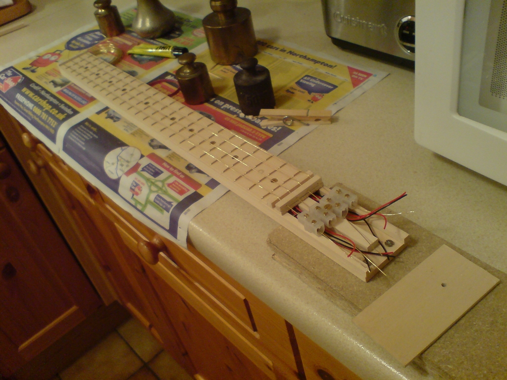

First time post here, and this post caught my eye. I'm currently building a guitar synth, got a 4 string proof of concept board working, and I'm shortly going to put it in a real guitar neck. When it's finished, I'll post the full details, but in the meantime here's a few piccies of the fretboard. I've split the frets, and each string is a simple resistor chain.
I'm using the gubbins from a joystick for the controller, conencted via USB to my laptop, where I've written a C# routine for conversion to MIDI.
I'm still working on the triggering - I've got 8 analogue channels to play with and 36 digital in my controller, so I could either go for 4 strings + pitchbend, modulation & volume on the analogue with digital triggering, or use 4 of the channels for velocity sensitive triggering via piezo transducers. I'm kind of making it up as I go along, so will probably go through a number of configurations before I settle on the final design.

It took me a weekend to put the fretboard together, but that was after toying for a few weeks with a one string proof of concept. (AKA a stick, some toothpicks, some staples, some drawing pins, a paper clip and a bit of wire) Smile Prior to that was 25 years waiting for the final bit of the jigsaw to fall into place for me to start it Smile It was originally going to be a mono controller for my Yamaha CS15 that's collecting dust in the loft, although now I know what I'm doing, I'll probably make a few Smile

When it's finished I'll be sticking up a few web pages on it, but until then I'll gladly share my scribblings and answer any questions (to the best of my ability) Smile
I would have liked to have built a standalone MIDI controller rather than use the PC, but I'm a better programmer than I am an engineer, and keeping it PC based means I can also code in some extra goodies at a later date, like arpeggiators, one note auto-chords, two hand tapping etc.
I've also written some software for the Ion iED05 USB Drum kit so that it can trigger MIDI on the PC. I need to lean out the code though as it's not polling as fast as I'd like it too, but I might incorporate an extra bunch of piezo pads on the body of the guitar so that I can throw in some percussive effects while I'm playing. One thing at a time though Smile
The wife's out of the country for a month in a couple of weeks, so I can turn the kitchen back into a workshop and stay up all night - with a bit of luck I'll have the basic "mark 1" finished by mid June Smile
