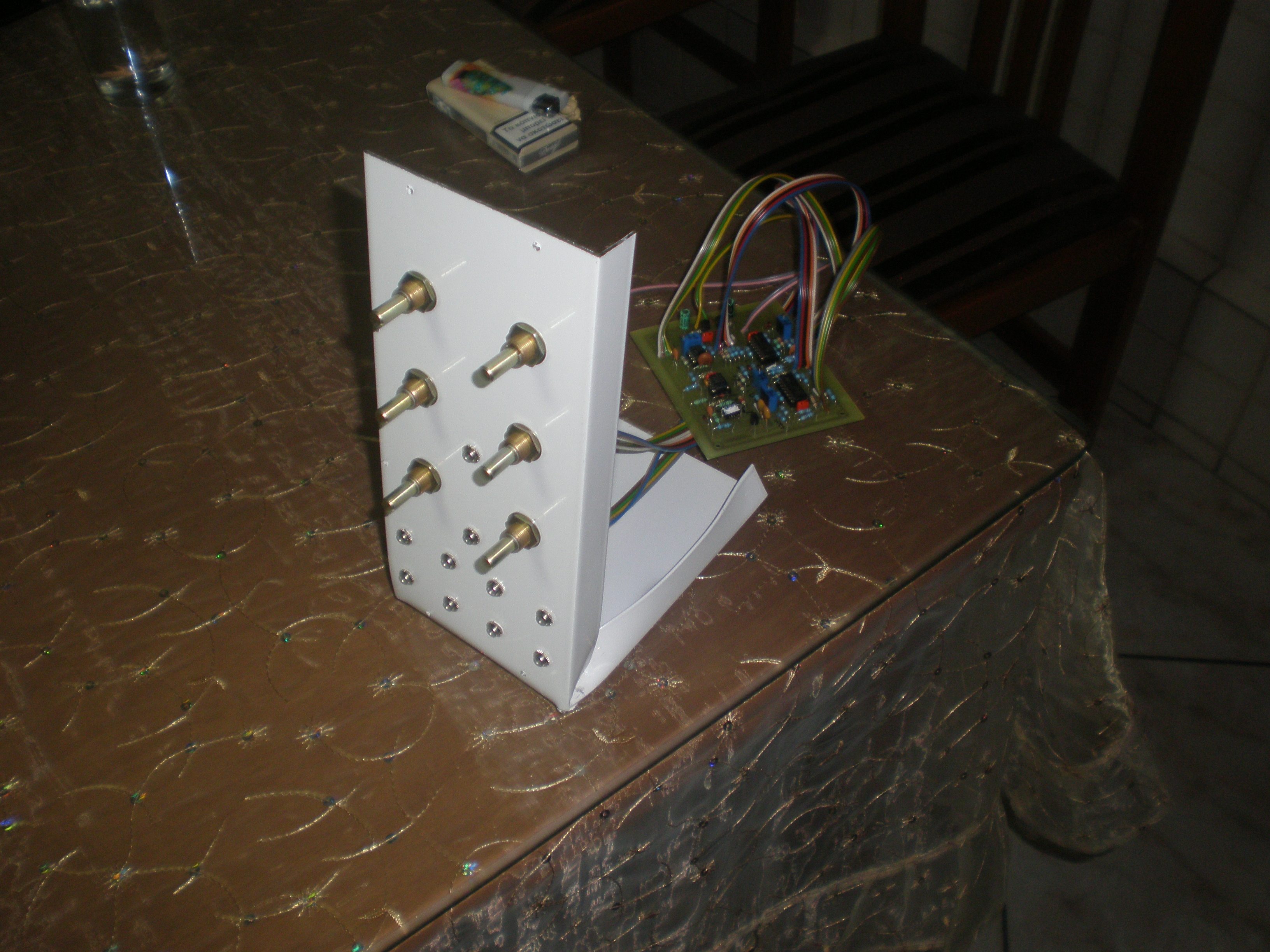

Hi!! I have finished my first vco and vca if i connect the vco out to the vca in should i hear anything? I haven't trimm the vco yet...
tHanks..

Hello Elektron026,
Actually you dont need a VCA for listen a VCO. The VCOs are outputing signal permanently.
VCA is a voltage controlled amplifier usually with gain+1, that means that in its maximum the output has the same amplitude than the input. So you can think the VCA as a voltage controlled attenuator.
So you can connect the VCO to the VCA(Simple VCA?) -to use it like attenuator- and with the gain and the input level at maximum, you should listen the vco, adjust then the levels for not overload the destination.

I have a problem with my vco ...i power on the circuit at the first 3-4 minutes i have only noise and after 6 minutes it starts to output sawtooth with pitch changing every some minutes then stops then starts again at the end it outputs sawtooth for 20-30 minutes stable then my circuit dies..
then i have to change the diodes and it works again but not stable like before......
maybe i have a wrong or defective component somewhere...
i have tempco the one from farnell..
and the silvered mica capacitor...
maybe somewhere i made a mistake with wrong resistor..
or is it possible i have a defective tempco?

I would say that these things happen in first projects. This output intermittent could be any bad connection like a cold solder.
A cold solder is a solder that not was done correctly and is not making good contact. look for video tutorials of solder on Internet.
Listening the oscillator touch with your hands the cables and components to see if there is any part that when you touch it makes sound, noise or cut the sound.
A good practice after finish a module is observe it visually, including a maximizer glass. Observe if all components are soldered. If they are solder correctly, if there is not anything shorting two traces. It is good also clean the PCB with toothbrush and isopropanol.
With a multimeter look if all chips are receiving power supply in its supply pins.
Revise if all resistor values are correct and if diodes and transistors are correctly placed.
A question: This intermittent sound is present in all VCO outputs?

I never had sound at pulse out!!
I will double check everything again and i will tell you!
Is it possible that the problem is that i didn't clean very good the solder flux from the pcb? Shocked
The crazy thing is that i had ... the vco running stable with a perfect sawtooth for almost two hours before it colapse..'without any noise' the first time i switched on the circuit...!!
Now if i try to switch on the circuit after 5-6 munites it is like it is trying to produce sound but then noise again...

Check it carefully and tell me. Always there is a solution. For example if you have not pulse output we will see in schematics the parts that compound the pulse output.
Lets go step by step.
So now make carefully the things explained in my previous post.

Finnally got it to work!!I made a new one from scratch!!''used some of your tips,cleaned the board very well..'' Now everything works perfect!!I love it!! 2sc1583 version!THANKS FOR YOUR HELP!!!!!!! Laughing Very Happy Very Happy

I used 4k7...
Here are some pics of my model on a Test panel i made&the PcB .. Laughing Laughing Laughing
Glad to hear that! the oscillator looks great Very Happy as well the test frontpanel!!!!
The resistors,
R8 is labeled 470K in schematics and with this trim associated sets , i think, the center of the frequency.
R36 and R51 sets the pulse span. If span is so width in the potentiometer extremes there is no sound output is just DC, this is because is limited. little value more span, big value less span.

So!What value is better to use? Very Happy Span? Ti shmenei?

Span is the space within two points, so for example in the potentiometer of the frequency control, span will be the space from the lowest frequency to the highest frequency achieved.
Now observe the pulse output in the oscilloscope. And move the pulse width potentiometer. You will see that with the pot about the center, the wave is an square. If you turn to one side the pot you will see that negative phase of that square will increase while positive phase will decrease, and vice-versa if you turn the pot to the other side.
If you had a real oscilloscope and the span was enough width you would see that turning to one side this pot, one of the phases is going little and more little until disappears, becoming just DC, so no sound.
Think this potentiometer as the threshold of a comparator that compares the saw output with this threshold level. Setting the comparator to positive or negative state. If threshold is more up than saw amplitude, it will not switch its state.
So there are designers that prefer more widest span and designers that limit it to the audio range. I don't know what choose Yusynth. But you can mod to your taste also.
