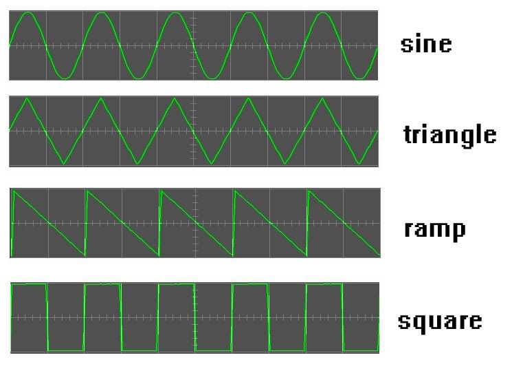

This might be a stupid question, but is a ramp wave the same as a sine wave? Confused

its a sawtooth / / / / ramps. but i think it could mean it goes the other way ascending

i have learn that the waves goes like this
but I'm not sure about it, because sometimes i hear people talking about sawtooth, triangle and ramp like they are the same wave ?
if someone knows please clear the thing to me and others

Ramp and sawtooth are the same thing (although I think that technically or mathematically the word ramp is used mostly when the signal is non-repeating (and goes on to climb or descend "for ever")).
BTW ascending or descending makes no difference for how the sawtooth wave sounds. A triangle is different, that one sounds softer and has less high frequency energy in it (when you sweep a filter over the signals it will be clear immediately)

On the LFO of the soundlab there is a switch with ramp triangle and saw so im guessing in this case it means one ramps up and the other ramps down and the tringle ramps up and down

There is a difference when modulating with ramp waves. With a reverse ramp (when the sloped side comes first) there is a gradual modulation and then an abrupt end. The standard saw has the opposite effect.

I should add that a ramp wave (sawtooth) is rich in both odd and even harmonics, whereas a sinewave only has one- its fundamental.
A triangle is like a sinewave- but has a couple more harmonics (even I think- been a while- childcare takes it out of you!!). Triangle waves are good for synthesising flute-like or pipe organ sounds.
A squarewave only contains odd harmonics and has a much more buzzy sound. Therefore its good for making other woodwind sounds. for eg, Instruments that contain a reed such as an oboe or clarinet. Squarewaves can also be manipulated through mark-space-ratio to create 'pulsewaves'. Pulsewaves are good for creating vocal sounds- especially if used with a high resonance filter.
A sawtooth is good for creating string sounds- because they are rich in harmonics. Saw's are also good for filtering because it's easy to get that classic 'rasping filter' sound- so beloved of Tangerine Dream and 70's sci-fi fanatics.
