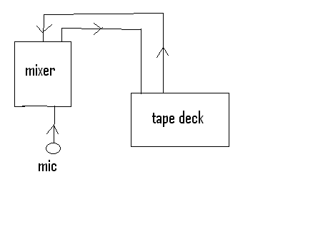

as said earlier: you need a three head casette player or a reel to reel recorder. It has to be able to record and playback at the same time.
then do this:
use a small mixer, connect a mic to the mixer( say.. channel1), send the mic signal from aux1 to the tape desk that is recording and playingback at the same time.
connect the line out of the tape deck, back to another channel ( say.. channel 2) on the mixer.
you can now control the amount of feedback by sending the returned tape signal(channel2) back to the tape deck via aux1. and even do eq'ing (filtering, like the copycat)
If you have no experience with mixer/audiorouting, then buy a cheap behringer mixer, and you'll soon understand..
hope that helps!
