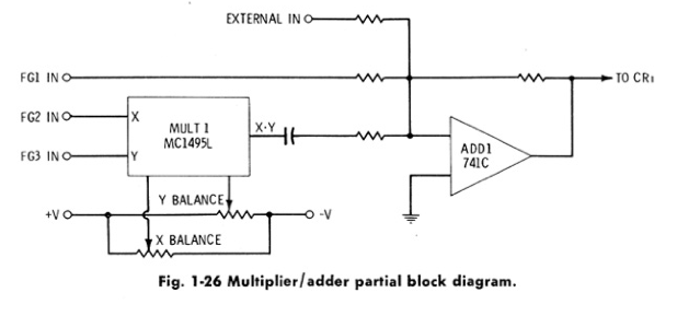

OK, digging in a little deeper... since my modular already has several oscillators, two analog multipliers and two DC mixers, the only thing missing from this block diagram are the phase shifters.
Can anyone EE-skilled enough look at the phase shifter schematics and tell me what components would have to be changed in PS 2,3 if I replaced the dual-gang 300K pot (hard to find) with either a 200K or 500K?
According to Waite:
Integrated circuits IC3 and IC4 are simple voltage followers that unload two RC networks while providing a low output impedance.
So how could I recalculate the RC network with a different variable resistor?
Source of both images is Mitchel Waite's Projects In Sight, Sound And Sensation, as linked to earlier in this thread.

Posted: Mon Sep 19, 2011 2:56 pm Post subject:
The RC product is interesting, so when you go from 300 to 200 K you'd want to scale up the caps with a factor 1.5; also the fixed resistors could be rescaled, with a factor of 2/3 then.
Likewise, when going to 500k rescale the fixed resistors too with 5/3 and the caps with 3/5. _________________ Jan

Posted: Mon Sep 19, 2011 3:08 pm Post subject:
muchos gracias!
200K 1.3K 0.0015uF/1.5nF
300K 2.0K 0.001uF/1.0nF
500K 3.3K 0.0006uF/0.6nF/600pF (or 560pF, which is what is more common)
now I'm thinking about vactrols  _________________ Esoteric drones and nonlinear distortion

I've used AD633s before, they're quite simple. One thing Waite writes about that I don't get how to do with them is X/Y balancing:
If the circuit is operating properly, P1 should make the waveform vary from amplitude modulation to suppressed carrier modulation. Potentiometer P2 will vary the symmetry of the modulated signal.
This isn't the DC offset function you could use at pins 2 and 4 of the AD 633 is it? See Roman Sowa's ringmod schematic (although he uses the DC offset at pins 1 and 3 instead)....
EDIT: quick look at the MC1495 datasheet tells me yes, Waite's "balance control" is a simple offset control. Thanks internets...
