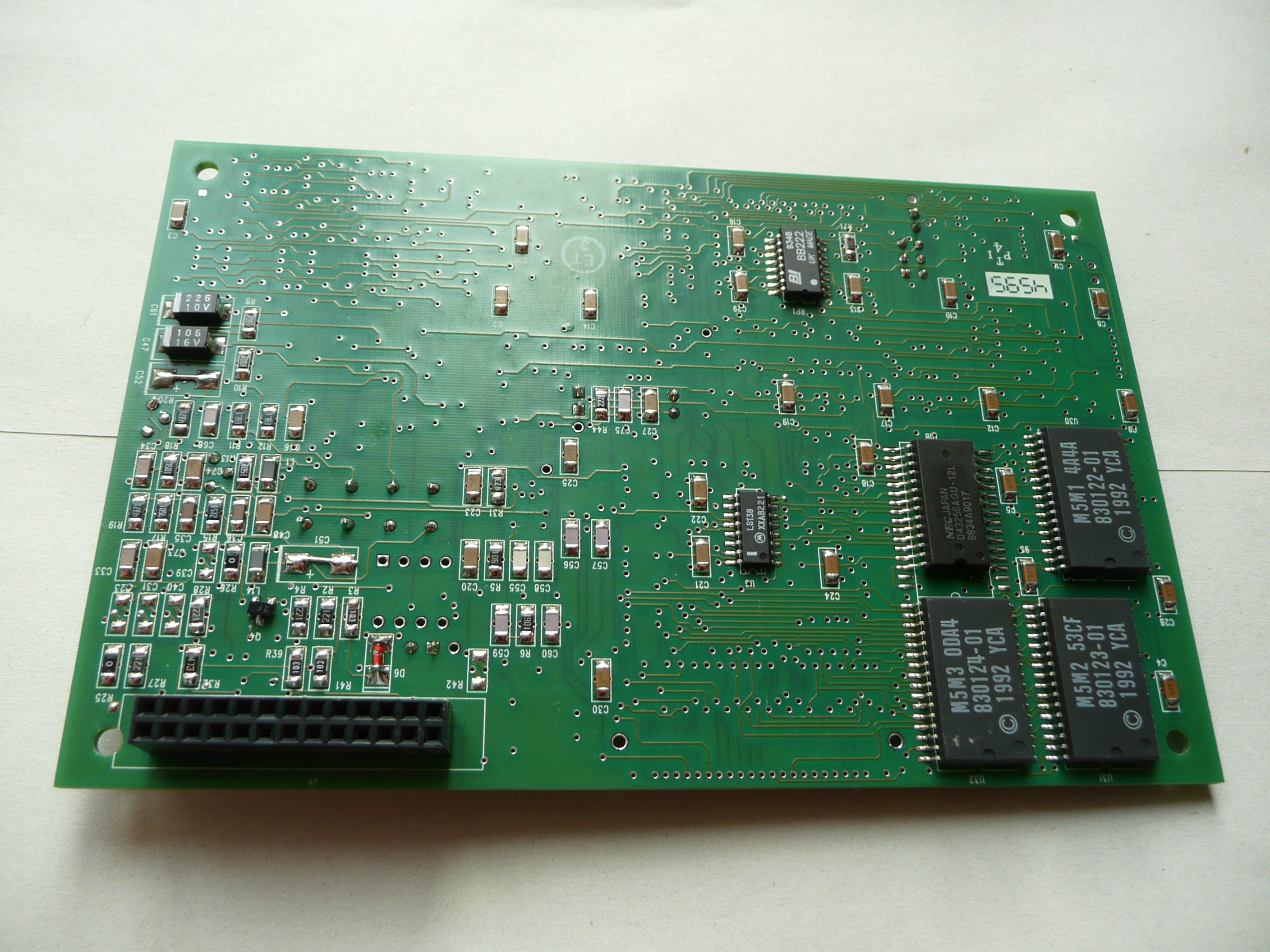

Hi
I have a Buchla Lightning 2 which features a AVM GM daughter board with a Kurzweil soundset - the output of the board dropped by 80% so I am looking for a replacement in the hpe it will fix the problem - anybody have a clue where to look for such a thing? The only info I have is that the board says AVM General Midi rev 3 - I guess it must be 10-12 years old as that is when this unit was manufactured.
do all the daughter boards you are discussing here have the same connectors and specifications? Are they interchangeable? I am wondering if I may take this opportunity to upgrade or try out some different boards - of course I don't know if the Buchla software would be very happy about it - the unit does have an extra midi input intended for computer editing of the soundset so in theory I could do that too
excuse my vagueness I only realised that such things as daughter boards existed today when I had a look in my Buchla because it stopped working
grateful for any pointers
Richard

Can you post pictures of the board, (particularly if it has a 26 pin connector)? We might be able to take a quasi-educated guess if this daughterboard is compatible with the GM Voice boards.

PostPosted: Sun Mar 09, 2008 4:47 am    Post subject: Reply with quote  Mark this post and the followings unread
ok here is one side
 Filesize:  1.94 MB
 Viewed:  563 Time(s)

PostPosted: Sun Mar 09, 2008 4:48 am    Post subject: Reply with quote  Mark this post and the followings unread
and here's the other
 Filesize:  2.01 MB
 Viewed:  540 Time(s)

PostPosted: Sun Mar 09, 2008 5:33 am    Post subject: Reply with quote  Mark this post and the followings unread
Richard,
It seems the connector is identical to a GM Voice connector. If I were a betting man, I would bet that it is compatible. It is probably worth a try to get a GM Voice daughterboard and try it out.

one more thing before you spend cash on a new daughterboard, try putting line level signals into the Lightning's mating connector, pins 20 and 24 to make sure it is not the output stage of the Lightning that is the problem....although it is doubtful if both channels are out at the same time ...unless they share a common op amp....then that would be the first place to look, I guess!

ok that was my next question,
is there any way of telling what is 20 and 24? I have no numbering on the mainboard or daughterboard.... I do have J13 at one end of 26 pin the mainboard
typically would the entire D/A path going out to line level be on a GM daughterboard? Or would there likely there be some kind of op amp circuit on the mainboard? obviously the buchla is not typical of anything but it would be useful to know if I am probably on the right path.
I can ask Mr Buchla for the exact answers - but its much better if I know what I am asking, and from experience its sometimes its quicker to try and sort these kinds of things out myself

PostPosted: Sun Mar 09, 2008 7:43 am    Post subject: Reply with quote  Mark this post and the followings unread
If you take a peek on the solder side of the board, the square pad is pin 1, the one below that is pin 2. Just keep counting in that way .. The pin next to 1 is 3. This, that row gets all the odd pins. Hope that helps
Also, I see a number of transistors over near the end where pin 26 is. Do a diode check on all those transistor junctions to see if they have not been damaged ........

PostPosted: Sun Mar 09, 2008 8:23 am    Post subject: Reply with quote  Mark this post and the followings unread
I really appreciate this guys, as you can no doubt tell I have no idea what I'm doing. But blowing up the Buchla would not be good at this point so I need to be super clear.
If I want to test the mainboard audio left I touch a line level wire to 24 and the other wire to what else - 23?
and to test the left one wire to to 20 and the other to 19?

PostPosted: Sun Mar 09, 2008 6:32 pm    Post subject: Reply with quote  Mark this post and the followings unread
Richard:
Yes 19 and 23 both connect to the same analog ground, so they would be your ground connection. Pls do go thru this whole thread from the beginning as a number of your questions have been addressed already.

PostPosted: Tue Mar 11, 2008 2:10 pm    Post subject: Reply with quote  Mark this post and the followings unread
Okay, it was a bit confusing. almost inevitabley the buchla is wrong way around so the relevant pins were different. But I did it without killing myself or the buchla
The level coming from the buchla is much lower than if I touch the line to the jack plugs... so i think I can safely assume my daughterboard is okay and it is the op amp/s on the buchla that have gone down - bummer.
However I am happy to discover the daughterboard and will be very interested to try some others in there to see if they work and how they sound
