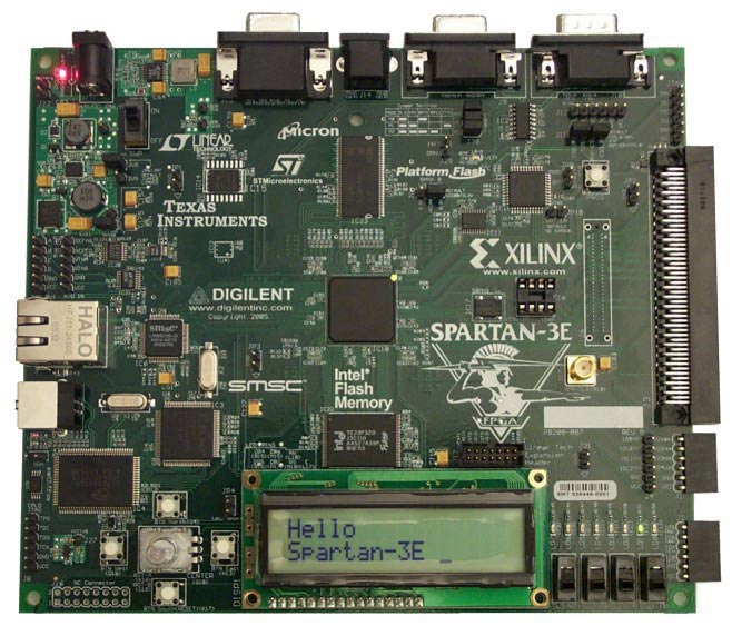

PostPosted: Sun Jan 06, 2008 6:11 pm    Post subject: Reply with quote  Mark this post and the followings unread
Scott,
Well written and thank you for the insight on this remarkable subject Very Happy
I do not work for Xilinx or any other FPGA mfr, I just think they are really cool.
Well that makes two of us Very Happy
it is my hope that more people will experiment with FPGAs for music and share their designs.
Well, I am purchasing a Spartan 3E starter kit. This is is the recommended, and a very good one, development board that will suit design efforts involving audio synthesis and manipulation of audio. I believe this is the platform you are running Scott?
Here is a link to purchase one:
http://www.nuhorizons.com/xilinx/boards/spartan-3/SP3eStarterKit/index.asp
Here is a ink to the boards documentation in case others are interested:
http://www.xilinx.com/support/documentation/spartan-3e_board_and_kit_documentation.htm
The Spartan 3E kit is pictured below ......
There is plenty of DDR RAM (16 MB), FLASH Memory, a BIG FPGA, (2) 14 bit - A/D's and quad 12 bit DAC !! Among many other cool attributes !!
I also just got this Coolrunner II board also from Avnet ........ This board is shown below the Spartan 3E board .......
The Coolrunner II is great for smaller projects that are less "math" intensive and thus does not have the hardware multipliers but you can embed the Picoblaze 8 bit MCU in this thing and it's great for very low power applications .....

PostPosted: Sun Jan 06, 2008 11:49 pm    Post subject: Reply with quote  Mark this post and the followings unread
Are these programmers, or do you need one of these for every project?
PS I know that is possibly a silly question to those who know this stuff, but I just wanted to check.

I can't say for the CoolRunner board, but the FPGA (Starter Kit) board is a development board. An FPGA is RAM based, so it must be programmed each time it is powered up. You cannot program an FPGA in one board and drop it into another circuit like you do with a PIC. In fact, the FPGA on the Starter Kit board has a grid of 320 contact balls on the bottom and as far as I know, this must be soldered so the FPGA cannot be removed once it's installed. The dev board that I use (the same one pictured above) contains an FPGA and a whole lot of useful doodads for developers. Among them are (as mentioned) the DAC and ADC, an SDRAM (which I believe is 32 megabytes, not 16) etc. I have 4 of these boards because each one can be a synthesizer (or audio effect)
What would be extremely cool is if someone would put together an FPGA development board that is geared more toward audio than general purpose use as the Xilinx board is. We don't need VGA or Ethernet for example, but a big static RAM would be nice. And the 12 bit DAC, while servicable and quite musically useful would be nice if it were 16 or 24 bits. BTW, one nice thing about the DAC chosen for this board is that it can operate at an update rate as fast as 1.0 MHz. As I may have said before (old man memory), all I had to add to the starter kit board was a resistor and cap for the DAC output to audio monitor circuit and a 6N138 with 2 resistors for the MIDI input.
I might also mention that an FPGA is not strictly for MIDI. If the ADC is used as CV and audio inputs, an FPGA (even on a dev board) can be incorporated in a modular.
Also, because an FPGA is RAM based, it is easily reused simply by pushing another bit file into it. So you can do one piece with synth-A and another piece with synth-B using the same board. As far as gigging goes, the Starter Kit board has a platform flash IC that reprograms the FPGA at startup. You can (and I have) stored a synth in that platform flash so that it powers up as a synth I use often. This means that if you have such a favorite design, you can gig with it without having to bring a computer to the gig.
I hope this helps. dalek <- heh, a Dalek!
The Spartan board requires a downloader cable such as a Multilinx or something to get a bit configuration into the configuration EEPROM. For debug, you can just load the FPGA directly to test your design. When your done debugging, then you can commit the configuration to the EEPROM.
Each time the board is powered up, the FPGA bitstream is loaded into the device from the EEPROM so there will be a short delay of several milliseconds before the FPGA is ready to work. No big deal in most cases. The programming interface for this board is a program called IMPACT which is part of the development package that comes with the board.
The Coolrunner II board just requires a USB cable and there is a processor on the flip side of this board, nort shown in the picture, that receives and sorts the USB data out and programs the CPLD on the board.
Hope this helps further for you .........

alright, i feel myself getting sucked into the fpga thing now...
but wouldn't the Spartan 3A DSP be better than the 3e for audio applications?
Off hand, how does it differ? I know the 3E is $150.00 while the 3A is $230.00. I figured I would save myself from going to the website Very Happy Very Happy
I just purchased a 3E Board from "NU Horizons Electronics" .... Cool

i almost ordered the 3e this weekend, but foolishly started looking at the other offerings...
the 3A DSP version developer brd is what i was thinking of, which seems to have more of everything (gates, ram, flash, etc) plus dedicated dsp. it is twice as much though, at $300. this will be my first adventure in fpga, so i may well be missing something...
