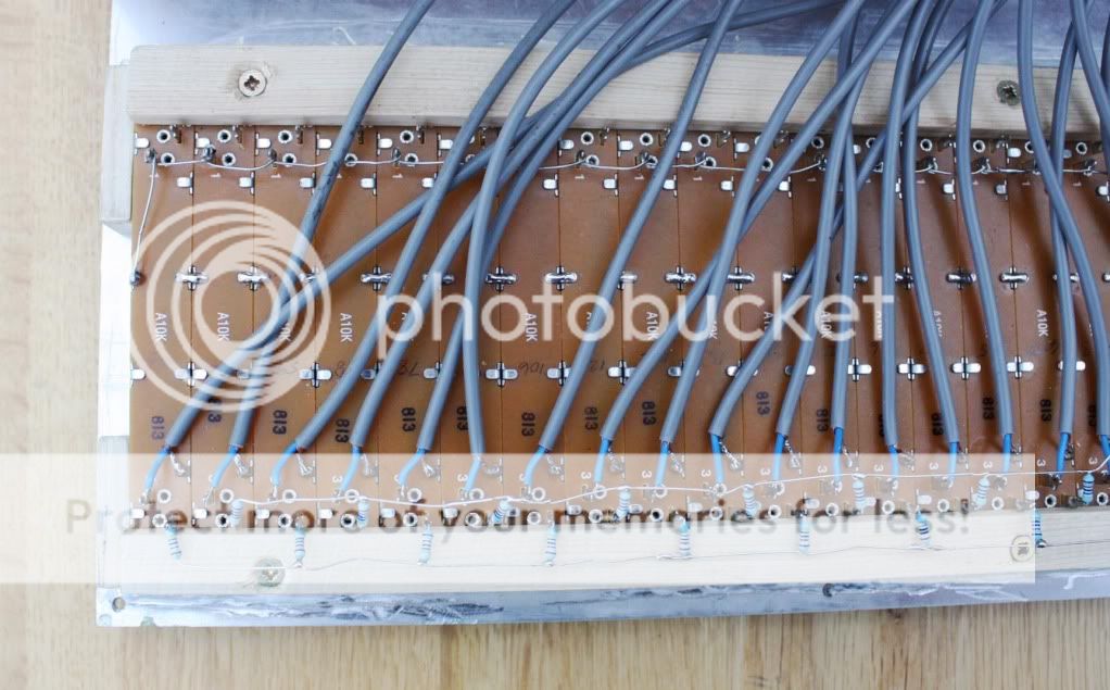

PostPosted: Tue May 18, 2010 11:56 am    Post subject: Reply with quote  Mark this post and the followings unread
2thick4uni wrote:
The pots are not fitted to a pcb or matrix board, they are fitted inside a timber frame with a couple of removable retainer strips so that I can replace any sliders should they fail...
The more I think about this the more I wonder...do you have any pics of how you did this?

PostPosted: Wed May 19, 2010 11:42 am    Post subject: Reply with quote  Mark this post and the followings unread
emdot_ambient wrote:
Hi Emdot_ambient,
Sorry for slow reply, my camera and String filter weren't in the same location. Couple of shots of the pot retaining arrangement as requested, the two wooden strips that retain the slider pots are screwed to two pieces of wood underneath which are bonded to the aluminium front panel, hope this makes sense.
All cables are shielded, not sure if it's necessary but I just wanted to keep the noise floor as low as possible. The resistors you can see are just temporary, testing different mixing arrangements at the moment.

PostPosted: Thu May 20, 2010 9:45 am    Post subject: Reply with quote  Mark this post and the followings unread
Awesome. Yes, that makes total sense. Thanks!
