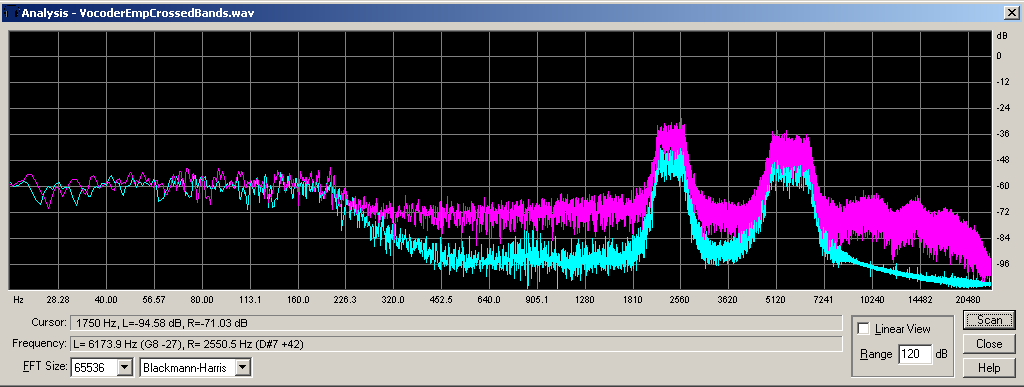

Hi again.
I think I have managed to illustrate what the emphasis button does.
The patch works with band 1, 11 and 15. 2 vocoders for stereo and only one has Emp-button engaged.
Noise is sent through to be modulated and a frequency plot shows that band 1 has the same amplitude in both left and right channel. With Emp engaged it seems the 'synthesizer input' (noise in this case) bleeds through even when there is no corresponding signal in the control/modulation input band. There is also an increase of the amplitude in the higher bands for the Emp:ed vocoder.
If you cross over the 11 and 15 bands on both vocoders and frequency plot that you see that you get more amplification in band 11 (because it is fed the signal from band 15).
Hope at least something of this makes any sense what so ever Very Happy

Picture showing the effect of crossing band 11 and 15
