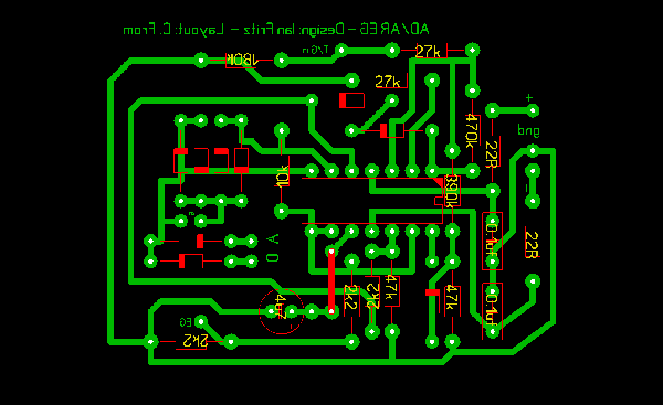

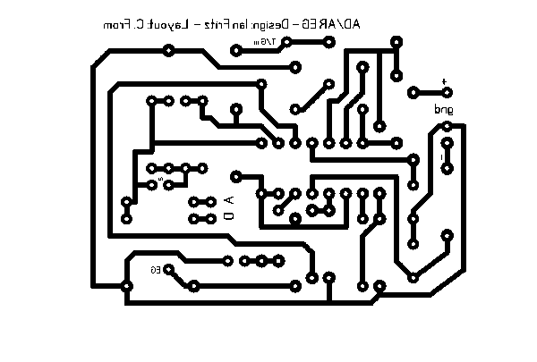

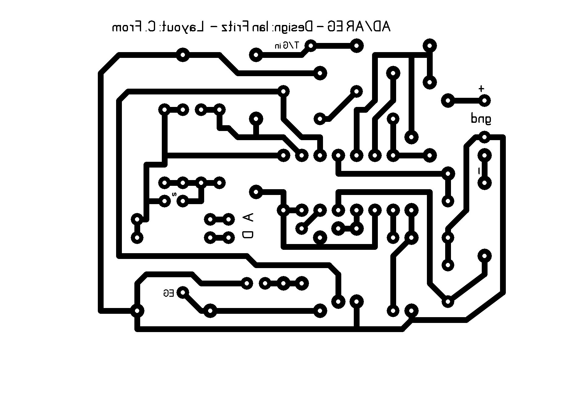

I recently did a pcb-layout of the simple little AD/AR circuit presented to the forum by Ian Fritz...here:
http://electro-music.com/forum/topic-21723.html&postorder=asc&highlight=envelope+generator+ian
He mentions an addon to it here:
http://electro-music.com/forum/topic-21723.html&postorder=asc&highlight=envelope+generator+ian&start=25
I built mine without the trun switch, but the pads are included on the layout.
The jumper betwen the opamp and the 4.7uf cap is where you mount one side of both pots - the other side goes to either the A or D, depending on whether you are wiring Attack or Decay. Solder the wiper to the A/D leg of the pot, and you've got longer A/D times turning the pot clockwise.
I used 1N4148 for the diodes, and added supply caps and 22R resistors on the supply as well (the Ken Stone trick).
Didn't provide pads for the x and y inputs found on the schem, but if you want to add the delayed pulser like Ian has it on his units, I guess you could just hang that off the leg of the 390K resistor going to +input of A1.
Haven't tried that myself though.
Hope this is useful to someone - it's my first layout contributed to this forum, so I'm kinda proud of it... Laughing
Best,
C
Edit: I should say: This layout is ready for Press and Peel.

PostPosted: Mon Feb 25, 2008 6:17 am    Post subject: Reply with quote  Mark this post and the followings unread
Nice job - thanks for sharing this, Coriolis!
This is a nice circuit - I've got a pair of these in my newest cab and I them a lot.

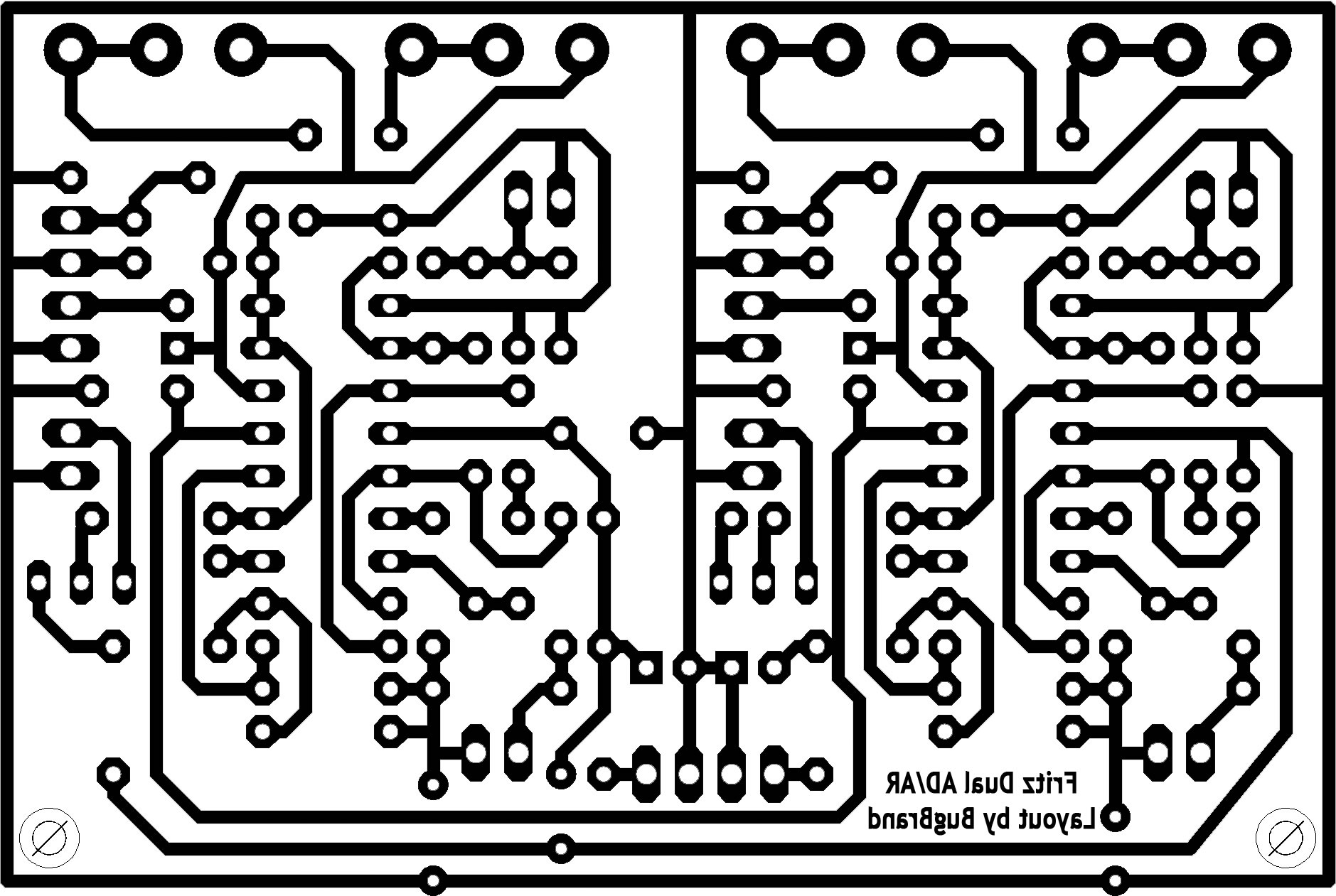

Coriolis' PCB layout spurred me to do my own dual version last week (sorry, I don't mean to steal any of your thunder by adding my own layout!)
I've always been very keen on such EnvGens and this is a really great design - I'm gonna build a stack myself! I very much like compact layouts with pots mounted on board and this design really lent itself to a dual version. Its laid out for 16mm Alpha pots spaced by 0.8" (20.32cm) so fits nicely into my Frac system (or Eurorack).
I added LED indicators using standard transistor buffers and also included an extra switchable timing cap for each EG - I've yet to do my final value selections on these, but if you use holders you can always test things and select your favourite values (Ian's original schem specified 4u7)
I've done it up as a PDF with schematic redraw, parts placement and press'n'peel image. Of course its possible that the exact size of the PCB image may get scewed off somehow, so I'm attaching a hi-res TIF of the PCB too.
Enjoy! Many thanks to Ian for the great circuit!

Hey, so is the .tif not so much use to people? I could easily convert it to something else more standard - I just thought tifs were nice resolution.. Actually, I daresay jpeg would be just fine..
Ok, here it is again - 72dpi one and 600 dpi (I always wonder if that'd get resized? depends on software etc - confusion!)
