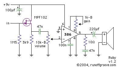

I've started doing some experiments with the LM386 as a coil driver like in an e-bow. I've attached the schem for the e-bow and for the ruby amp for reference.
One thing I don't understand is that I can only get the e-bow to work (ie set up an oscillation in a guitar string), if I use the 500R side of the transformer. The schem looks very similar to the Ruby Amp which is driving an 8R speaker. So why the difference?
When I connect it to the 8R side of the transformer the LM386 seems to self oscillate at a sub sonic frequency regardless of input.
BTW Does anybody know what a "telephone pick-up" is? It's impedance? mV out?

PostPosted: Tue Aug 05, 2008 5:37 am    Post subject: Re: LM386 E-Bow Experiments Reply with quote  Mark this post and the followings unread
The transformer is more inductive as it has more windings than a typical speaker. Amplifiers tend to not like inductive loads and the 47n / 10E network is present to compensate which is needed even for a speaker load. Now the 500 E winding would have even more inductance, but also more resistance (the Q factor is lower, the wire not as thick), so probably that one behaves more like a resistive load. It's good to keep an eye on the amplifier, inductive loads are capable of killing amps. As long as it doesn't run too hot you'll be OK likely, but also check it with a scope to see if you have funny oscillations on the output (as you already did I see now).
PostPosted: Tue Aug 05, 2008 7:39 am    Post subject: Reply with quote  Mark this post and the followings unread
Thanks Jan,
Yeah the output looks a bit "spikey", I assumed that was because of the back EMF from the transformer adding to the alternately swinging drive current. (That sounds more impressive than my understanding is! Laughing )
Okay, so I need to use the 500R side whether I'm going in or out. I'm adding tiny rare earth magnets which are held on the ends of the "springs". They definitely up the input transducers effect, (2-3mm of vibration on a "spring" which is only 35mm long!) and I figured they would be the only way of getting anything out.
Now I just need to look at the amplifying of the output. I'm thinking I'll just run straight into a high gain op-amp, that should allow up to 5-10V p-p hey?
Then I need to do some impulse testing, and see if I can tweak the "web" to be a little less predictable in the way it reacts to various inputs. Maybe even build another couple with differing "stiffness" and see how that goes.
There should some pics, and possibly even a sound sample soon! Very Happy

I can't speak to the coil issue, but there are a few 386-related things you can try.
1. You can increase gain a bit by connecting pins 1 and 8 together and then connecting that to a 100ohm and 4.7uf cap in series to ground, sort of like this: http://beavisaudio.com/Projects/ArmageddonProcessor/index.6.jpg
2. Since you are driving an actual speaker, you could probably drop the zoebel network off the end (i.e. drop the 47n/10 ohm to ground).
3. I've done a lot of 386 based stuff and have found that in almost all cases the JRC/NJM version of the chip is more stable.
4. Off pin 7, I almost always use a 100nf to ground for stability.
FWIW, and good luck with the project.

PostPosted: Sat Aug 09, 2008 9:31 pm    Post subject: Reply with quote  Mark this post and the followings unread
Since you are or since you aren't?
Cos I'm not, driving an actual speaker. It's driving the 500R side (CT) of a 450mW output transformer, but there's nothing on the 8R output winding.
Thanks for the ideas beavis. Very Happy
While we're at it:-
What does a Zoebel network do exactly?
Can I control the frequency response by varying the 220uF on the output?
How much input signal is too much? For example, when I open up the attenuator pot I put across the input (B10K) and then put say a 2Vp-p sinewave in, the trace shows an obvious clipping across the output.
While we're at it:-
Right, since you *aren't* driving a speaker. Smile
Zoebel network: a fancy name for a filter: http://en.wikipedia.org/wiki/Zobel_network
I think you could control frequency response, but I would leave the 220uf output cap in place. What I would do is a low pass filter either before the input, or for more fun, splice it into the 386's feedback loop, right between pins 1 and 8.
Almost all the stuff I've done with the 386 is for guitar, and my pickups rarely put out more than 1v P2P. So I actually strive to boost the signal to get as much distortion as possible, probably the reverse of what you are trying to accomplish Smile. If you use the N4 version of the LM386 chip, you can theoretically drive it up to 18 volts if memory serves me. That should give you more headroom before you start clipping.
www.beavisaudio.com
PostPosted: Sun Aug 10, 2008 4:05 pm    Post subject: Reply with quote  Mark this post and the followings unread
Okay, so, what you're saying is that because I'm not driving an actual speaker, I could maybe do away with the Zoebel network. The Zoebel network is acting to equalise the impedance presented to the amp regardless of the frequency which the speaker is reacting to, yeah? Or in other words, it's minimising the drop in impedance around the resonant frequency of the equivalent LR circuit of the speaker. Which is very interesting, as the effective L of the speaker (or transformer in my case) will change depending on a number of physical factors as well, yeah? Like the strength of the magnet, the dampening in the cone, the resonant frequency of the enclosure, etc.
The reason I'm thinking this out loud is that my most important consideration at this stage is how to reduce the fundamental resonant frequency of my "web", in order to minimise standing waves taking over completely. It's actually the higher frequency resonances I really want. So where you said I could maybe use a low pass filter in the input or across pins 1&8, I actually want a high pass. Know what I mean?
So understanding the Zoebel network could be crucial to getting the best energy transfer into the "web" without allowing it to settle into it's most prominent resonance. For example, if I find the fundamental resonance of the web, I could tweak the Zoebel network to greatly increase the effective impedance at that frequency, which should equalise the driving force from the transformer.
It would be very handy if I could find out what the inductance of my modified transformer primary is hey? Keep in mind I've disassembled the core and put all the E peices back but not the I's. Or should I ignore that and just work off what I can measure as the overiding resonant frequency of the transformer/magnet/and web is?
Thanks heaps Beavis for this bit of theory before I get into any more experimentation. I really helps clarify what I'm trying to do, and what are the important considerations. Very Happy
