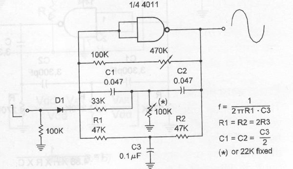

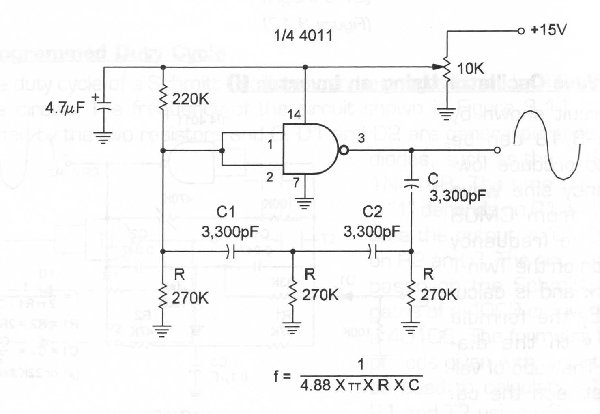

PostPosted: Thu Oct 09, 2008 6:26 pm    Post subject: Reply with quote  Mark this post and the followings unread
haven't tried these, sin_0001 looks the more interesting of the two -

 Filesize:  53.24 KB
 Viewed:  466 Time(s)
urbanscallywag
Joined: Nov 30, 2007
Posts: 317
Location: sometimes
PostPosted: Thu Oct 09, 2008 9:08 pm    Post subject: Reply with quote  Mark this post and the followings unread
The problem with these circuits is making them tunable (let alone voltage controlled) right?
well the second one andrew posted does appear to be voltage controlled already.... the pot (im assuming it controls frequency) is wired as a voltage divider supply the circuit 0-15V depending on its position....
az/gde

urbanscallywag
Posts: 317
Location: sometimes
PostPosted: Thu Oct 09, 2008 10:03 pm    Post subject: Reply with quote  Mark this post and the followings unread
I guess both of them have pots, but they just aren't included in the equation. Oops!
jnuaury
Joined: Feb 28, 2008
Posts: 161
Location: chicago
Audio files: 9
PostPosted: Thu Oct 09, 2008 10:11 pm    Post subject: Reply with quote  Mark this post and the followings unread
well the first circuit has the pots wired as variable resistors (rheostats)
but the second one the pot actually divides the voltage meaning you could remove the pot and toss a cv in where the wiper was connected (pin 14)
theoretically at least

urbanscallywag
Posts: 317
Location: sometimes
PostPosted: Thu Oct 09, 2008 10:15 pm    Post subject: Reply with quote  Mark this post and the followings unread
Yeah, I see that. But when I looked at the equations I didn't think they were tunable even though I did see the pots.

PostPosted: Fri Oct 10, 2008 1:12 pm    Post subject: Reply with quote  Mark this post and the followings unread
The first one seems to be a drum osc, where the sine fades out at a rate controlled by the variable resistor.
urbanscallywag
Posts: 317
Location: sometimes
PostPosted: Fri Oct 10, 2008 1:23 pm    Post subject: Reply with quote  Mark this post and the followings unread
I saw the trigger input and thought it was like a bootstrap to get the thing oscillating.
Posts: 24119
Audio files: 279
PostPosted: Fri Oct 10, 2008 1:35 pm    Post subject: Reply with quote  Mark this post and the followings unread
That's about the same thing ... when it can be set to oscillate forever.
urbanscallywag
Posts: 317
Location: sometimes
PostPosted: Fri Oct 10, 2008 1:38 pm    Post subject: Reply with quote  Mark this post and the followings unread
I see, the pot is decay control, and with the suggested 22k resistor it should oscillate with continuous amplitude?
Posts: 24119
Audio files: 279
PostPosted: Fri Oct 10, 2008 1:57 pm    Post subject: Reply with quote  Mark this post and the followings unread
When its really a drum osc, but I'm < 100% sure, it would likely decay to zero with 22k. So basically I don't know Wink
