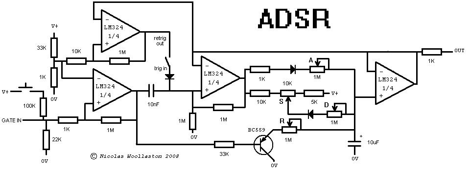

Here's my ultra simple ADSR that can also retrigger itself to behave like an LFO. Mine is running off +/-9V with an LM324 doing the business. You might need to tweak a few resistors around the gate input area if you wanted to go to +/-15V, but probably not by much. Log pots are preferable. If you want to have lots of ADSRs in your synth a simple design like this makes it feasible.
My ultra simple ADSR that can also retrigger itself to behave like an LFO. +/-9V with an LM324 doing the business. Log pots are preferable.
 Filesize:  43.98 KB

PostPosted: Thu Feb 12, 2009 5:38 pm    Post subject: Reply with quote  Mark this post and the followings unread
That looks really simple and interesting. I could easily fit 4 of those on a protoboard. Has anyone else tried this design under +/-15v? I may give it a shot.

PostPosted: Sat Feb 14, 2009 1:45 am    Post subject: Reply with quote  Mark this post and the followings unread
crashlander42 wrote:
It works quite similarly to the 555 based ADSRs, but has the LFO capability and only requires a single chip.
+/-15V should be fine without any modification I think. Remember though that the LM324 is only rated for 32V overall. If you build your first one with a socket you may want to try out different op-amps. If you are keen on very slow or very fast envelopes you can change the 10uF capacitor. For very very slow envelopes you may need to switch to a fet input opamp like the TL074, but I have not tried that. Things you may want to tweak are the resistors (10K and 5K) either side of the S pot. Tweak the 10K so that the sustain level is at zero volts when the pot is fully turned to the left. Tweak the 5K so that the max sustain level is around the same level as the attack peak. The exact values you need are dependent on the type of op-amp you use.
I have built mine with a switch to switch it into LFO mode, where it retriggers itself. But if you are building more than one I suggest you have retrigger out and trigger in sockets instead (put a 10K resistor between the board and the socket to protect against short circuits). That way you can connect up a pair (or more) cross triggering each other. This allows you to have a kind of LFO which can alternate between fast and slow, etc. Very cool.
I built mine on stripboard. I will post the layout when I find it.

PostPosted: Sat Feb 14, 2009 7:59 am    Post subject: Reply with quote  Mark this post and the followings unread
Nicolas --
Nice design! What happens when there is no gate and you feed in an external trigger pulse? When the latch resets after the attack phase, both the "D" and "R" pots are contributing? It looks like there could be some intertesting compound decays.
Ian
