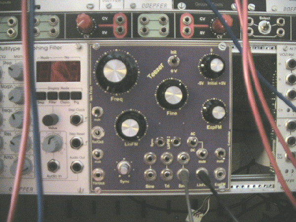

here are my two Teezers:
Teezer with provisoric Motm format panel + 5 Pulser ( which is sadly not running for now )

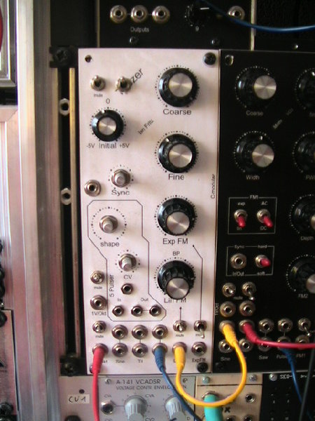

Teezer in Euroformat . the colour was thought to be close to black. It looked black on my Screen.................but i like purple too ;)

TekniK
Joined: Aug 10, 2008
Posts: 1059
PostPosted: Fri May 29, 2009 12:09 pm    Post subject: Reply with quote  Mark this post and the followings unread
that strip in the middle looks great Funky40

PostPosted: Sat May 30, 2009 11:08 am    Post subject: Reply with quote  Mark this post and the followings unread
Thanks, but i hoped somebody would like the Teezer, hehe Wink
the strip i call "submodules". only one is halfways built , but all the racks are prepaired for those. Only a huge waiste of space for now
i like your modularmusic-blog btw., great feel for sounds and also the pictures.

PostPosted: Sat May 30, 2009 4:31 pm    Post subject: Reply with quote  Mark this post and the followings unread
Your euro Teezer looks great Funky40! How do you make the panels & graphics on your modules?
Funky40
Joined: Sep 24, 2005
Posts: 875
Location: Swiss
G2 patch files: 5
PostPosted: Sun May 31, 2009 2:58 am    Post subject: Reply with quote  Mark this post and the followings unread
thanks Taz
The Graphics are made with abacom Front Designer.
I print this out to Paper. Now i take fotopaper.
Then i epoxy it to 2.5mm multiply Wood with 5min epoxy.
then cut the panel out with a hacksaw, then spray laqueur it with clear coat ,
then drilling the Holes.
do the same sometimes with aluminum blindpanels if the size of the module fits.
my panels cost about 5$ if i count the printer too Laughing
good decision to go for the cheap, because very much of my panels i would do now different.
gonna go one day for something better.
as i drill in my little kitchen, i prefer to work with wood.
Better wood in the food then aluminum Laughing ( i indeed found once a sharp piece of aluminum in my sugo/sauce/ don't know the name in english )

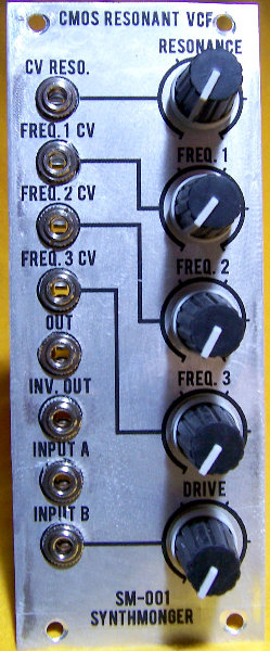

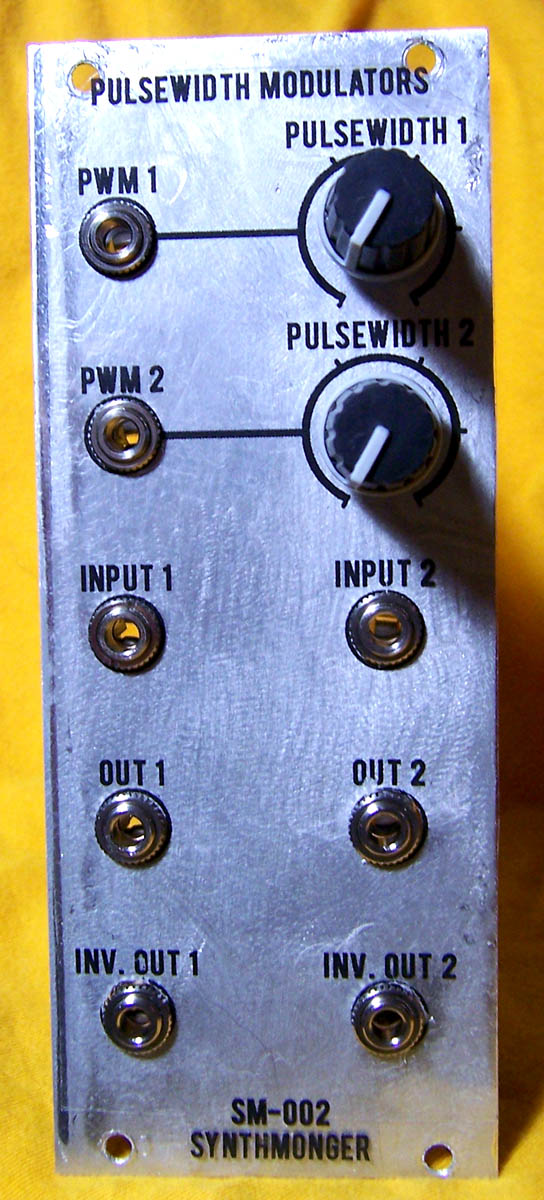

PostPosted: Tue Jun 02, 2009 1:33 am    Post subject: Reply with quote  Mark this post and the followings unread
bobo panels for now...
 Filesize:  139.27 KB
 Viewed:  228 Time(s)
 Filesize:  156.46 KB
 Viewed:  237 Time(s)

I actually really like those, Synthmonger... the unfinished look of the metal really makes it!

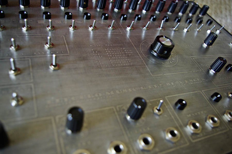

ghost letters Shocked
Rolling Eyes Very Happy
jean-louise
Joined: Apr 27, 2009
Posts: 73
Location: berlin
PostPosted: Tue Jun 02, 2009 11:28 am    Post subject: Reply with quote  Mark this post and the followings unread
ooops image is too big ???!§?" Embarassed
Posts: 24491
PostPosted: Tue Jun 02, 2009 12:22 pm    Post subject: Reply with quote  Mark this post and the followings unread
No, just click on it to see it full size.

Synthmonger, nice work. Is the ´pulse width modulator´circuit published on line somewhere? I´ve been looking for a simple dedicated circuit like this to add to various trigger and gate outputs for vc length. Would be great to have as a little add-on PCB.

I think it's this circuit from the Lunetta forum http://www.electro-music.com/forum/topic-33911.html
Yes it's that one. The 71K should be a trim pot though.

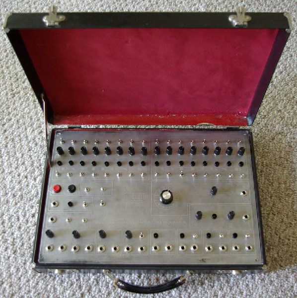

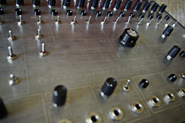

Finally found/made time to finish my Klee sequencer.
Klee in 'rescued' attache case.
 Filesize:  168.99 KB
 Viewed:  273 Time(s)
Klee attache panel
 Filesize:  98.69 KB
 Viewed:  251 Time(s)
