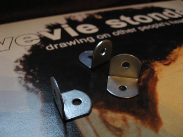

Hi, joiners/ carpenters at work usually have loads of these kitchen base unit wall fixings left over, they are 20mm X 20mm. i used loads on my MFOS modular

Ah i see, no bolts on the panel surface , yes , mines rough and ready Laughing
