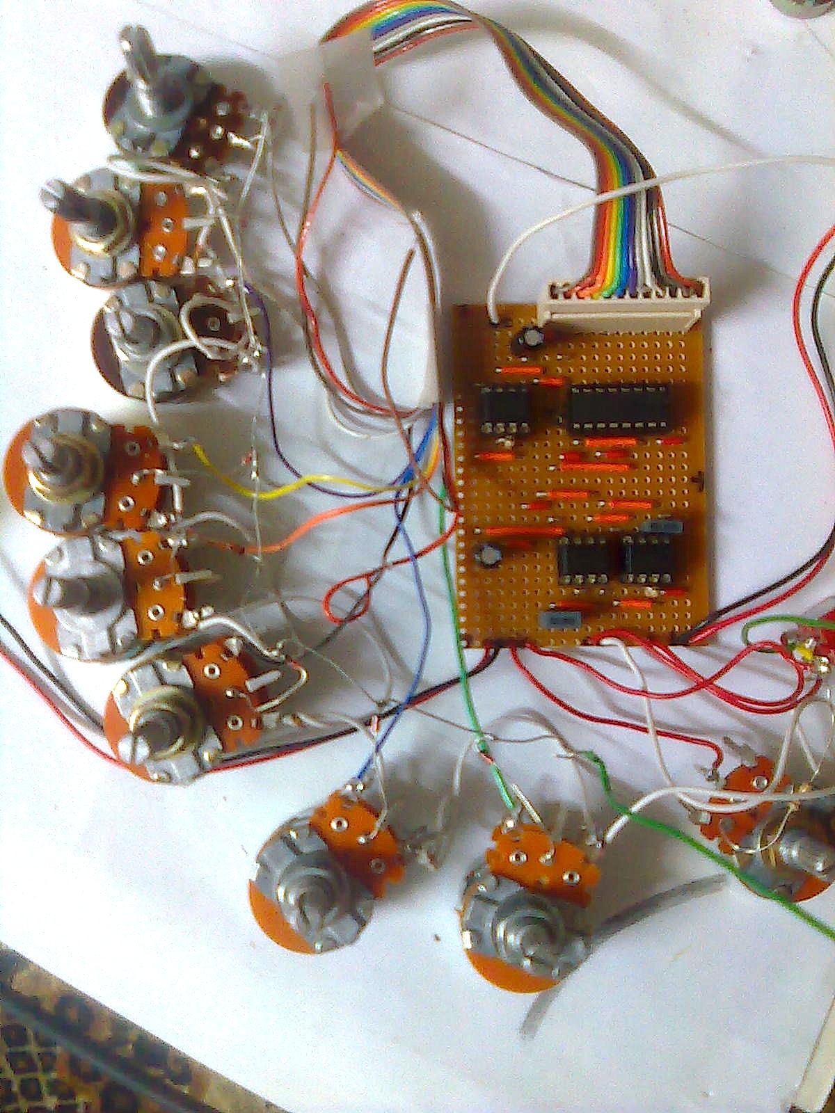

Airfrankenstein: I'm wondering if a power diode on your (+) power supply might stop this? But then again I'm a bit of a novice... maybe someone else might know?
I have just tried wiring the 500K and 1M pots differently. Not a big change... just took the wire going to the left tab and re-soldered it to the right tab. To me the pots seem to respond in reverse to what I'd think was logical. Now when I turn the 500K clockwise, the tone gets higher. And with the pulse rate on the 1M pot, when I turn it clockwise, the rate gets faster.
I still have the two thirds of the eight 100K pot unusable problem. About to experiment with 500K pots and 1M pots to see if I can push that unusable portion back to a bare minimum. Will post findings soon.

OK... The 500K pot didn't do much so I tried a 5K pot. Nope... There is a problem here. Why is the first two thirds (or more) of the pot blank in terms of sound??? Maybe a resistor along the (-) wire to the 8 pots might do it?

I'm experiencing the same frustration with the tone pots. you're right - there seems to be very little variation in pitch.
My pots too work kind of backwards, but for that moment I can live with that.

actually they affect the voltage. when I say lack of tonal variation I mean that Minus and myself find that a large portion of the pot has little effect on the pitch produced by this voltage variation. Sorry, I can't be much clearer than that as my terminology is pretty sloppy.
I don't know whether the limited influence of the pots is due to the pots themselves or to the apc. I'm in the process of modifying the sequencer once again to try it with another oscillator.

Now, the problems with the pots... I get no tone at all on the 8 step pots for about 2/3 of a clockwise turn. Still trying to remedy this somehow. The pots of the sequencer DO change the pitch! The switch does a lot to the tone too. One mode has distinctive stepped notes; the other has those punk console crackles. I hooked up a TR808 kick drum stripboard to it last night and got it triggering that too. I've got sidetracked with other projects. Just stripboarded a Cacophonator and painting the enclosure for that. I'll be drawing that up and posting it soon. Love the Cacophonator!
Ok, pics. Still not in a box. Deciding on that still. I've got a plastic skull here with the cranium chopped off. Was thinking of putting it in that. The other idea I had was going steam-punk with it... Wood and brass levers...
I don't have a camera otherwise I'd post a photo! I could take some photo's on my phone, but they won't be very great resolution.

PostPosted: Wed Feb 10, 2010 11:14 am    Post subject: Reply with quote  Mark this post and the followings unread
Here's a photo of the guts taken with a phone... I used one of those connectors for the 4017 output wires to try and contain a messy cable situation. Those 12 pin plugs are fiddly to wire up though...
 Filesize:  476.95 KB
 Viewed:  557 Time(s)
