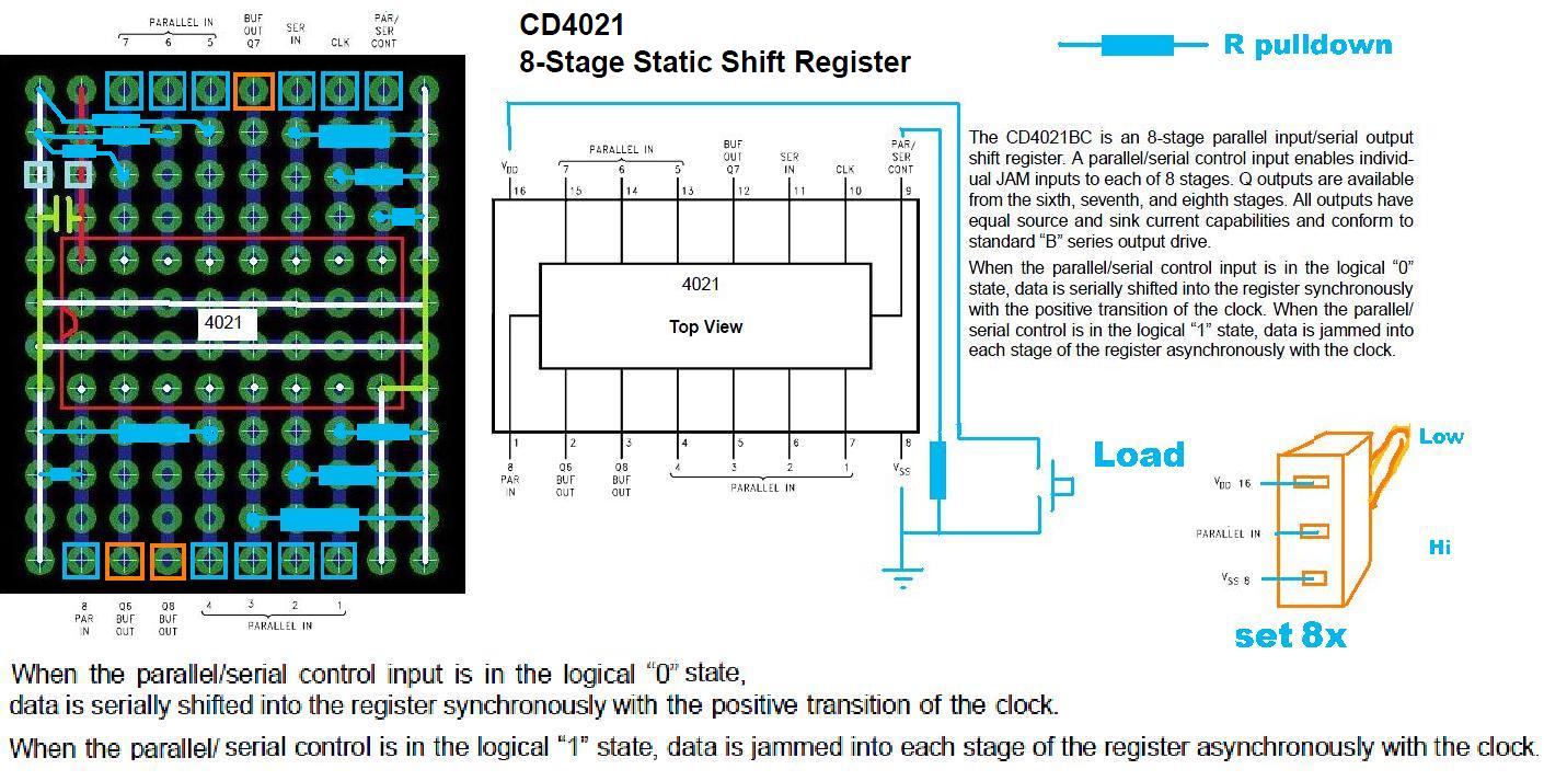

PostPosted: Tue Feb 23, 2010 4:40 am    Post subject: 4021 8-stage static shift register Reply with quote  Mark this post and the followings unread
It's all in the datasheets, not exactly rocket science. But ok, one more then.
 Filesize:  185.24 KB
 Viewed:  790 Time(s)
This is what it looks like. Notice the painstakingly measured matching pulldown resistors :) . Two pulldowns had to share a hole in the upper left corner.
 Filesize:  2.45 MB
 Viewed:  467 Time(s)
