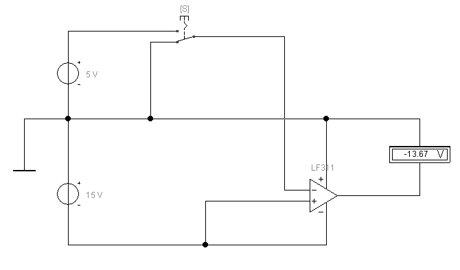

PostPosted: Fri May 14, 2010 2:34 am    Post subject: Reply with quote  Mark this post and the followings unread
the problem i face for external trigger in is the power supply of the rhythm ace. the unit gets powered by -15V to GND.
i tried a little bit with a comparator to convert an incoming trigger/gate to -15 to 0. this is what i came up with so far: i use a comparator IC powered from -15V to GND. in this simple spice model it works, however there are two major problems right now:
1st) the output of the comparator swings from -13.7V to -1.3V only. i am using a LF311 in this spice model.
2nd) i fear i will run into problems as soon as i add resistors to the comparators inputs. will i have to use matched resistors?
how could this be improved? maybe the rhythm ace is fine with that, however i would try to solve this problem.

PostPosted: Fri May 14, 2010 4:24 am    Post subject: Reply with quote  Mark this post and the followings unread
I was thinking to do it with a single PNP and four resistors ... my ASCII art does not seem to work ... here it is anyway

PostPosted: Fri May 14, 2010 4:47 am    Post subject: Reply with quote  Mark this post and the followings unread
thank you for your reply, jan.
however, i don't have a positive rail in the rhythm ace, just -15V and GND. and i need a rising edge from -15V to GND.
maybe i will have to build a dedicated I/O module in my modular Shocked

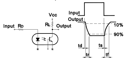

hmm .. opto coupler maybe?
PostPosted: Fri May 14, 2010 5:03 am    Post subject: Reply with quote  Mark this post and the followings unread
you mean something along these lines, with Vcc = -15V?
[edit: spelling]
Posts: 24119
Audio files: 279
PostPosted: Fri May 14, 2010 5:10 am    Post subject: Reply with quote  Mark this post and the followings unread
Yes, except Vcc would be connected to ground and the emitter of the photo transistor to -15V. No light would mean zero volts out, light would mean a negative value of up to -15V.
PostPosted: Fri May 14, 2010 5:38 am    Post subject: Reply with quote  Mark this post and the followings unread
but i need it just the other way around: light = 0V, no light = -15V. Very Happy
