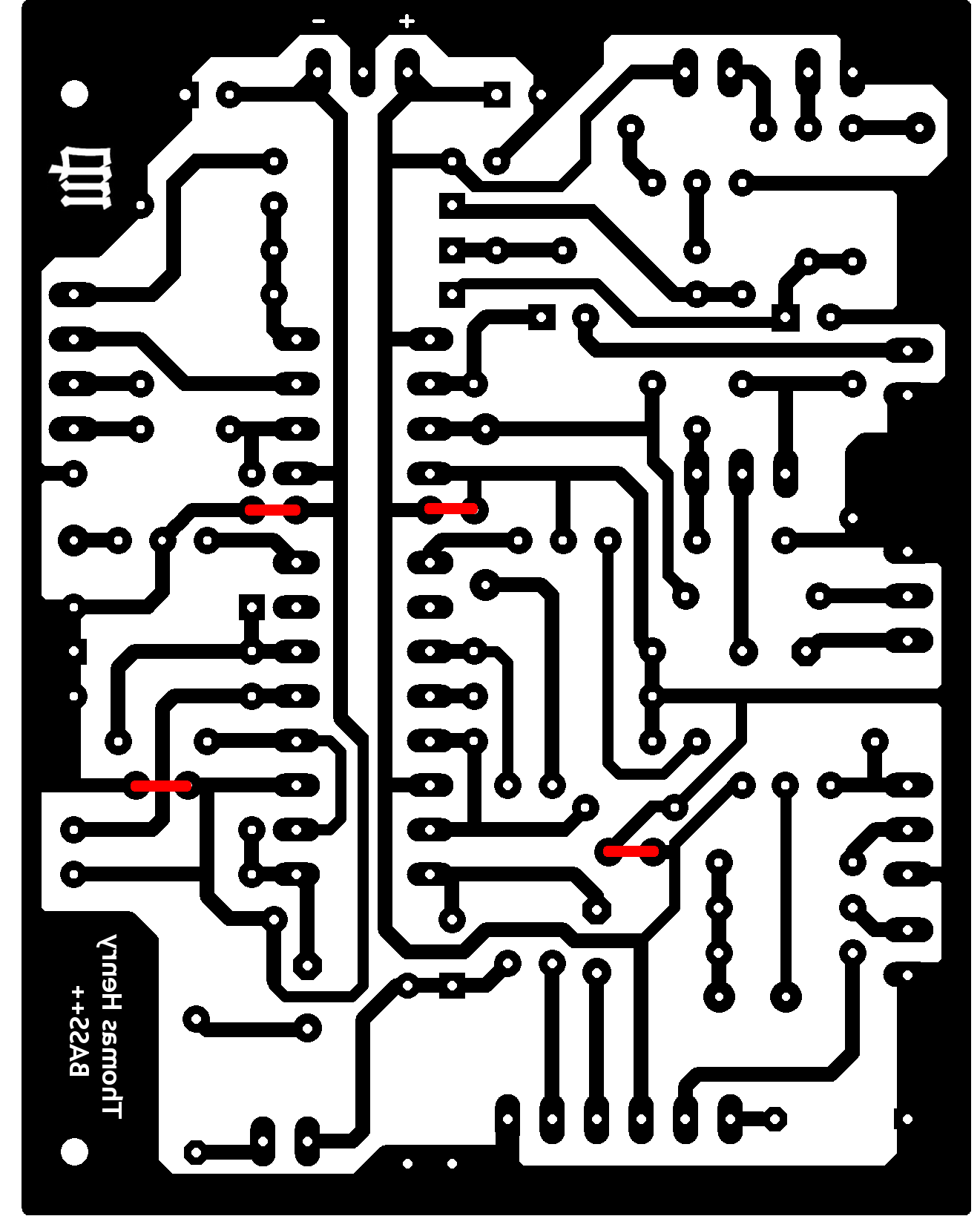

Hey guys!
I've been trying to design a pcb for just a single Bass++ voice (the electronic peasent version). I've been using the free version of Eagle and the small size board they allow you is making it almost impossible! Has anyone laid one of these out? Doesn't have to be the EP version. Thanks!

PostPosted: Thu Nov 11, 2010 6:28 am    Post subject: Reply with quote  Mark this post and the followings unread
hey!
i already did one...
the first version is based on the original schemo...
the second consist the waveshaper function from EP.
i used eagle.
not the best design, but working:)
i can share if it's not problem...

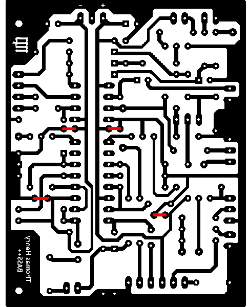

PostPosted: Thu Nov 11, 2010 2:57 pm    Post subject: Reply with quote  Mark this post and the followings unread
thank you guys!
i will post the details soon.

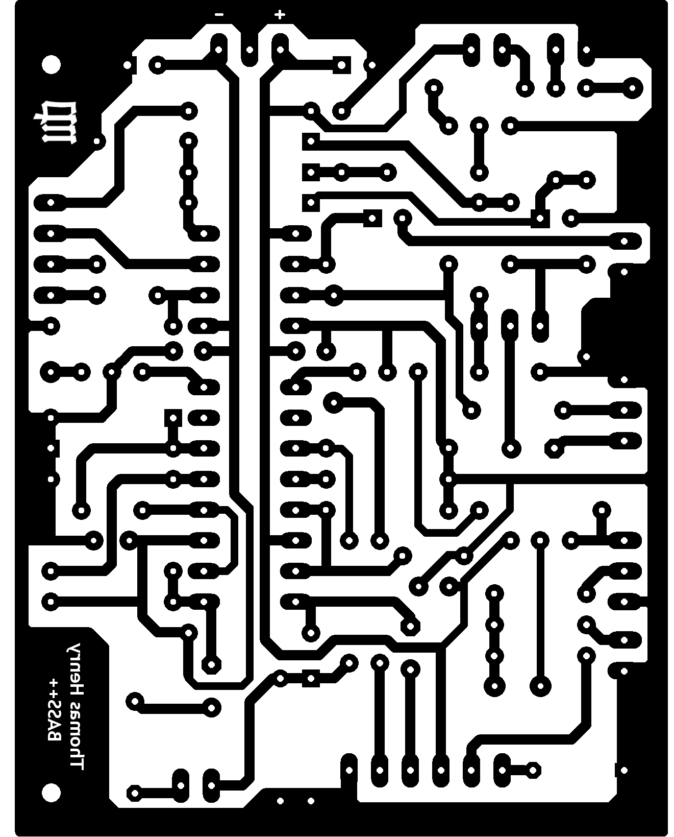

i made this layout in the board editor,
because i always have some problem with the autorouter...
after that i used Gimp for the makeup:)
there is 3 jumpers.
maybe there is some error in the names...
i will double check the file and upload
if it's not problem for Bill and Thomas.
i planning to make another version with sweep decay,
because i don't like so much the EG now.
i looking for some more controllable bass drum sound.
now i use XRVCO, Ian Fritz Dual AD/AR, MFOS VCA and Wasp filter
to create my funny HardBass Sound:)
sorry for my english...too much beer in the past:)

PostPosted: Tue May 03, 2011 12:51 am    Post subject: Reply with quote  Mark this post and the followings unread
Thanx PickNick, your PCB looks nice. I have also drawn one with Inkscape on GNU/Linux as my first PCB artwork, but I don't have C3-C6, I don't understand where to install it.
Is it not relevant to install C3-C6?
On mine I have obtained shorter jumpers, a on-board mod to put double and triple C2 capacity for a switch to obtain standard, bass and sub-bass sounds. I have tried to put an audio input and injected noises and shimmers to try to create snares and others metallic sounds, but without positive results.
I like so much to feed the BASS++ output to a waveshaper or a bit-cruncher and then into a vcf for obtain funny drum sounds.
Now I'm very curios to understand the C3-C6 function and location ...and to try the WAVE mod.
I have found my PDF file... Please don't laugh at me because this is my very first time for a PCB Artwork.

PostPosted: Tue May 03, 2011 3:27 am    Post subject: Reply with quote  Mark this post and the followings unread
hey all!
sorry for the long delay.
i didnt check the whole pcb yet...
some parts name are mislabeled after i added the wave mod.
but inlifeindeath already built it...so i hope its works.
good luck with it!

If I may interject:
C3,4,5,6 are 0.01 uF ceramic disk bypass capacitors that mount close to the power pins of IC 1 and 2. They are not shown on the schematic but, instead, are included as a note in the original TH schematic. I don't see these capacitors on any of the layouts just to give a heads up Wink
Bill

PostPosted: Wed May 11, 2011 2:22 pm    Post subject: Reply with quote  Mark this post and the followings unread
oops! yeah, i meant to add that i added .1uf ceramics by the IC power pins
Posts: 2807
PostPosted: Wed May 11, 2011 4:03 pm    Post subject: Reply with quote  Mark this post and the followings unread
Easy to miss but we caught it before you committed Wink
Have fun!
Bill

PostPosted: Sat May 14, 2011 2:15 pm    Post subject: Reply with quote  Mark this post and the followings unread
oops...
i did some changes,
and i uploaded again the new pcb file.
here it is the 4 ceramic caps places.
i hope its close enough to the ICs.
i did it gimp...so i don't have an updated doc file.

PostPosted: Sat Nov 24, 2012 3:25 pm    Post subject: Reply with quote  Mark this post and the followings unread
hi all!
i made a new documentation for the single-side Bass++.
you have to connect the A-A, B-B and D-D pads.
i left the C12 elko...you have to install between the Impact Tone-Impact Volume pots.
use the original and Electronic Peasant
schematic to find the right part values.
i hope the part names now are ok!
pls let me know if you find some error.
Peter

Hi guys hi PickNick
thanks for your pcb layout i want try to build it , will work fine ?
which is the value of C18 ?
thanks

PostPosted: Sun Jun 23, 2013 2:03 am    Post subject: Reply with quote  Mark this post and the followings unread
hi paulstone!
yes, it works.
C18=C12 2.2uF
pls follow the schematic!

Hi PickNick
sorry if disturb again
i realised that there is many errors between the schematic in the first post and your layout , so i'm much confused Smile
please have you the schematic update of your layout to share ? .
if schematic update no exist , even the pcb top layout with cap and resistor value can help me a lot .
