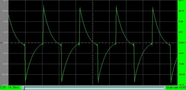

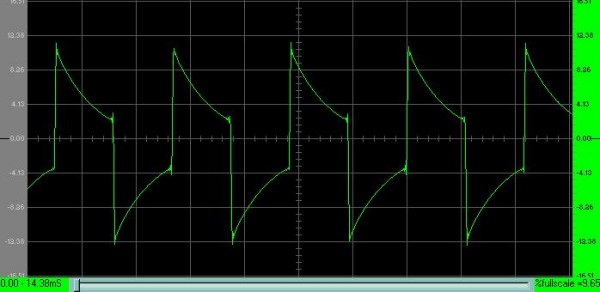

Look at those square waveforms, they look all different. The one I would like to copy is produced by the Studio Electronics ATC-1, an analog device. I tried different ways, with shapers modulated by the square, but it's far from that sweet and powerful analog sound. Varice's classic VCO style multi waveform Oscillator Bank is the best tool I found, to build such a waveform from a visual point of view (especially the variation number 2) but the sound isn't as beautiful as the analog one.
If you have ny idea....
Thank you
Xavier

The ATC and Predator images that you posted look like square waves being fed through a high pass filter with a relatively high cutoff frequency.
To reproduce that ATC waveshape in the G2, you need to start with a square wave and then add a HPF at some point before the output module. The resulting waveshape will depend on the frequency (pitch) of the square wave, the cutoff frequency of the HPF, and the cutoff slope of the HPF (6dB, 12dB, etc.).
By the way, the CEM Osc Bank building block patch already has a 6dB/octave HPF in the FX Area named “DC Block”. You can adjust the cutoff frequency and slope with the square (pulse) wave selected until it resembles the ATC waveshape.

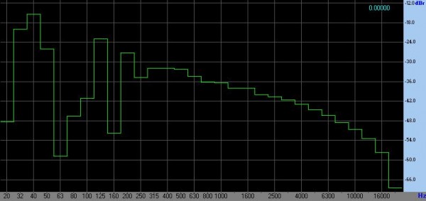

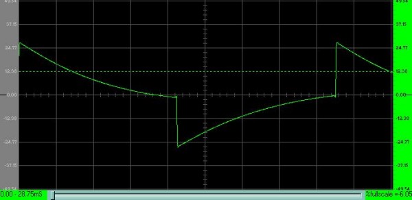

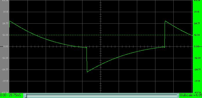

It looks like the G2 patch waveshape needs more tweaking. The scope reveals that the curve of the wave is a little more aggressive compared to the ATC. If you have the G2 CEM HPF slope set to 12dB, try 6dB instead. You may need to adjust the HPF cutoff frequency also. The spectrum also reveals that the G2 CEM has a weaker fundamental frequency (about -3dB) versus harmonics when compared to the ATC spectrum.
ian-s wrote:
… I notice that the G2 and ATC samples have slightly different duty cycles. The G2 is 50:50 (easy for dsp) while the ATC is (as best I can measure) 49.8:50.2
If you are using a SHPB oscillator, try adding a very small constant offset (maybe via a mixer input) to the Shape input.
Ian mentions a very important point. The duty cycle of the two synth waves need to be as close as possible. The scope shows that the duty cycles are close, but the spectrum of the ATC reveals that there is a stronger second (even) harmonic at about 80Hz compared to the G2 CEM. This could be the result of the ATC wave not being perfectly square with a 50/50 duty cycle. A perfect square wave will have predominately odd harmonics with very little even harmonics. Even the slightest change in duty cycle will cause a noticeable difference in the timbre of the wave. The CEM block patch has a “P Width” shape control that you can use to adjust the pulse width (duty cycle).
I don’t understand what you mean when you say that the ATC-1 square wave sounds “wide”. That seems to me to refer to a stereo effect. This synth has a mono output, correct?

PostPosted: Sat Feb 11, 2012 3:20 pm    Post subject: Reply with quote  Mark this post and the followings unread
xav wrote:
varice wrote:
xav wrote:
Here are the wav files...
These wave files are much better Exclamation
So different? I'm used to listen to mp3...
In my opinion, an mp3 recording is OK for casual listening, but for critical listening (or sound analysis) I prefer 16bit/44.1kHz or better digital recordings. Wink
varice wrote:
xav wrote:
...it's interesting to visualize a 5 seconds waveform. It reveals slow modulations not noticeable in one cycle...
In the ATC wave? Are you sure that you have all modulation sources at zero?
Yes: no modulation... wouldn't be the analog lack of precision?
Yes, that could be an imperfection that adds to the “charm” of analog synths. Very Happy
xav wrote:
I understand and will try more HPF settings... it's actually a 6db. But how can I change the fundamental frequency?...
You may have the CEM block HPF cutoff frequency set too high, that will reduce the level of the fundamental. Try a lower freq setting. Using the G2 Demo software, I got the CEM block waveshape closer with a 6dB HPF set to 29.1Hz. But you need to set this value lower using your G2 synth because there is in effect a 6dB HPF (DC blocking cap) already built into the output of the G2 (as there obliviously is in the ATC-1 also). In fact, the whole reason that we are going through this G2 HPF exercise may be because the ATC-1 apparently has a smaller value DC blocking cap than the G2, which is causing the ATC-1 square wave to exhibit the higher HPF cutoff shape that it has.
Something I didn’t mention in my previous reply: the ATC spectrum confirms the slight roll off of high frequencies that I mentioned hearing earlier when compared to the CEM spectrum. The stronger fundamental along with the HF roll off might be why you describe the ATC-1 square as sounding smoother than the G2. I would recommend trying the G2 EQ modules to tweak the sound a little more closely.
xav wrote:
...The spectrum is a great tool i should use...
Our ears are good at perceiving the differences when comparing sounds, but it is not always apparent *why* the sounds are different. A scope and a spectrum analyzer are good tools to help reveal the reasons.
xav wrote:
varice wrote:
Alright, I understand now the duty cycle... it is the Pulse width, isn't it? I tried to reach the "perfect square". It is nothing but perfect in comparison with the original G2... or the real perfect Ableton Analog square.
I tuned the Pulse Width by ear. The graduation is from 0 to 127, and the value that gives me the sensation to be between 2 identical states is 58. All the other values seem to give more even harmonics (or more harmonics). It seems even more difficult to imitates the wave of the ATC in other pulse width values.
The P Width control might be too course. You can get finer control around the 50/50 duty cycle by reducing the shape modulation input control of the Pulse osc module.

varice wrote:
It seems to me that the ATC recording has a little bit of high frequency roll off compared to the CEM + HPF. Maybe some LPF treatment in the G2 patch would help.
Right Varice. I tried with a 6db LPF at 8k, and the waves were more similar, especially by ears. And I tried with Rob Tilt Filter, and it's fine too, maybe the best result for my ears... The oscilloscope shows a little deformation at the beginning of the wave (that tends to sinus), but it's more visual than audible.
And I also adjusted a little bit the HPF to conserve the fundamental, as tyou said.
I'm really happy with the result. Thank you for the advices... and for that fantastic patch.
