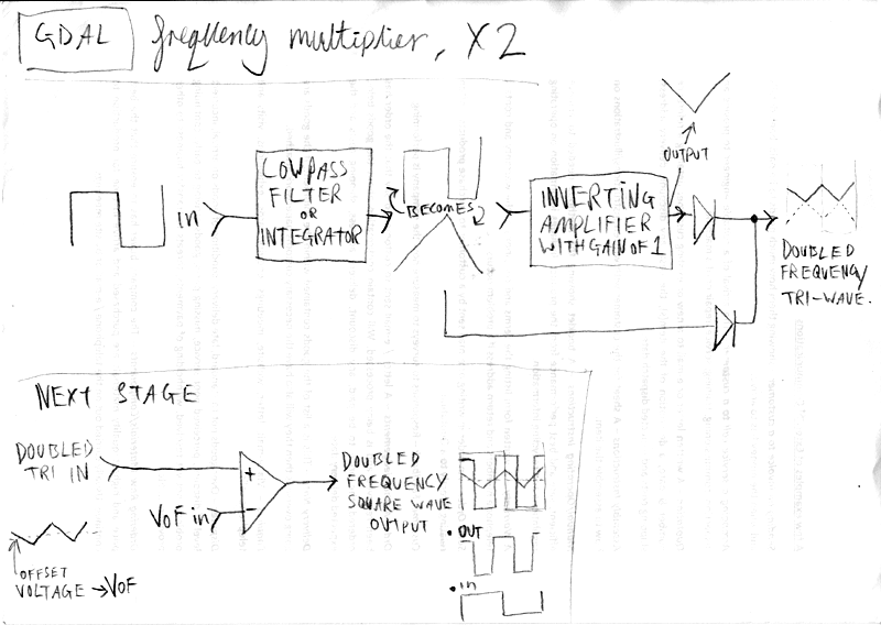

Some chaps inquired about my frequency multiplier circuit so here is a basic block diagram which I sketched just now Smile
You will have to do some combobulation with circuitry but it should not be too hard.
I haven't tested this or even gone further than this diagram below but I came up with the concept one morning and have been mulling it over for a while. This has probably been done before but I am unaware of any prior circuits the same.
You could add a second stage to get frequency x4 then another one to get input frequency x8 and so on untill you go a bit over the top and make ten of these and then you're something like, what, 1024 times the input? Something like that.
The purpose of this circuit was to use it with a waveform creating device, however if the wavecreator had 8 steps, then the output frequency would be the input frequency/8 Confused no me gusta. So what one would do is multiply the input frequency by 8, then input that to the wave creating device Smile
The final output of my plan seems to be phase shifted a bit, but that should not be a problem when working with the ramshackle experiments over on the lunetta forum Wink

The problem with this circuit is that it's frequency dependent. But it would work on a triangle wave without the integrator. Also is an integrator not alowpass filter?
basically this is what's used in guitar octave up pedals... seems to be a full wave rectifier.

PLEASE DO NOT TAKE MY COMMENT AS A "DO NOT TRY THIS" FLAG.
It is not.
However, there are caveats to be noted, some have already been mentioned. Indeed - you will not really understand this until you try it and see what happens for yourself. (I've done pretty much what you've suggested). If the circuit/idea pleases you, then by all means use it.
Yes, I see the comment about "ramshackle Lunetta experiments". So it may well be exactly what you want. And as such, it might be best to put a post like this in the Lunetta forum - since that's where the OP seems to be directing it's use. Again - do not take this as negative. It is not.
The folded triangle wave for frequency doubling is a long used analog modular technique, but it is not without problems even when you start with a perfect triangle. DC bias in the waveform will create problems. The amplitude halving means you need to amplify and where there is amplification, there is also amplification of noise. One friend of mine who did this tried to set up a chain of them. After only 3 stages it became unusable due to noise and DC offset. His input was a good quality triangle wave VCO.
Generating a nice triangle wave from a square wave using an integrator is not easy if you want wide frequency range. The reason is that an integrator is going to act as a lowpass filter, not as a linear slope generator. If the integrator's time constant is fixed, then so is it's cutoff frequency. Input signals above the cutoff will be attenuated, and those that are too far below the cutoff will not be very close to a triangle, more like a square wave with rounded lead-in shoulders. Also, an integrator will not give a triangle, rather it will give something kind of like a cross between sine and square. Of course, you can play folding games with a sine, but with possibly dubious results. The design will probably work to make sound that has an enhanced second harmonic and the amount of 2nd harmonic will vary with input frequency. Again - this may be ok or even desired. The best way to discover this is to punch it down onto a solderless breadboard and see what happens on an oscope. (been there).
Since this is here in the general DIY forum, I'd like to suggest that another way to get frequency multiplying (and of more than just x2) is to use the venerable 4046 PLL which can track a seriously wide range of audio frequencies. To get frequency multiplication from a PLL, one puts a digital divider into the feedback loop of the PLL. If you use divide by 2 (a simple thing) then the PLL will output a signal at 2x the input frequency. If you use a divide by 3 circuit, then the PLL will triple the frequency. I've used a PLL to do as high as x12 multiplication. It will track more than 5 octaves.
The bottom line here is - Try it. You may encounter "problems" that don't matter to you. Or you may decide it really doesn't do what you want. The proof is in the scoping and in the listening.
In fact, in the long run, you will find that using a PLL will likely result in a simpler system using fewer parts.

Damnit phobos Razz I had work to do today and those videos just stole a huge chunk of my time! Thanks though, they are brilliant, I will watch the rest later Smile
JovianPyx, thanks for the tips Smile I'd taken a lot of what you said into consideration, however I didn't think signal size would be a problem, I often use a comparator to generate a square wave from less than 1V saw waves, so the signal halving should be no problem.
Also with some simple op amp circuits (like summing amplifiers and differential amplifiers) or perhaps even just a capacitor to remove offset ,you can get the offset of the resulting triangle wave to something suitable for your operation. Then simply use a comparator to make it square. This should eliminate DC offset problems.
As for frequency response I knew that would be a problem but one should be able to tune the filter in to about 3 octaves of usable range, maybe add other tuned filters via a switch for different ranges. Cutoff is 1/2piRC, right? Wink
Also I just thought, you could invert and re-combine the resulting triangle wave from the above circuit, without turning it back into a square wave between each stage, for the next 4x input frequency stage.
Then taking that to 8x should be no problem.
Lastly, to avoid trouble with noise I'd say shield the circuit better, avoid amplification and filter signals Smile I never thought noise would be a problem.

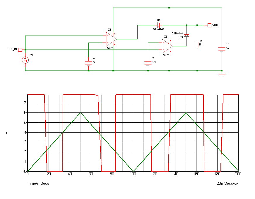

Yup, the comparator based frequency multiplier works Smile but only for one frequency if an integrator is used to make the triangle wave from a square wave. It would work over a small range but with differing pulse width, an added "feature" I think Smile
The inputs to one of the comparators are swapped around to get the inverted pulse.
A sawtooth waveform would work too.
To get this to work with different frequencies use a triangle/saw waveform with stable peak-to-peak voltage from a VCO or something.
By the way! I meant to say; that PLL method looks very good JovianPyx, however I have had trouble understanding PLLs. So I will shelve that one for now unless you want to go into detail Smile
