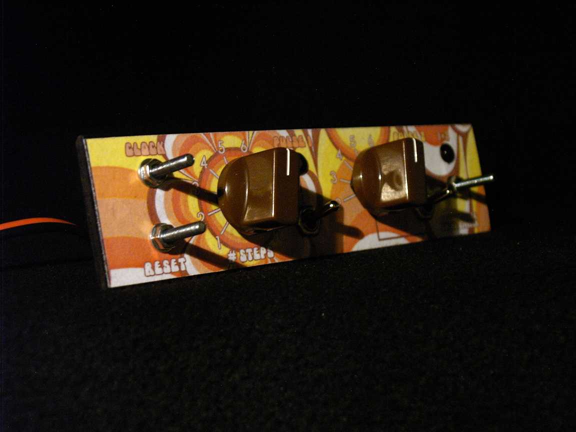

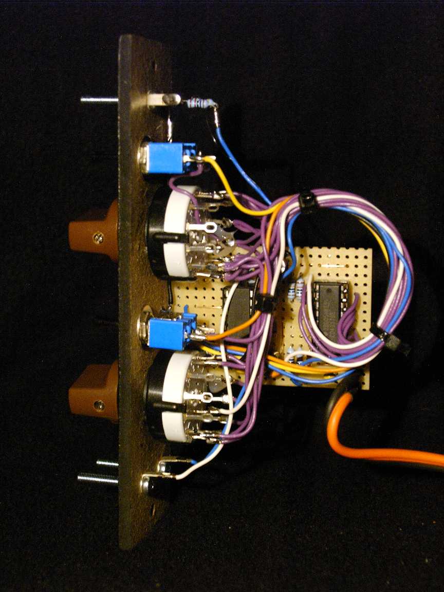

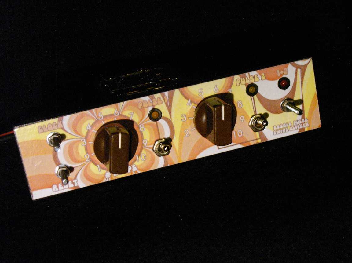

PostPosted: Sat Oct 18, 2014 3:31 pm    Post subject: Reply with quote  Mark this post and the followings unread
I got the knobs so here's what the module looks like.
The reset seems to be a bit over sensitive in that it picks up noise when I attach a cable to it. Shocked
Maybe increasing the value of the pulse capacitor will help, or a smaller resistor on the base of the transistor.
