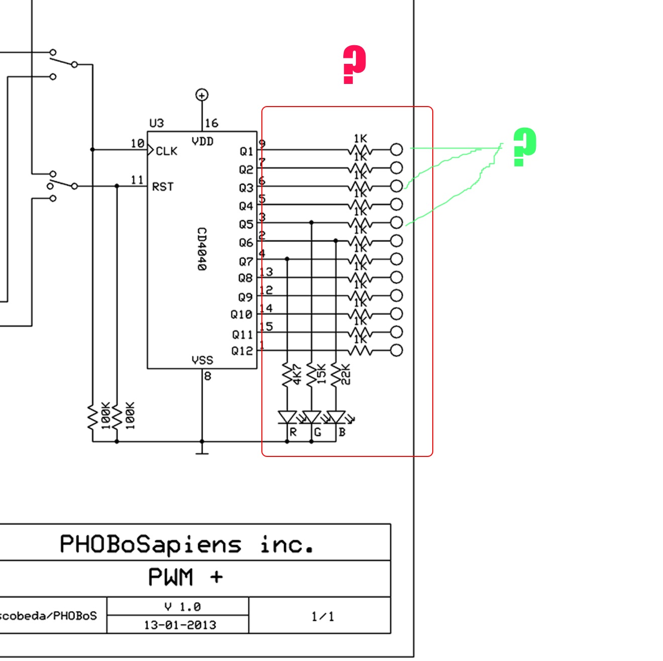

PostPosted: Sat Mar 28, 2015 4:34 am    Post subject: q Reply with quote  Mark this post and the followings unread
im not sure I get what is going on here (see photo-section marked in green and red)-it looks sorta like a resistor ladder but where id expect to see the output on one side and ground on the other it isnt set up that way.
Are you using it as an arpeggiator to send increasing voltages repeatedly? or to do DAC?(seems unlikely)
Also, the circles (if it was standard ladder) would be digital inputs (as per # of bits and n-bits )..but im thinking thats not the case here-so what are the circles ive marked in green?
Im sorry if these are stupid questions, im just curious and i honestly dont know the answers.

PostPosted: Sat Mar 28, 2015 6:12 am    Post subject: Re: q Reply with quote  Mark this post and the followings unread
The 1K resistors are just current limiting resistors to protect the outputs of the 4040 divider chip in case of a short.
I guess you could connect all the outputs together to create a voltage but that's not what they are intended for.
The circles are the connection-/patch points which in my case are M3 bolts.
I also have LEDs on all the outputs as can be seen in the updated schematic.
