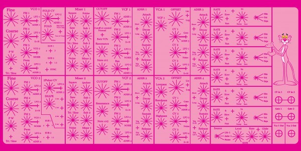

PostPosted: Sat Jul 06, 2013 10:34 am    Post subject: Reply with quote  Mark this post and the followings unread
Smile
Not sure which colour of vinyl will go with the dark grey, hmmm Smile
Dave.

PostPosted: Sat Jul 06, 2013 10:50 am    Post subject: Reply with quote  Mark this post and the followings unread
yes , i like the lilac / purple colour , but the orange is super easy to read the text , but i'll learn it real quick , looking like purple if the print shop has some Smile
Dave.

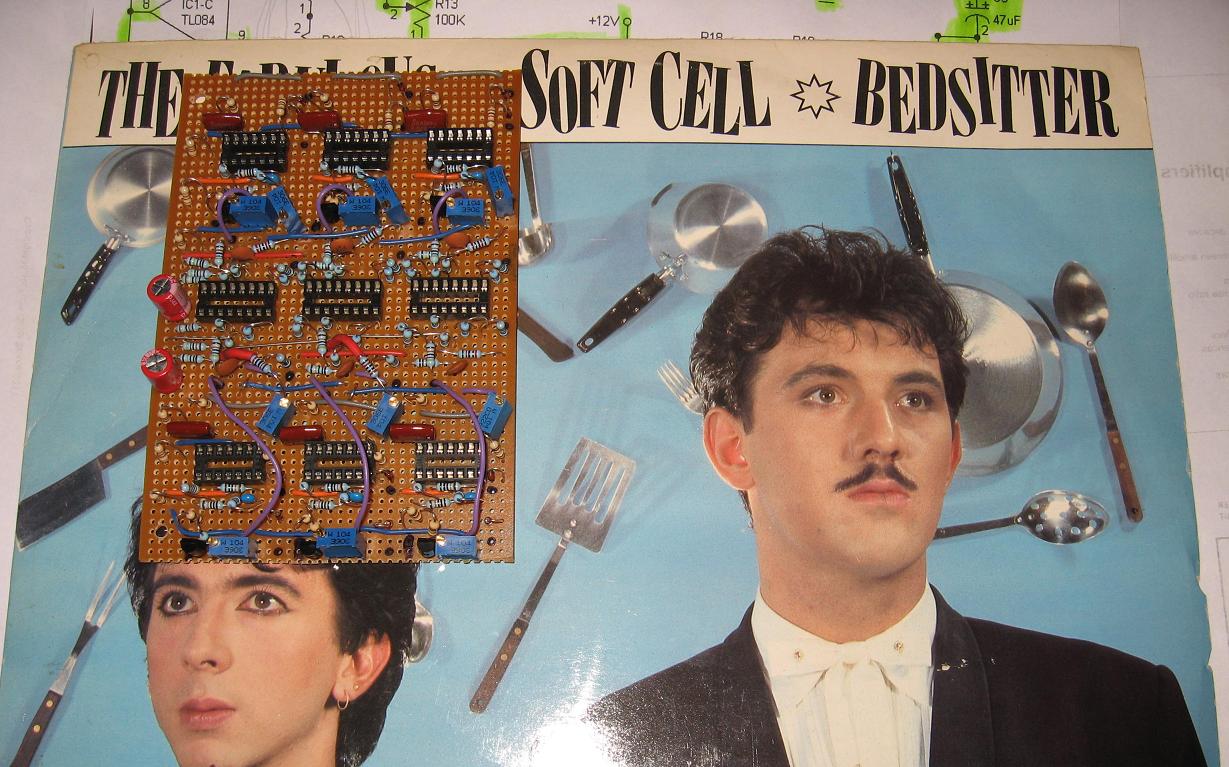

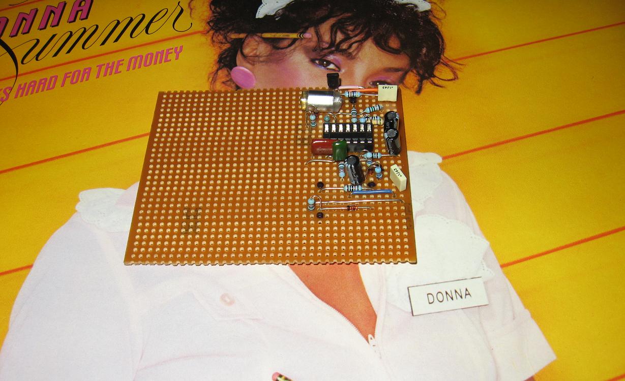

Hi ,
The 6 lfo's i have made on veroboard are from Ray's site under the oldies but goodies section , six of the "variable skew lfo" which outputs 3 main waves... sine / ramp - tri - saw (skew) / square.
I have made a few veroboard circuits and i now just follow the diagram and populate and isolate as i go and give it a good continuity test afterwards before the "no chip" power up test.
I have also started to the mfos micro S & H circuit which will have the lockhart wave folder & dividers on the same strip.
more in a week or so Smile
Dave.

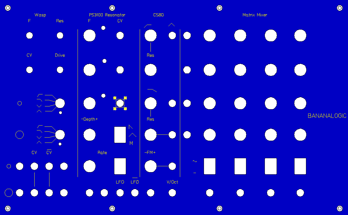

What filters are you going to use? I like a variation from the standard LPF. A SVF or a combined LP/HP such as the MOTM CS80, Ian Fritz Threeler? I have a CGS CMOS or Wasp style filter on the drawing board. Mine will have dual-concentric pots to control two filters from one(ish) set of controls. I got these from Small Bear.
http://soundcloud.com/for-mash-get-ash
Posts: 1199

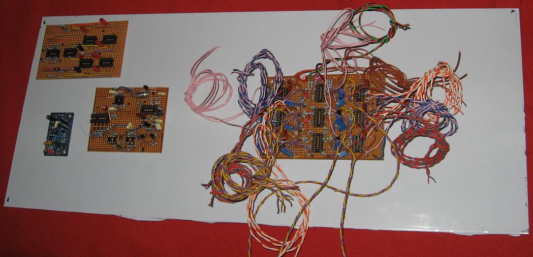

PostPosted: Fri Sep 06, 2013 10:21 am    Post subject: Reply with quote  Mark this post and the followings unread
Im slowly taking my time with this build , heh , ive rearranged the panel layout a bit to fit the FX i wanted on the panel, which is now 600mm long Wink , still in the final stage of "what can i put in that space" , i was thinking vc-panner or a externally clocked melodic/random trigger generator of some sort for the 4 ADSR's. Hmmm.
Dave.

ashleym
Joined: Aug 20, 2009
Posts: 181
Location: uk
PostPosted: Sun Sep 08, 2013 12:03 pm    Post subject: Reply with quote  Mark this post and the followings unread
[/img]
This is just a screen shot of my Shaeffer design. On the left is the Wasp filter. The small circles are for the dual-concentric knobs, below switches for filter type then the banana sockets. I colour co-ordinate; blue for in and yellow for out so I dont need to add any labels. The small and larger circles are to show which part of the control is for which or the 2 filters. I try to eliminate writing and use signs and colours to define functions. I need to work on some graphic icons to add to the layout to reduce the writing even more. Something as corny as a graphic for an envelope of an envelope!!
I hope this helps. or at least explains.
