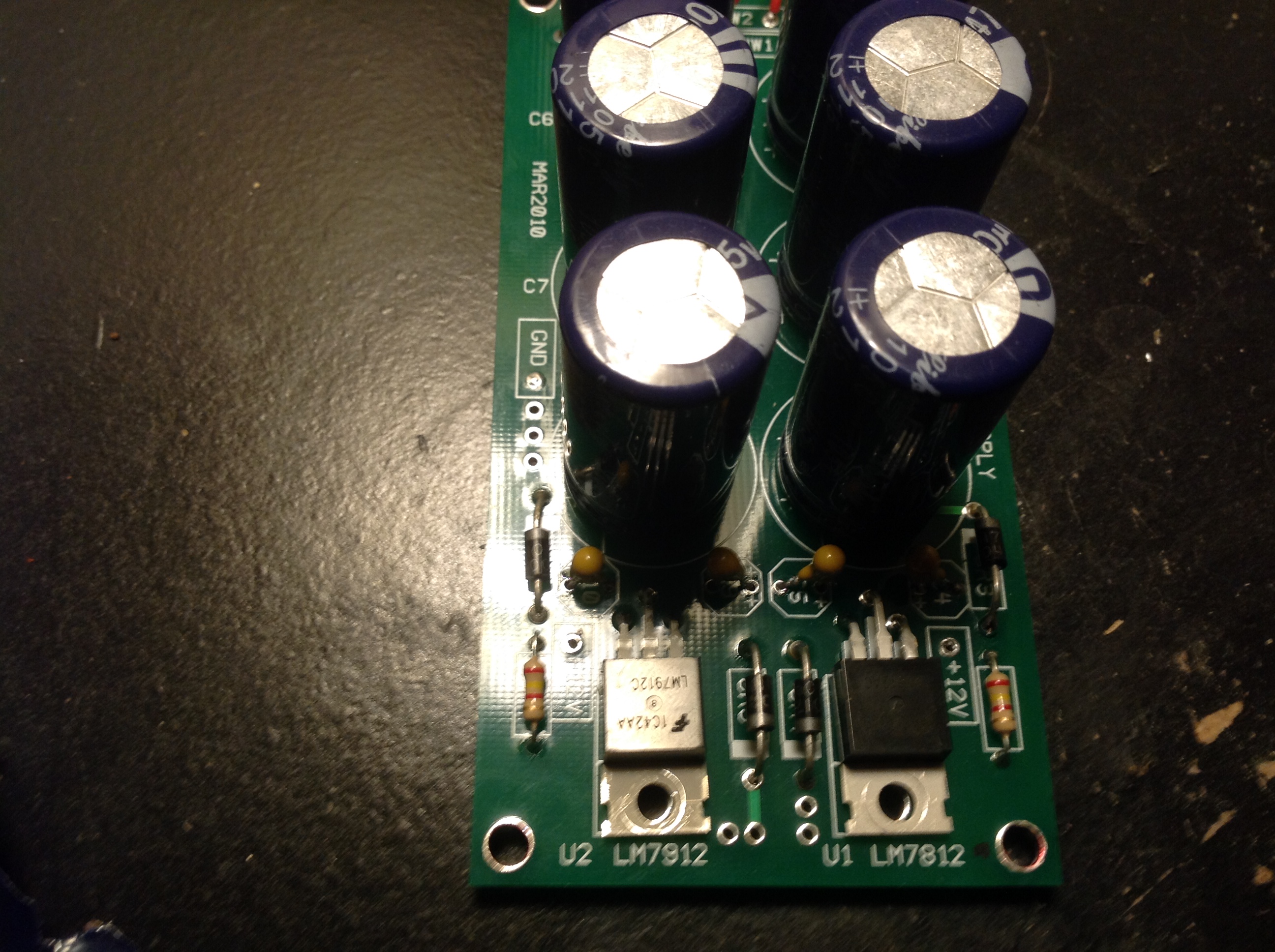

Greetings,
First post, I have to be abrupt with my first post (of many more) but here goes.....
First the Wall Wart Issue....
Got everything together, hooked up the (Jameco 120v AC 9w, Output 12Vac 500Ma to the populated PCB, No dice, found out I misoriented the small yellow caps (C10, C9, C5, C4 Respectively) No big deal just unsolder and reorient. Great, still no dice, check volt meter on wall wart leads, dead supply.
Ok so now time to try a different wall wart, this time it is one from an old Boston speaker system. Here are the specs (12vac 1500mA output) Ok great worked great for like 10 seconds and the led lit up on the 10-Step. But oh no, I see smoke coming from component CR1 (1N4004 General Purpose Rectifier) No good, disconnected and gave up on that for now. Is the Rectifier fried? Suggestions?
Uh yeah, magic smoke means dead components Smile Triple check whether you have any shorts on the PCB before you hook it up again. And replace the diode, and check again that all the diodes are oriented correctly.
If you used Tantalum caps and had them reversed, you need to just replace them, now. They do not necessarily fail immediately upon being reversed, but even after it's been corrected, they will still likely blow at some point in the future, and you DON'T want that. A guy I know has an amusing story about the purple burns on one of the EE Lab benches that involves re-using tantys that had been reversed. Amusing in that the only thing damaged was the bench, thankfully.
Personally, I would just use 1uF electrolytic caps.

PostPosted: Thu Jul 03, 2014 2:13 pm    Post subject: Reply with quote  Mark this post and the followings unread
As for the Sequencer
Was not grounding issues and still DOA.
As for the power supply.
I replaced the Diodes and the Caps and bought a new 3000mA 12v AC and junked the 500mA.
All caps/diodes were originally oriented correctly.... (so no fault there)
The problem was the high current from the BA Transformer fried the diodes.
So that was solved
