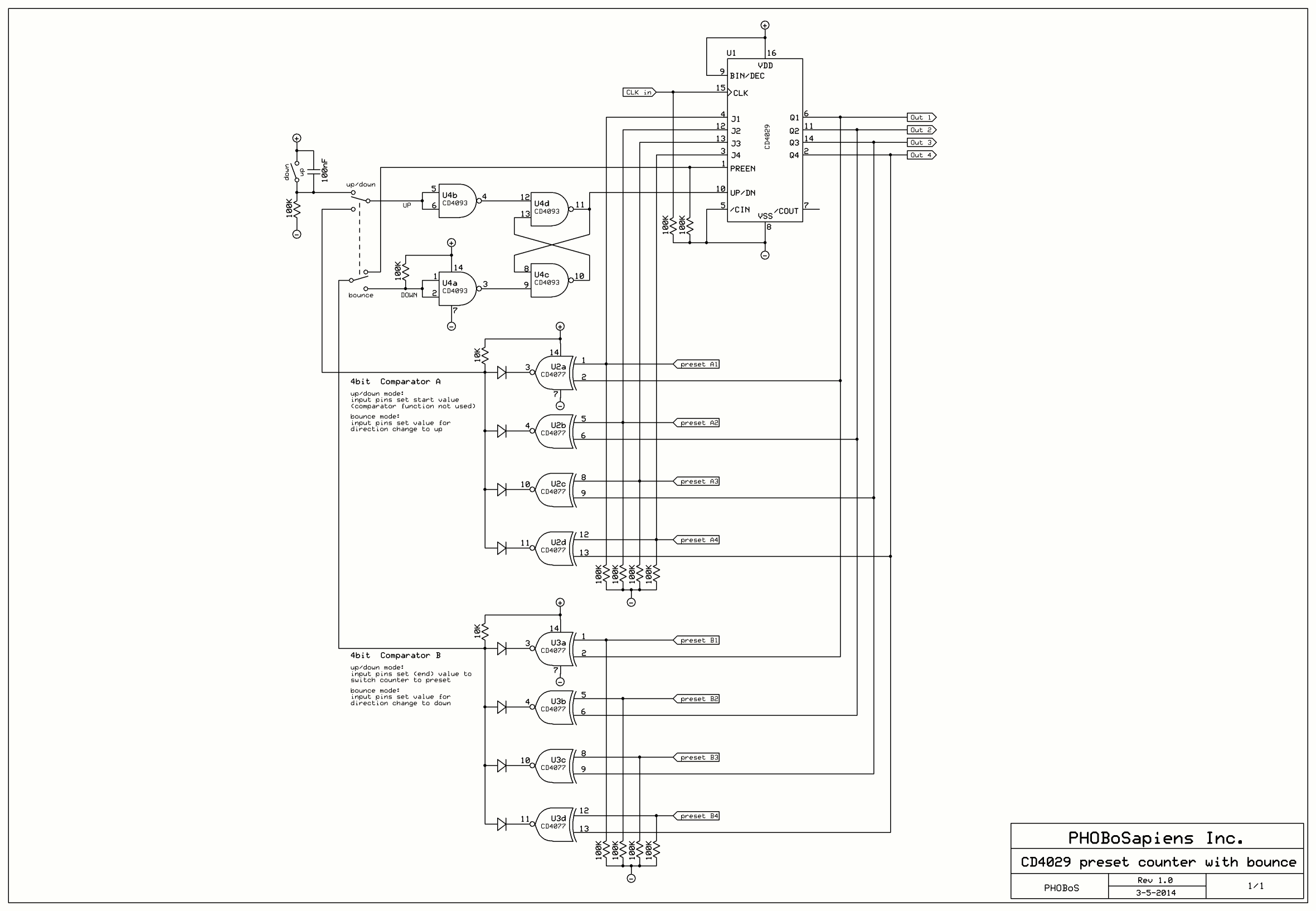

from this thread, about a CD4029 counter module.
elektrouwe wrote:
if you use a XNOR (4077) instead of the XOR(4077) and 4 diodes in wired-AND style you could probably us it as a logic comparator to generate a preset pulse. So you have 2 4bit inputs that define start & end value of the counter, right ? if this works, let us know. Smile
scratch Shocked
yep I think that works. If you make two of those comparator circuits (I like them already) connected to a flipflop controlling the up/down pin you
should be able to make it bounce between 2 set points. I'll do some tests.
So I did and combined the 2 functions into one circuit by adding some switches. For the preset inputs you could use jumpers, dipswitches,
toggleswitches, a rotaryswitch with diodes or a binary coded one and of course any digital signal aswell.

So I did and combined the 2 functions into one circuit ...
...within a couple of hours Smile yeah, ultrafast development, thanks Phobos!

So, I'm halfway through soldering up a 4029 to drive a 16-step sequencer, and now all this. Although, I suppose a bounce would be possible with my current design.. Patch start and end gates from the sequencer through an OR to a flipflop toggling the Up/Down.. yeah.
Not sure whether it would reliably bounce "internally" or "externally", if you know what I mean (between the start and end, or "around" them). Does this? I haven't thought it through.
With this circuit it depends on what you set as start/end values. If the start value (count up) is lower then the end value (count down) it will count
internally, if it's higher it will count externally. At least in bounce mode, in up/down mode it depends on the direction switch.
if you always want it to count 16 steps and bounce between steps 0 and 15 you can also use pin 7 of the 4029 as I did here.
