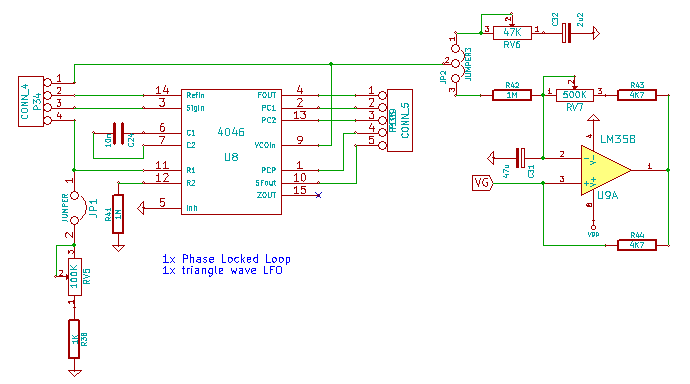

I'm really looking forward to this! Especially that pll schematic

PostPosted: Thu Aug 07, 2014 12:14 pm    Post subject: Reply with quote  Mark this post and the followings unread
Here it is, commathe. Nothing special, just the chip waiting to get the inputs to do something interesting. I will experiment with the 4046 once the board is done. VG = virtual ground = Vdd/2. The LFO is prepared to be connected the same way as in the 'Tune In Tokyo' circuit.
