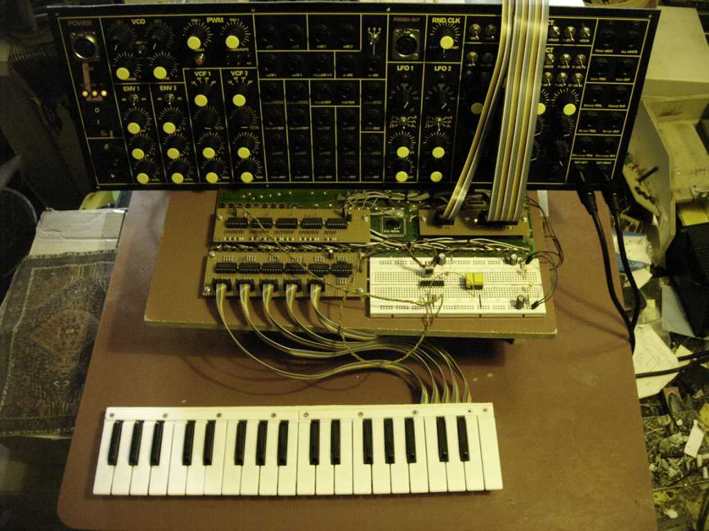

Here's an example of where I used that setup Wink:
