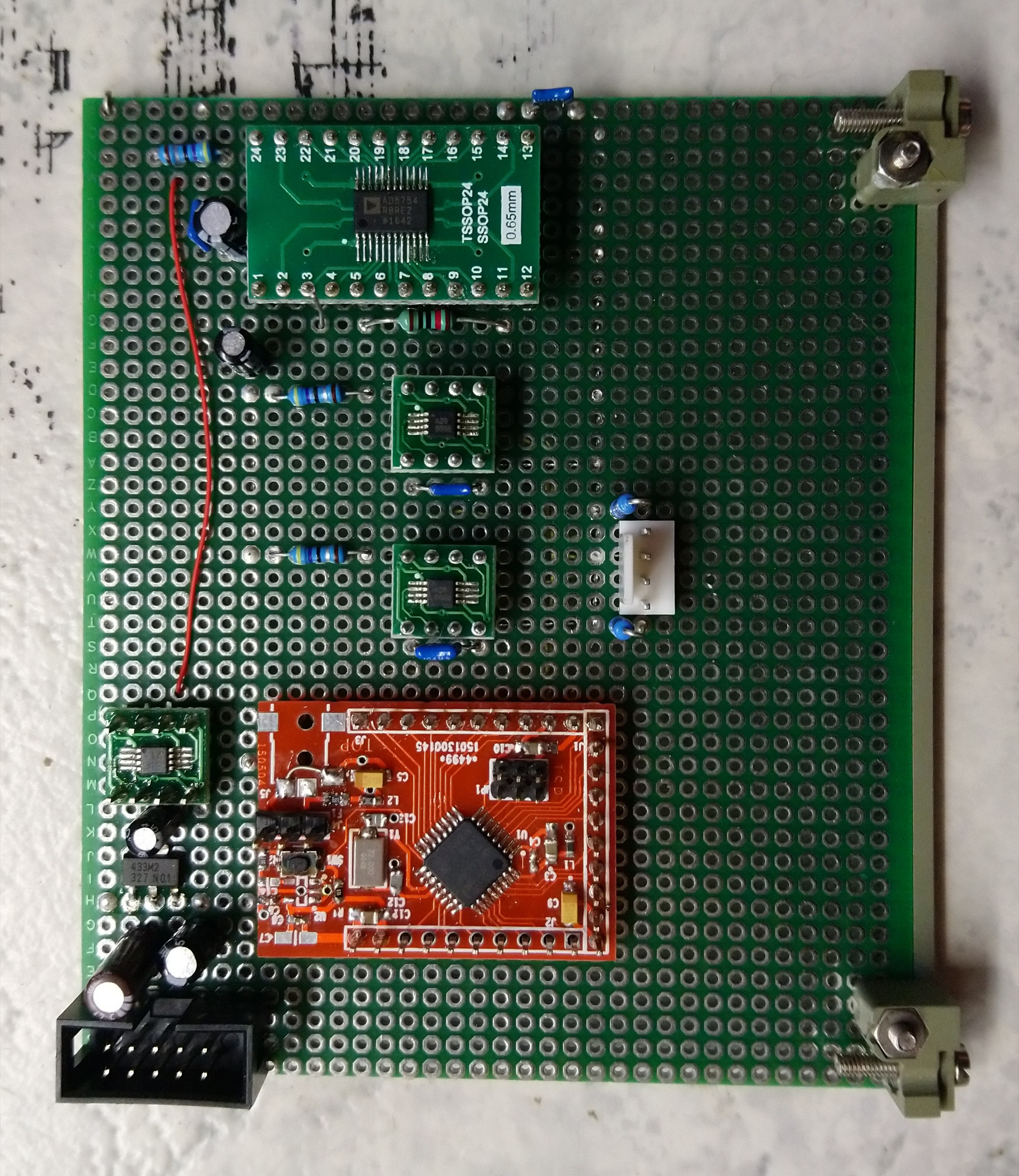

I know, there are some more projects in the pipeline, but I have shelved them for a while to have time to build this project.
It is something I wanted for a long time but never got to it, but after reading an explanation about the main part of this build I decided to build my own in my own way...
The center part is an AtxMega32E5 running at 32MHz and two 16bit ADC’s ADS8320 and an Analog Devices 4 channel 16bit DAC the AD5754 controlled with SPI bus at a 2MHz clockfrequency.
More to come... too much coffee
The board so far

Posts: 1299
PostPosted: Fri Dec 21, 2018 1:42 am    Post subject: Reply with quote  Mark this post and the followings unread
After seeing the threads about the appendage, designed by Scott Stites, I had to have one for myself badly enough to put all other projects on the shelf.
Especially when I read his Appendage Exposed document, got me on the move and proved to be invaluable for the design.
It needs some more serious programming but here is the first test:
https://youtu.be/D2mneJRPE5k

Posts: 1299
PostPosted: Fri Dec 21, 2018 3:48 am    Post subject: Reply with quote  Mark this post and the followings unread
In this video I use the initial voltage for setting the frequency of the vco, and the slide voltage for the vcf.

Posts: 1299
PostPosted: Sat Dec 22, 2018 3:38 am    Post subject: Reply with quote  Mark this post and the followings unread
Now I have 4 working analog voltages and 2 digital ones so far:
Initial, Slide, Bend and TFS plus a GATE and a TRIGGER too much coffee

Posts: 1299
PostPosted: Fri Jan 04, 2019 3:03 am    Post subject: Reply with quote  Mark this post and the followings unread
I have added midi to the uPendage
notes to the initial voltage, pitch bend to the bend voltage and mod wheel to the tfs voltage
https://youtu.be/WrWBbR084Dg
