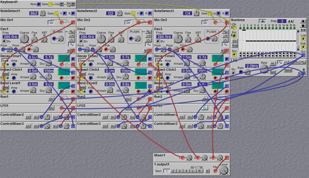

I am considering getting a second hand micro modular, but i need it for a very specific purpose and i'm not sure if the micro version will do. hopefully someone here can help me out.
I basically need to trigger a synth with my drum triggers and have three separate sounds for kick, snare, drumpad.. does anyone know if this is possible with the micromodular.. i know this is possible with the original and rack version, as it can play 4 patches at the same time, but as the individual sounds only need to be made with one oscillator each, no effects (just lfo and basic sequencer), was thinking it could maybe be done within one patch...
put in another way, could the micro could run three separate oscillators triggered by three separate notes, eg. note c plays osc1, note d plays osc2, note e plays osc3? and is it possible to put a sequencer on one oscillator, but not the others?
If anyone can help me with this that would be great, as I desperately need to get a backup solution for an old quite unstable synth for upcoming gigs.

... put in another way, could the micro could run three separate oscillators triggered by three separate notes, eg. note c plays osc1, note d plays osc2, note e plays osc3? and is it possible to put a sequencer on one oscillator, but not the others?
In one word: YES! Just use the NoteDetector!
I'll come up with an example.
Wout

Cool, so is the micro modular powerful enough to play three oscillators at the same time with three different notes? Was reading that it has issues with polyphony on complex patches, and obviously it's not multitimbral...

An example, less then 33%, so three voices possible on the Micro, otherwise a new note will silence the other voice.
The Master module is for controlling the slaves by the Sequencer. (Don't forget to disable the KeyBoard control)
Wout

Just connect the Clock Input of the Sequencer with the Logic Out of the NoteDetector3 and forget about the Clock and the Divider modules.
Every hit on the E4 key will result in one step in the Sequencer.

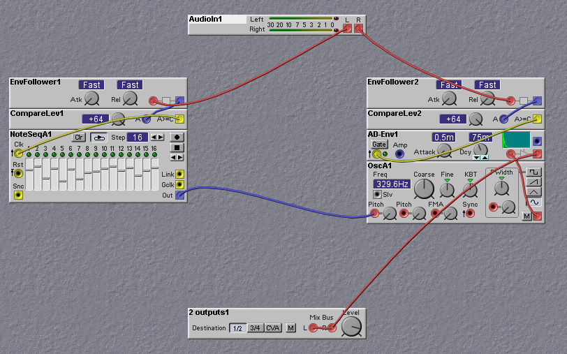

hmmm... another thing i can't really work out. I managed to recreate that patch above, but can't use it untill i get a trigger to midi converter. How would I go about using the two audio inputs instead of midi. Is there a module that essentially converts audio to a midi key or velocity information?
I tried routing an AudioIn to an ADSR-Env (tried both gate input and amp input) but not really getting the result I want. Basicly I would like the audio to trigger the envelope, but not stop when the audio stops, only restart the envelope when i hit the drum...
any ideas?

i used it with piezo straight into the audio-in (after a preamp of any sort)
but because you want to use more then 2 triggersignals you would have to differ the signal of for example the bass and snare and filter those out into 2 signals.
patch is not exactly the same, in the vid i actually used 2 micros.
in added patch the left signal will skip through the steps and the right will start the envelope of 3 oscs.
you need to pre-amp the piezosignal before the nord, so run it through a mixer and pan them out or something. allso taking out the low-end is recommended and watch out for feedback.

Thanks a bunch mate. it was mainly those first two modules after the audio input i couldn't figure out.
Thanks to you guys I'm getting very close to simulating my simmons sds3..
