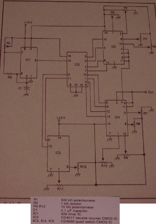

Old Vintage wave shaper schematic from 1984

Check out this old skool wave shaper schematic i found in an old book i got from the library. Dont know if it's against forum rules to post this but i thought you guys might like to see it.
Hardly any parts, 11 pots, and a couple ics.
I havent tested it yet, but i cant wait to try it out.
"...program thousands of wave forms... it will step through the pots at a rate set by R1 which controls the frequency of the 555. If you change C1 to a 1 uf or 5 uf electrolytic cap you can use it as a ten step sequencer...."
-Music synthesizers by Delton Horn, 1984

It's essentially a Baby10 with unnecessary analog switches at each step.
btw, the schematic is incomplete. A dot is missing connecting pin 4 of IC4 to "Out" and the outputs from IC5 (pins 2 & 9) are completely missing.

If it's Delton T. Horn's brown coloured book on synthesizers, I still have it (for some reason. Razz ).
I heard on the rec.music.synth newsgroup many a year ago, that that book of his at least is FULL of errors. I haven't ever built anything from it, because of that.

dang, bummer to know that it's full errors, alot of the schematics look pretty tasty. It's a good read though lots of interesting ideas.
I did notice its almost exactly like a baby 10- But probably clocked at a super duper fast speed to create one wave pulse.
I dont know if i'll be able to bread board it if theres tons of errors. Bummer
