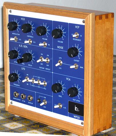

Hello everybody,
I just finished my first DIY synth: the WP20, an old synth project (back in the 80's) from Ray Wilson...
I'm so happy with the result that I wanted to share a picture with you DIY synth builders.
Here's a picture, bye...

PostPosted: Mon May 16, 2005 2:32 am    Post subject: Reply with quote  Mark this post and the followings unread
HEY! It looks great! Those knobs look like those early 80s Roland rack gear knobbies? Shocked Very Happy

PostPosted: Mon May 16, 2005 2:42 am    Post subject: Reply with quote  Mark this post and the followings unread
congratulazioni Exclamation how big is that box Question

PostPosted: Mon May 16, 2005 3:05 am    Post subject: Reply with quote  Mark this post and the followings unread
Thank you very much elektro80!
ehm, I don't know about those knobs... they were just the cheapest knobs I've found around Embarassed Very Happy
seraph wrote:
congratulazioni ! how big is that box ?
grazie dei complimenti seraph!!!
the box is about 26cm x 26cm x 9cm wooden frame included... it is an electro-harmonix pedal case for a deluxe memory man analog delay.
the pedal was stolen Crying or Very sad so the box became useless. I was about to build a brand new wooden box for my WP20 when this lonely box came to my mind... Smile

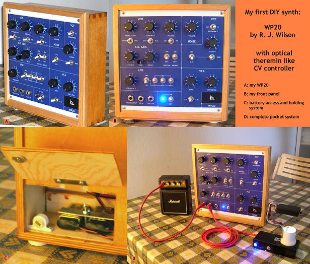

here's a complete mini-set of pictures of my project (if it would be too heavy for this forum, please remove the picture and forgive me Smile)...

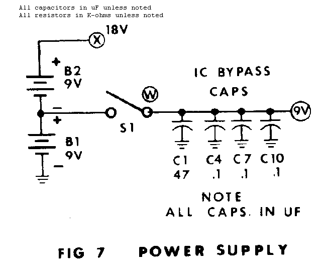

PostPosted: Sat Aug 20, 2005 3:55 am    Post subject: Reply with quote  Mark this post and the followings unread
Is it possible to mod the WP-20 so it runs on +/- 9 V instead of +9/+18 V? Confused

PostPosted: Sat Aug 20, 2005 4:47 am    Post subject: Reply with quote  Mark this post and the followings unread
it looks like it runs on two 9V batteries
the batteries are connected in series so in the other end you get (9V+9V) 18V and from the middle you get 9V
daniel

Pehr
Joined: Aug 14, 2005
Posts: 1307
Location: Björkvik, Sweden
PostPosted: Sat Aug 20, 2005 5:23 am    Post subject: Reply with quote  Mark this post and the followings unread
yes I know, but I wonder if its possible to run on the same power supply as the SL I'm going to build... Confused

PostPosted: Sat Aug 20, 2005 5:39 am    Post subject: Reply with quote  Mark this post and the followings unread
sorry i did´t understand the question in the first place Confused
hmm.. maybe someone knows better but it seems to me that only the noise source is using the 18V all other circuits run on +9V so maybe if you replace the noise source for Ray's "Pink Enough For Me" Noise Generator and you get the sort of pink noise as bonus.

PostPosted: Fri Aug 26, 2005 3:37 pm    Post subject: Reply with quote  Mark this post and the followings unread
Lorenzo -
Thanks for the input. All information is useful, at this level.
18V?
Blast. I thought it was regular +/- 9V. I hereby declare interest in the above predicament. Mine eats batteries, making it hard(er) to keep in tune. Not to mention the AR loosing sustain (Going instead for an occasional early decay) after an hour of play. I could do well with a power supply, and have started building one, albeit it might seem I didn't do my homework prior to buying parts.

PostPosted: Sun May 28, 2006 6:09 am    Post subject: Reply with quote  Mark this post and the followings unread
I think you could use a dual -9/+9 Volts if you separate the transformers ground and the ouputs ground, then you can wire the -9V as ground, 0V as +9V ,and +9V as +18V.
Please tell me if I'm wrong!

PostPosted: Sun May 28, 2006 10:20 am    Post subject: Reply with quote  Mark this post and the followings unread
all you need is a regular [no need for a CT] power transformer rated at around 22-25 VAC, rectify and regulate that with a 7818, then regulate that with a 7809. they are really cheap. oh but yeah, -9 and +9 in series is obviously 18 from -9, just like batteries Very Happy
