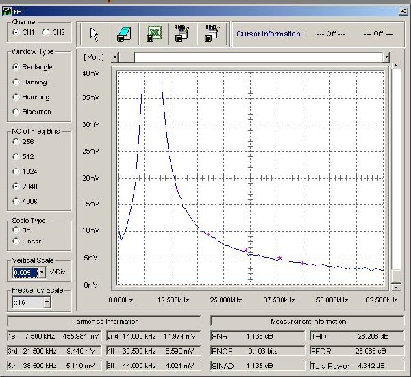

I have included a JPG showing the harmonic content of the sine
output using just regular PNP transistors.
You can easily hear it here. Thanks for the pic.
