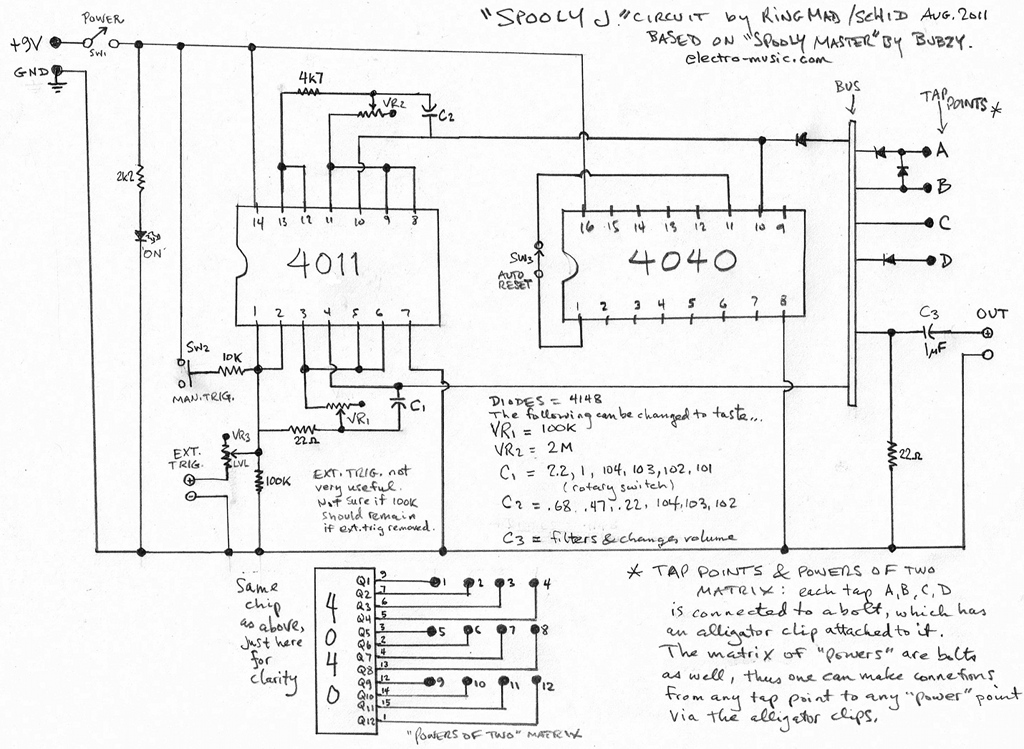

yeah i know, ive got no imagination with circuit names Very Happy
Edit : R4 in the schematic is 1m but i say in the audio that its 100k. it is 100k on my circuit but i guess it wouldnt really matter what the value is Very Happy

Thanks for sharing this circuit! I like it a lot! Crazy sounds. I've experimented with pot values and cap values, and there's some interesting stuff. Changing which pins to use on the 4040 gives different stuff too. I'm thinking of putting it in a box.
Since they all have the same pin configuration, I blindly tried swapping the 4011 for a 4070 XOR, 4071 OR, 4077 XNOR and 4081 AND, but none of them produced anything. Maybe I messed something up.
You didn't mess anything up; you just used the wrong chips Laughing
The 4011 NANDs, which are incorrectly drawn as NORs, are configured as oscillators. A 4070 XOR output will be 0 if both inputs are the same, so in this circuit it won't oscillate. Similarly -- or rather, inversely -- a 4077 XNOR output will be 1 if both inputs are the same, so that won't oscillate here either. The 4071 OR and 4081 AND don't invert, so those will not oscillate.
If you had tried a 4001 NOR it would've worked.

they are incorrectly drawn as i just changed the schematic from some 4001's and changed the text on the chip Very Happy
i put it down to unadulterated ignorance.

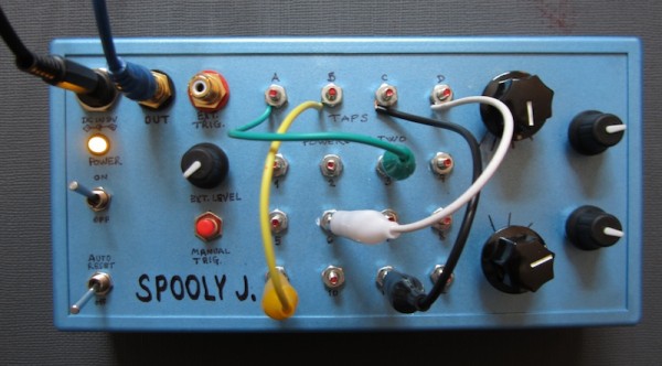

OK, I've been working on this box since July and finally finished it. And now I see the Yum Yum Box also based on this crazy great circuit! Originally called the "Spooly J. Master" then shortened to "Spooly J" (partly because the enclosure I went with was a bit cramped for all the panel stuff).
The way I came up with to make this very flexible was to have 4 tap points and a matrix of terminals, each one connected to a different Q output of the 4040. Sounds like a recipe for chip-frying with static!
Also, the box is sensitive to flesh on the left side... i.e. moving your hand near it can change the sound!
Thanks again to Bubzy for sharing this cool circuit!

RingMad, this is fantastic! Great crazy sounds!
I don't understand what you mean. What are the 4 tap points? How you wire that?

welcome micheline to electro-music.com
Posts: 404
PostPosted: Wed Sep 28, 2011 6:26 pm    Post subject: Reply with quote  Mark this post and the followings unread
Thanks and welcome to the forum!
OK, maybe I should draw a schematic of what I built, but I'm leaving town a few days, so it will have to wait. In the meantime, perhaps I can explain referring to Bubzy's schematic...
Firstly, the matrix of "Powers of Two" terminals (bolts) are numbered 1 through 12, and they are wired directly to the corresponding Q output pins of the 4040. e.g. terminal 1 is wired to Q1, terminal 3 is wired to Q3, etc..
Now, on the schematic... see the wire between pin 9 of the 4040 and the anode of D2? Well, instead of connecting it to pin 9, I connect it to my tap point "D" terminal. Now, with the alligator clip on that terminal, I can make the same connection as in the schematic (i.e to pin 9, which is Q1) by clipping it onto the "1" terminal. Or, I could connect it to any of the other Q outputs, thus making it more flexible.
HTH

PostPosted: Wed Sep 28, 2011 8:09 pm    Post subject: Reply with quote  Mark this post and the followings unread
Hi! Thanks for the welcoming ! This is a great forum. Sorry, I should have said hello before posting, I was too excited by that Spooly Master !
Thanks RingMad for taking the time to explain it. I'm not sure though about the "D" Terminal. If you don't mind drawing a schematic, I'll be more than happy. If you don't, I'll come back with some questions...
Many thanks!
Micheline
Posts: 404
PostPosted: Thu Sep 29, 2011 4:45 am    Post subject: Reply with quote  Mark this post and the followings unread
Look at the photo of my box above... one of the terminals (bolts) is labelled "D". I'll draw a schematic when I get back next week....
J.
Posts: 404
PostPosted: Tue Oct 04, 2011 3:01 pm    Post subject: Reply with quote  Mark this post and the followings unread
OK, here's the schematic. I still haven't gotten the hang of Eagle, so it's easier for me to draw it by hand... enjoy.
