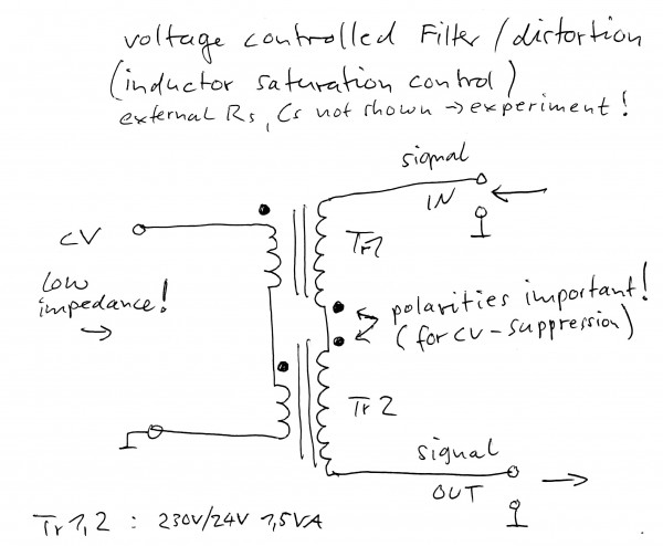

PostPosted: Mon Aug 27, 2012 5:03 am    Post subject: Reply with quote  Mark this post and the followings unread
Uncle Krunkus is right : we talk about "Henrys" for filters in the audio range. All Ls you can see on the posted picture and what you can savage from todays electronic waste is uH or best case mH - forget it....but : small 50/60Hz transformers eg from (older) wallplug PS show "Henrys" on the primary side. They also have a remarkable winding capacitance, so the have resonance frequencies in the range of 1k..20kHz without additional components ! Paralleling C's brings them down to the base range. Secondary windings are also useful: a DC current can drive the iron core towards saturation. This will reduce primary inductance and rise res.freq. and also cause signal distortion.
I attached a circuit that I started experimenting with years ago. Try different transformers ( 1..2.5VA range) and add Rs (series) and Cs (to GND) to bend frequency response. BTW : CV input is not CMOS compatible; needs low impedance drive (small power amp or lab power supply for DC control)
 Filesize:  226.42 KB
 Viewed:  335 Time(s)
