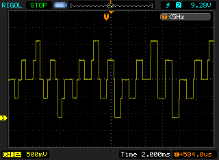

I was looking for alternatives to the pattern generation of the NibbleBeat circuit and thought about a similar trick as in the Wheel of Fortune circuit. Instead of clocking the counters that generate the rhythm pattern just once, why not clock it multiple times within a very brief period?
So in this version I am generation a short pulse with U1B of about 1.2 ms. This is the time it takes to load C1 to the level recognized by the Schmitt-Trigger as HIGH. During that time a second oscillator U1A is enabled and sends a burst of about 1 to 15 short pulses to counter U2B (see scope screenshot). This way the counter advances by multiple steps each time. I call this my "jump counter" circuit. The second counter U3A is again coupled via Q0 of the first counter.
Of course, if the number of clocks in the burst is even or a power of two, the pattern becomes rather simple. This happens around 25 seconds into the recording. The best patterns come from odd numbers, and even better, primes like 3,5,7,11, and 13. 15 steps would effectively run the counter backwards. I found that four LEDs driven by the outputs of counter U2B help to see the pattern increments.
In this version I also changed the diode-resistor logic to normal gates, using only NANDs. Actually, any combination of AND, NAND, OR, XOR gates could be used. An AND stage followed by an OR stage sounds best, and two levels of NAND is equivalent to AND-OR stages. The second screenshot shows an example waveform of the circuit output.
The recording doesn't change pattern tempo nor oscillator tuning this time. It works just like in version one. I start with 7 clocks per pattern step, then tune it down to one step. At the end I increase to a constant high step count and play with the reset button for counter U3A a few times. Again, no effects added, this was recorded straight to my laptop.
